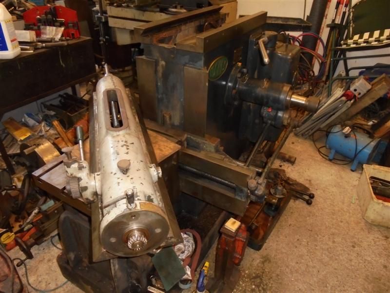

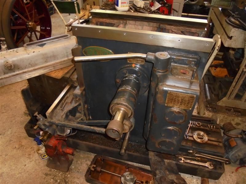

I've finally got the Edgwick shaper into the workshop, what started as a quick clean up , oil change and "get going",
has escalated into almost a major overhaul !
The ram has a few score marks on the slides, so I removed it to scrape off any high spots and generally clean it up,
The inside of the main casting was filthy with old oil , water and general crud, so I removed the "slide arm" from the crank, so I could have better access to clean the innards,
I removed the "crusty" old v-belts that need replacing. Spinning the main drive shaft it was obvious the bearings were noisy,
So removed the main shaft assembly and removed the bearings, one wasn't too bad but the other was very "rattley", so I've ordered two new bearings, a set of 4 new v-belts, and a new chain for the oil pump drive,(should be here next week ).
There are two levers for the gear change, each has three positions located by a detent mechanism, one of the detents was siezed up and would not hold the gear lever in position, so off came the gearbox cover to sort that out,
Good job I did ................. as the gearbox had about 1 1/2" of oil, water and crud in the bottom.
I think the whole job will be very worthwhile, and make a nice machine when finished, ( a properly made English machine, made by Alfred Herbert of Coventry ),1950s or 1960s it's a pleasure to work on it.
Here are some pictures of things so far...................
