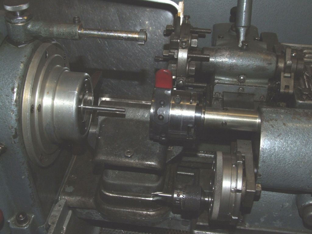

I've only cut a thread on the end of a rod, but it's a start! Here's the set up, 1/4" steel rod (EN3B) in the dead length collet and a 1/2" Coventry diehead in the second tailstock shaft:

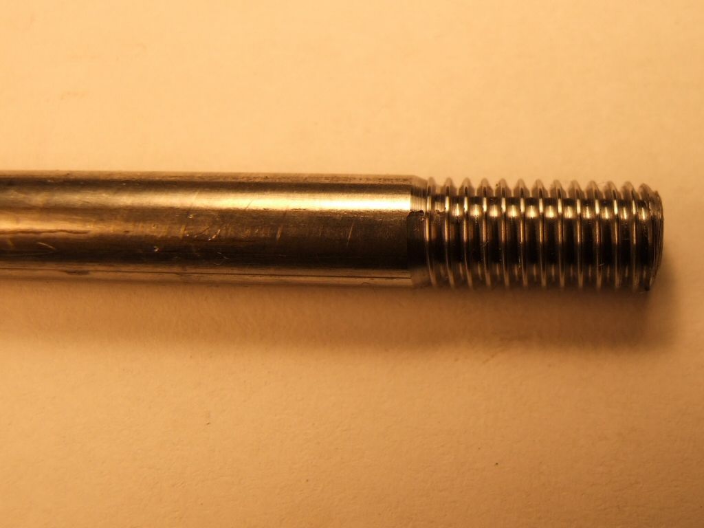

Spindle speed was about 112rpm and the tailstock was hand fed up to the stop, at which point the diehead carries on a bit and then pulls off. I like Coventry dieheads; when they're set up correctly they produce really nice threads:
The thread is 1/4" BSF. Now I can churn out all the studs for my traction engines. It's only a small step, but the journey doesn't begin until you've made the first step.

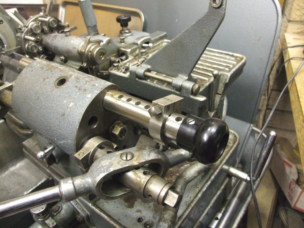

Thanks for the information on knurling. Is this the black knob you mean?
I've got one of them, although presumably it can be moved between shafts, or I could make some more.

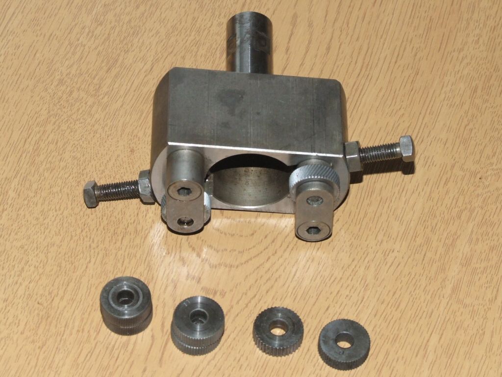

Now onto knurling; here's the knurling tool and a few spare knurls:
It's unfortunate that a couple of the knurls seem to be singles, but that's life. At least knurling wheels are readily available. It seems clear how the knurling tool works, in principle at least. The two screws and nuts at the sides of the tool are used to swing, and set, the diameter of the work for the knurling wheels. However, any practical hints on how to knurl will be most welcome. Presumably the knurl wheels are set to form the knurl in one pass? I assume that some experimentation is required?
