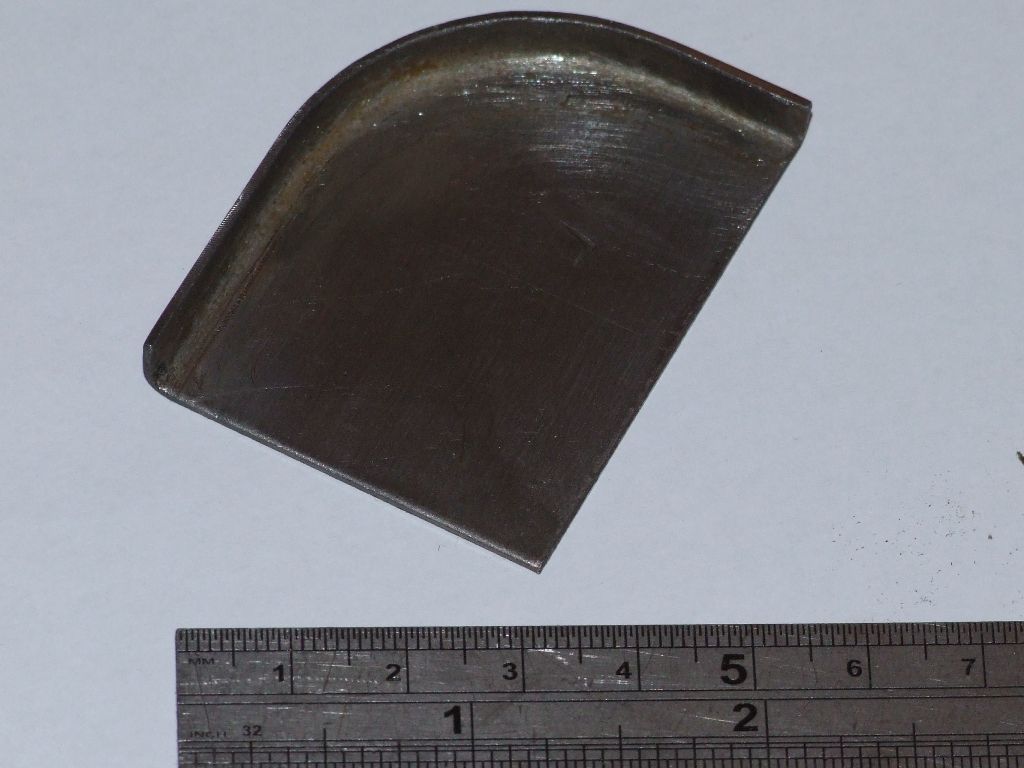

Just to be clear I formed my plates while the metal was red hot. Presumably by heating the brass this evening and hammering tomorrow the heating was only intended to anneal the brass?
Personally I'd use steel for the tender sides. Much cheaper and better behaved when forming. This is an oiler tray made from 1mm cold rolled sheet formed hot on the same former as the spectacle plate for convenience:
