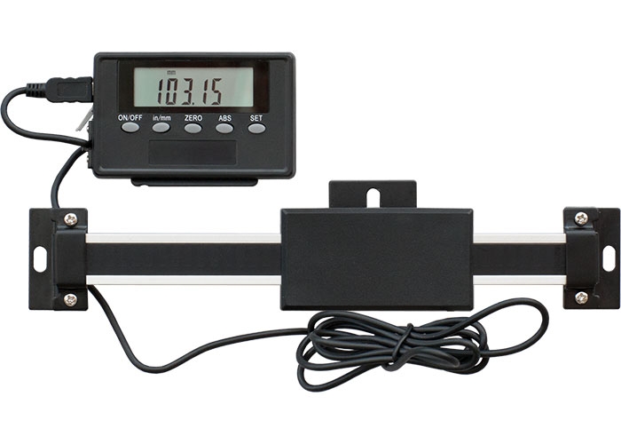

Thread: DRO scales
14/05/2021 13:50:00
Posted by SillyOldDuffer on 13/05/2021 18:01:36:
Posted by Bo'sun on 13/05/2021 17:46:37:
Thank you George, the link takes me to ARC, but it doesn't work. When I search "DRO scale" the only DRO scale seems to be a vertical one. Is that what you have?
Looks like George's link got mangled. I think he meant these, which I have too.
Although not coolant-proof they work well enough. The separate readouts are mildly inconvenient and don't do any of the clever stuff like PCD but they're streets ahead of dials.
Thanks Dave, exactly what I was trying to link to.
George.

13/05/2021 17:38:49
I have a set of these fitted on my mill; not had any probs with them since fitting over 6 years ago, batteries last quite well too, worth considering.
**LINK**
George.
