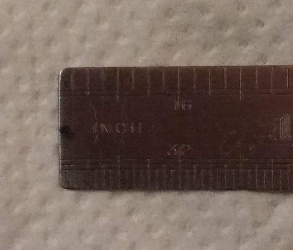

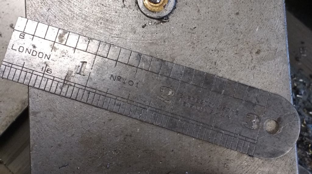

My "pet peeve" with rules are rounded ends, happens when they are carried around in a pocket. Not sure what it is about it that peeves me but it does.img_20190407_082206469.jpg
This rule I find very useful around machinery, particularly the lathe. Wish I could find a metric version.

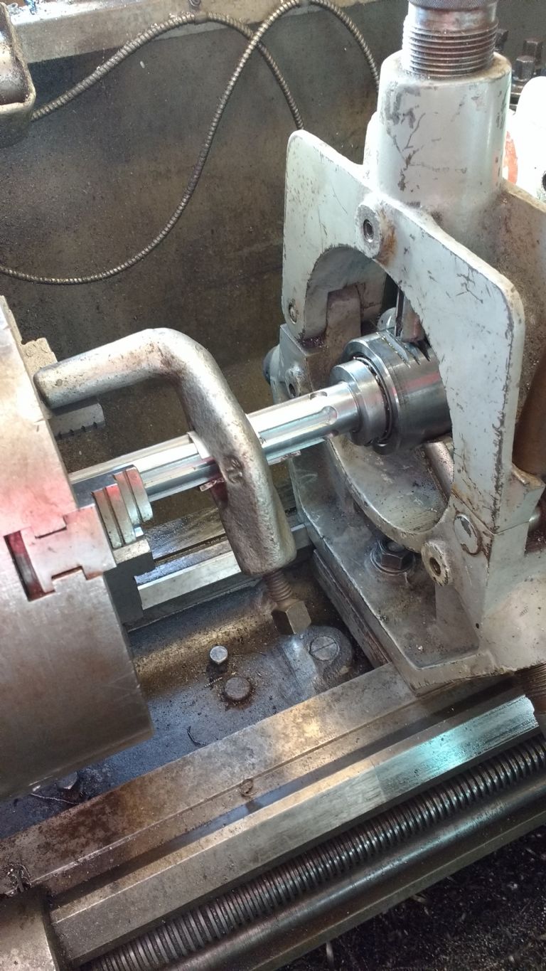

A few years ago i was given most of a horizontal mill, I have the space for it so rather than see it go to the scrappy I gave it a home. The intention was to convert it in to a surface grinder, but after some thought a second mill would be far more useful, particularly a another vertical.
Eventually I acquired a suitable head to adapt to fit the machine, specifically one from a Chinese lathe/mill. This had a 3MT taper, I need 4MT so the tooling is interchangeable with the other mill, so made a new spindle with a 4MT.
But how to get the taper running absolutely true? I've done this in the past by finishing the taper on the mill by angling the head over at the right angle with a boring bar clamped vertical on the table , that is to say finishing the spindle off its own bearings.
Problem is that the head does not have the tilting facility. The attached photos show how I did the job. I borrowed a second fixed stead so I could "clamp" the quill to the lathe bed and used a cranked carrier to drive the spindle, (from a chuck jaw). I was pleasantly surprised at the rigidity of the setup.
