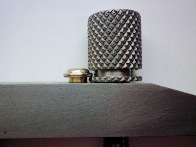

Thread: Ideas on how to form the joggle plate for a small tool makers clamp
29/09/2022 15:17:57
There are of course alternative ways of making the screw captive, not better, just different.
Anyone contemplating making toolmakers clamps my *** webpage *** might help. Harold Hall's website has plenty of useful information on toolmakers clamps complete with drawings, suggested sizes and different styles, well worth a look: Workshop Projects - Toolmakers Clamps.
