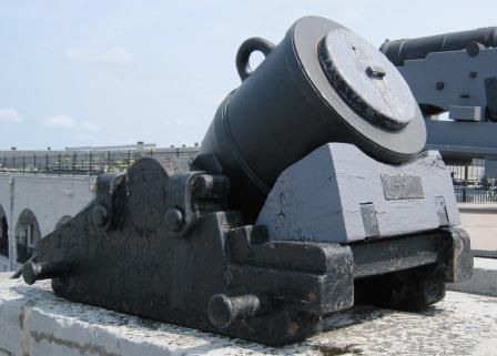

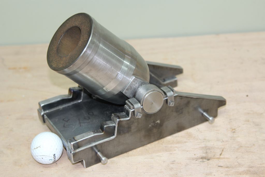

I got the picture from a google search I think it is Fort Henry in Ontario. I have actually only seen these mortars twice. One was in the army museum in Lisbon and one in Guernsey. The drawings I made were from scaling various photos from google. There are so many different variations of the same piece that its difficult to make an exact scale model unless you visit one with a tape measure. That's why the grey block looks different as I would have copied that from a different picture.

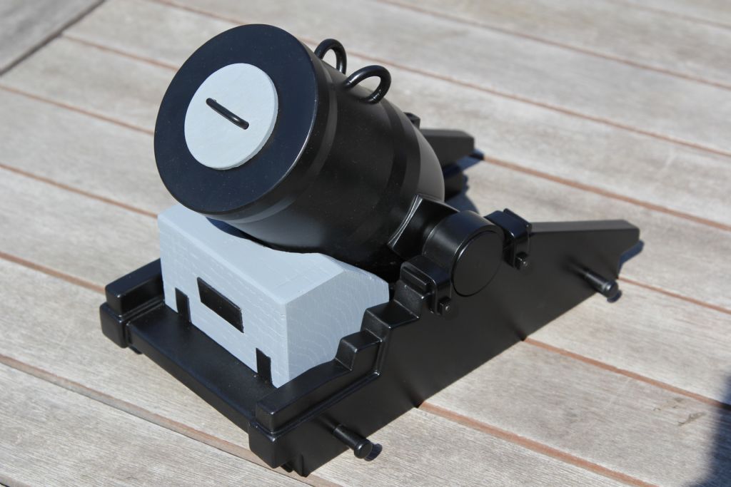

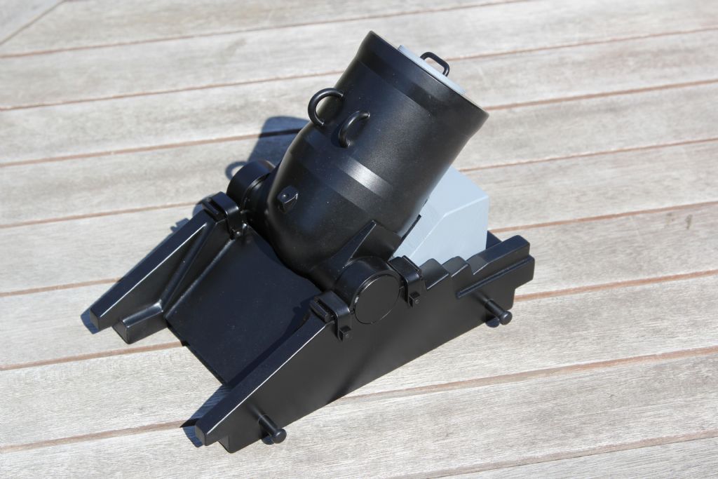

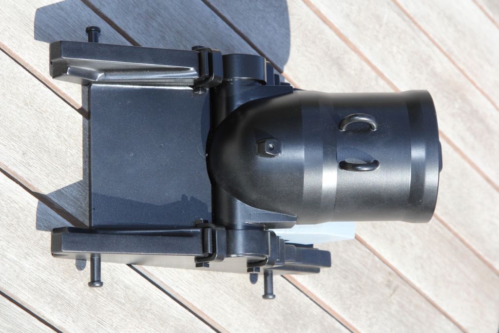

An update on the mortar, its now finished so I have uploaded a few photos. I hope you like it!
Next will hopefully be a Victorian Rifled Muzzle Loader on a pivoting carriage.

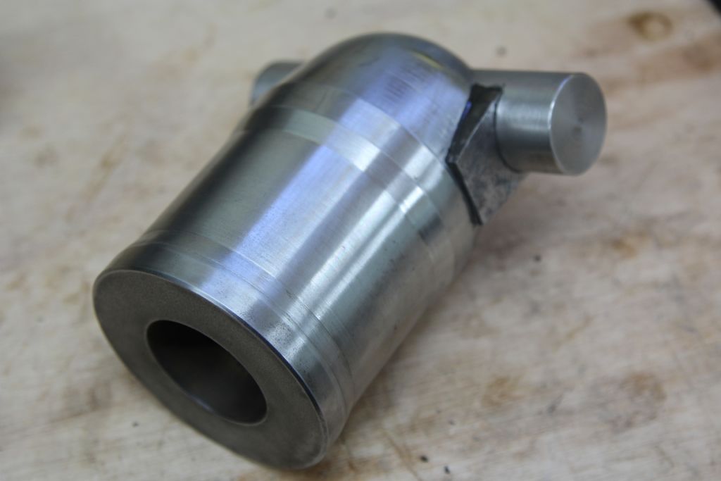

How will he clean up the bit of barrel between the trunnions and get it as nice as the turned bits at either end?
Rch

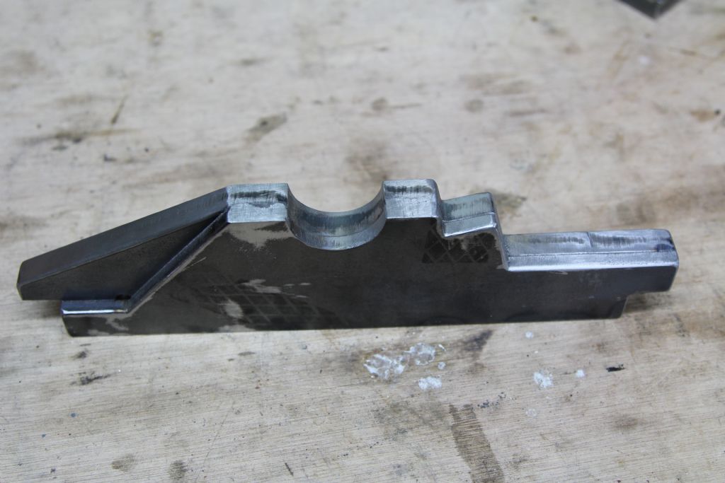

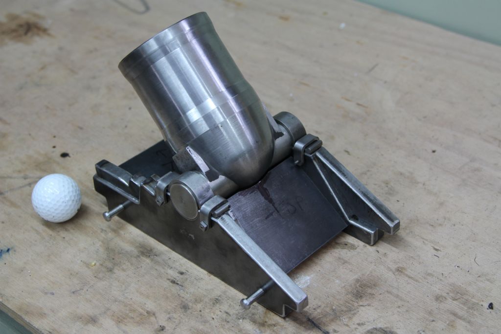

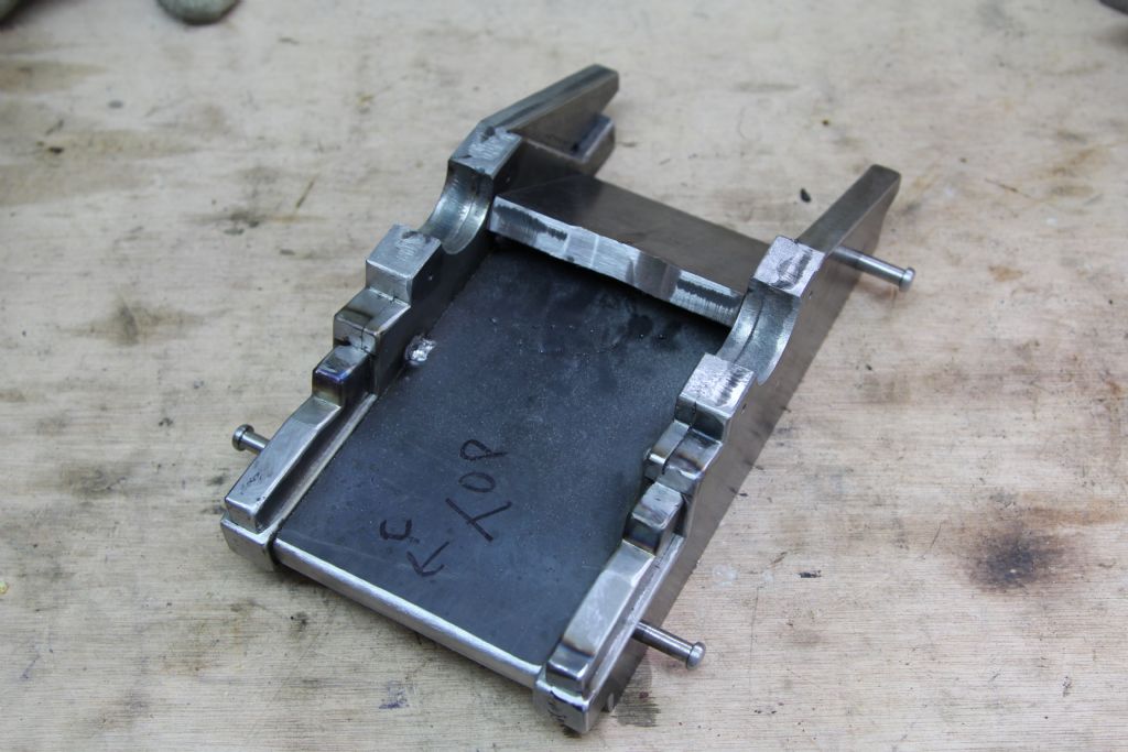

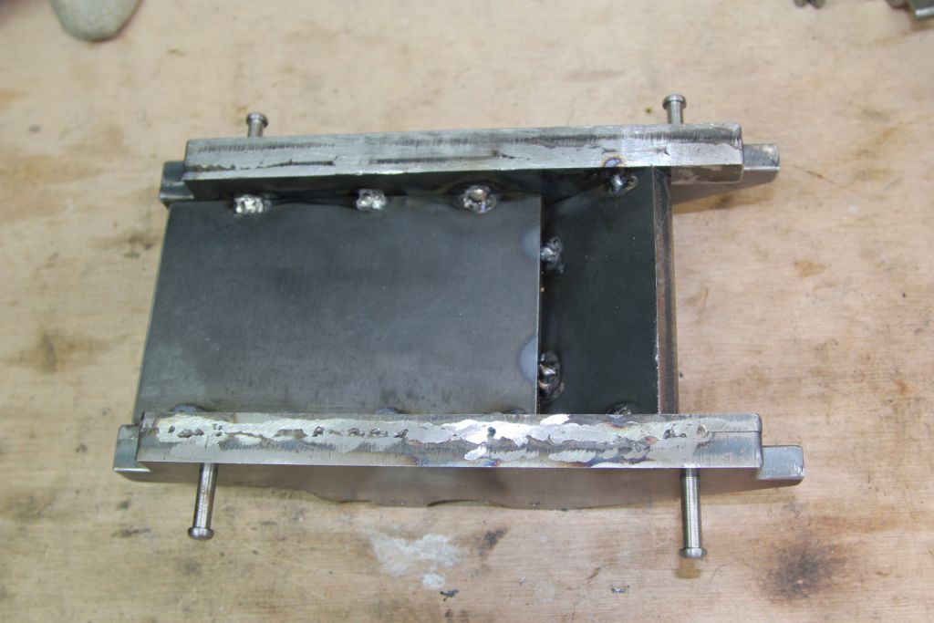

The bed was drawn on autocad and is made of 8 pieces of steel. I then sent the files to Malcolm at ME Laser who cut them for me. I then tig welded it all together. It was the only way I could think of other than screwing them together which seemed a lot more work. As I was painting this model black I was not too concerned about using welds.
The fillets were a real pain in the bum. As you know they have curves in awkward directions and seemed to me to be impossible to machine so I filed them. I first bored the hole for the trunnion into the fillet. I then pushed blutac onto the barrel and made a blutac filet. After carefully taking this off it gave me the shape I needed to file. It was very tricky but I did get a half decent fit in the end. They were then attached with an epoxy metal from b and q and a small amount was needed to fill some small gaps. I doubt this would be any good for you though as you are probably not intending to paint your brass model but I am going to paint mine.
If you do find a way let me know, I can only think of casting a complete barrel but thats not much help.
