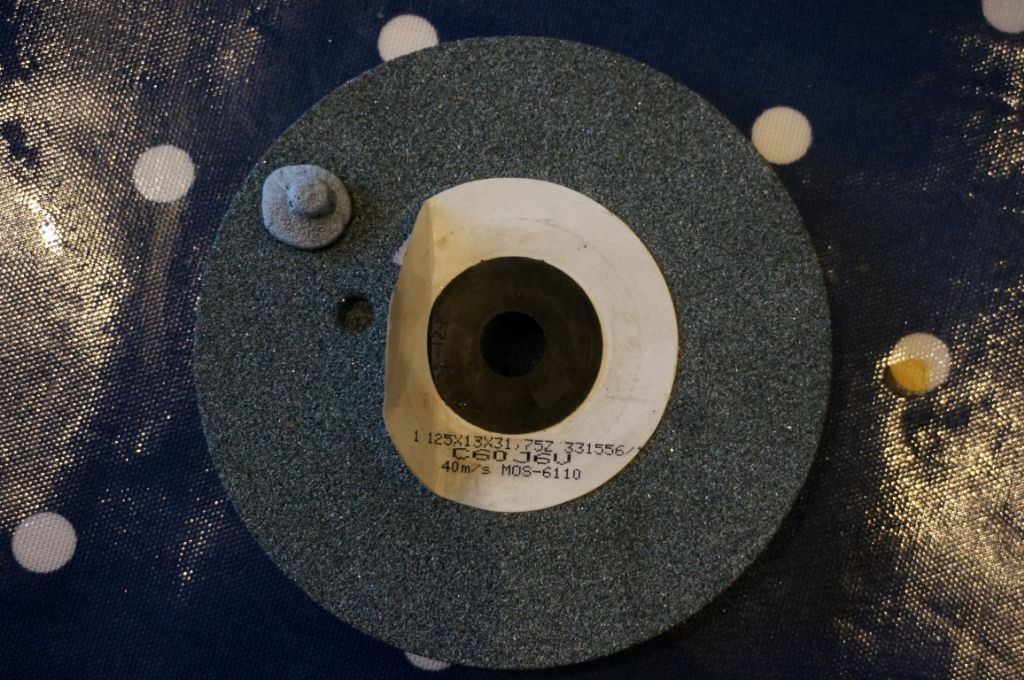

Just had this in from Chronos
Hello
Thank you for the email, the hole is a result of the manufacturing process and it won't affect the performance.
Regards
Matt
Chronos
23/03/2016 08:32:12
Some more photos and a blu tack impression of the holes
And the label which if its not clear is
1 125x13x31.75z 331556/ indistinct
C60 J6U
40 m/s mos-6110
Supplier was chronus so hopefully they will respond to my email pictures todaydsc00941 (medium).jpg

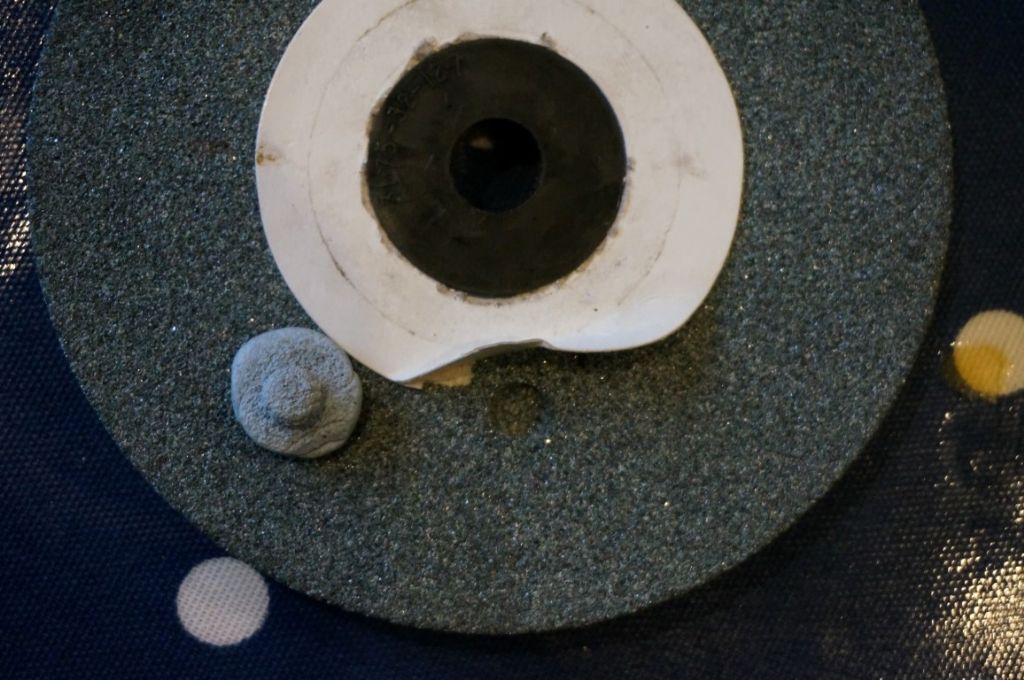

22/03/2016 20:49:43
Right
I pulled it off to investigate more and its definitely not cracked it rings as a stone should
But theres another hole on the other side
these are nice clearly made holes 8mm dia perfectly round and flat bottomed 5mm deep
ones at 12 o clock and the others at 4 o clock on the other side
these are put in during manufacture
its a 125mm 13mm wide wheel and they are 32mm and 35 from the centre

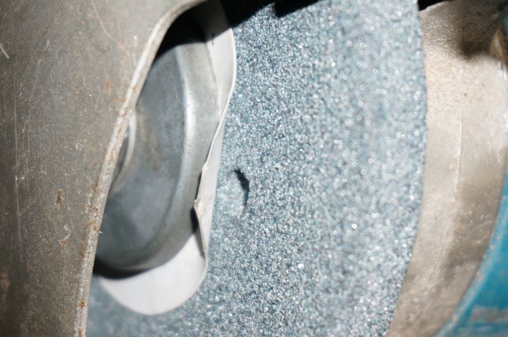

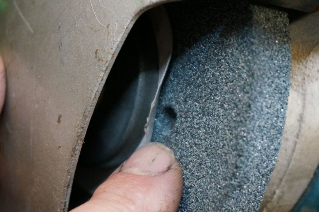

I bought a grren grit grinding wheel for a small grinder I had
after mounting it the blotter flapped out slightly showing a hole
is this ok? looks cast in
I've never seen a hole before on a stone
