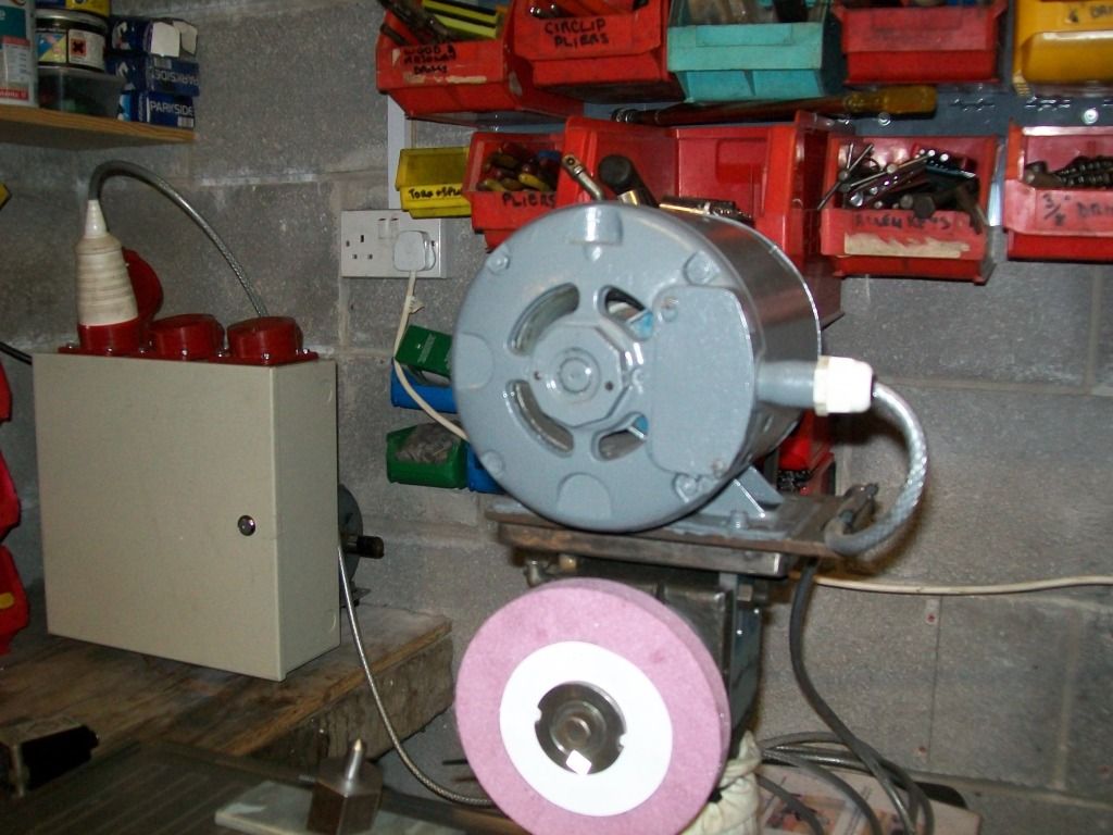

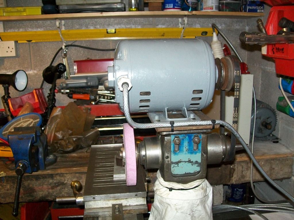

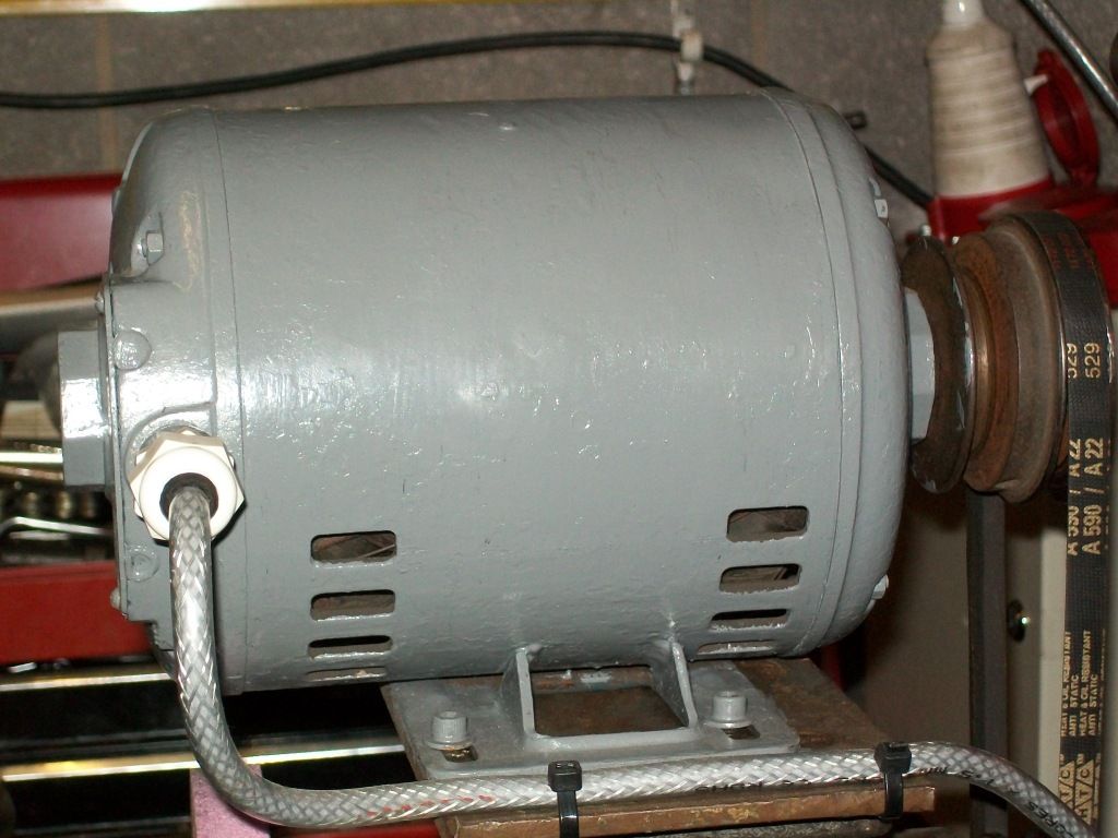

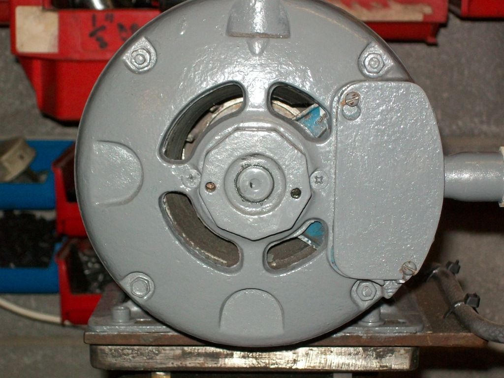

Thank you gentlemen some very good food for thought.
Some more information:
Dimensions:
Length bell to bell 10"
Diameter 6-3/8"
Shaft Diameter 5/8"
Running (unloaded) RPM 2970 (difficult to load up as it's a T&C grinder)
Voltages:
L1 - L2 = 250v
L2 - L3 = 230v
L1 - L3 = 240v
Voltage mismatch is down to the homebrew 2HP RPC it is running from.
Amperages:
L1 = 1.5
L2 = 1.1
L3 = 0.7
Above measurements taken with motor running @ 28 degrees C
And as they say a picture paints a thousand words....
Thats a 6" wheel in the pics.
Paul
11/09/2012 01:53:39
I have a 3 phase motor looks like an older squirrel cage Brooks/Crompton sadly it's missing it's information plate.
What is the most accurate method of calculating it's KW or HP?
The motor is wired Delta and has an across the terminals resistance of 8.2 Ω dividing this by 1.5x gives a single winding resistance of 12.3 Ω.
Using Ohms law my calculations have given me this:
V/R = I. therefore 230v ÷ 12.3 Ω gives 18.6992 Amps (I)
230v x 18.6992 Amps = 4.3 Kw ÷746 = 5.765 HP
Looking at the size of the motor it dosen't seem big enough to be this powerful, but that said it won't run for long on my 2HP RPC before the switch trips out.
Any & all help appreciated.
Paul
