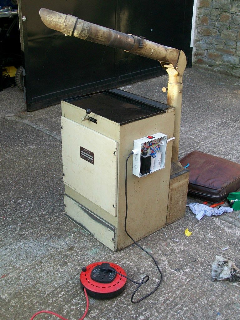

When I bought my old Norton grinder it came with a "Drytex" unit works great though might not suit all as I think they were all three phase, this is mine running from a built in homemade static 2 to 3 phase convertor
