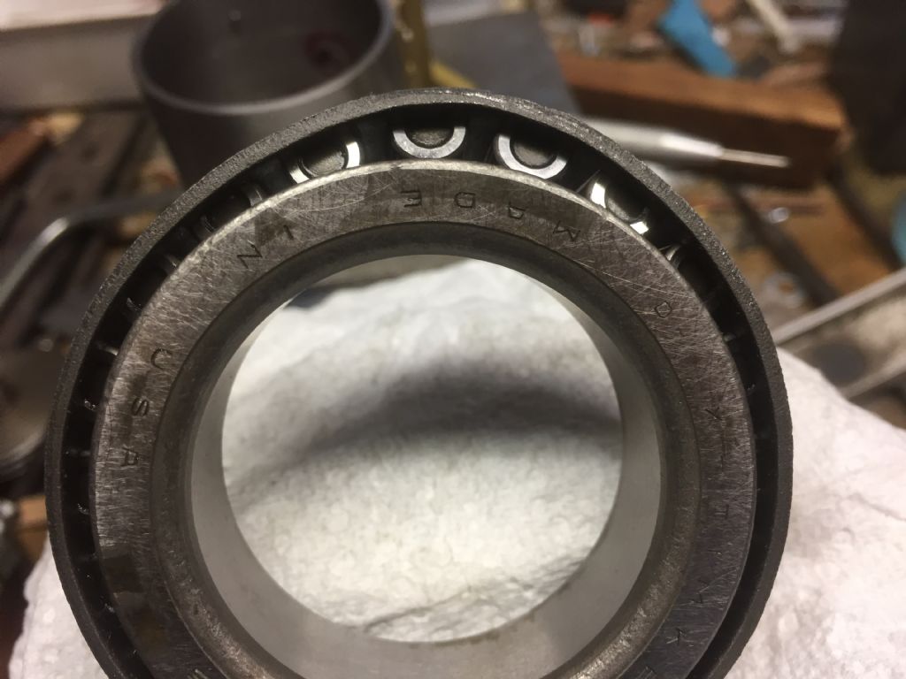

This is the damaged bearing that caused all the trouble. Ignorance resulting in the used of a too small spacer which was pushing against the roller cage.img_1848.jpg

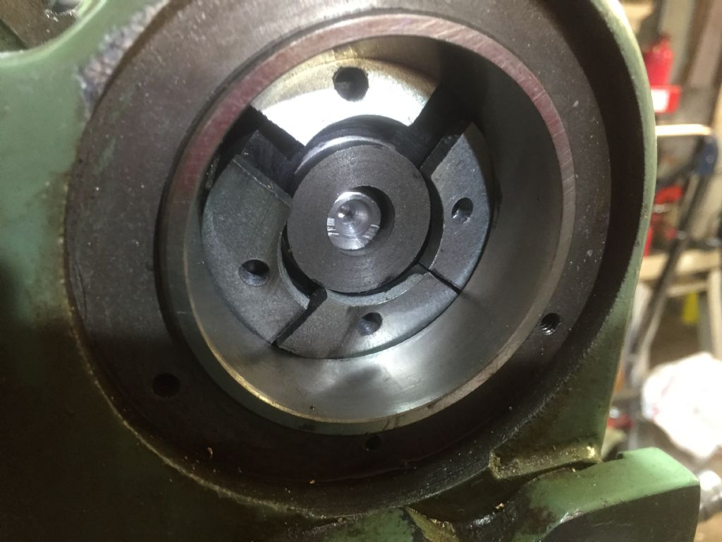

This shows the method, with a wheel spreading the force on the front inside casting. You can see one of the pin punch holes on the left side near the spanner.img_1864.jpg
18/09/2018 11:11:45
I have finished the job and the lathe is back in service. I used a length of 12 mm threaded rod with various diameter lengths of pipe and tubes, some of which had to be cut and faced and one bored. The biggest headache was how to get out the old bearing outer race cones. There are two holes 180 degrees apart in the casting through to the cone seat so a pin punch can be used, but only a 3 mm pin would fit through the holes so I cut the shank of a 3 mm drill and used a 4lb hammer head, with my finger through the handle hole to hit the pin. There was precious little swing room in the spindle cavity, but I managed to get the front cone moving and turned up some longer pins to get it all the way out. The rear cone however was not going to move, especially as the backgear was in danger of being hit with the hammer. I tried to get a gear puller in behind the cone but it couldn't grab. Eventually I tried cutting a big washer into quarters and poking it in behind the cone where it could engage by just a mm or two. I then used a pusher. I thought I would have to screw the segments to the pusher, hence the holes, but friction sufficed, and after a couple of frustrating days trying to come up with a solution, the cone started to move.img_1862.jpg

I promise I won’t be removing it again assuming I can obtain the bearings and get it back together, which I expect to be at least as difficult. Yes, the roller cage was bent. It’s too depressing to take a picture of.

Encouraged by Paul's comments above, and I remember that he has a Hercus himself, I decided to study up and remove the spindle. I watched several utube videos on Southbends, Atlas and finally found one doing a Hercus AR like my ARL, but he was finding his way and working it out as he went, so not a great teacher. Finally this afternoon after two days, I got the spindle out, but destroyed the front taper roller bearing. I used threaded rod and a spacer I made from steel pipe on the other lathe, as shown in some of the videos, but at some point the force must have been against the bearing and it was bent. It is still on the spindle and pushing it off will require another special tool to be made. At this point I really wish I had bought the link belt. It is obvious from the paint across joints that the spindle has never been removed before.
