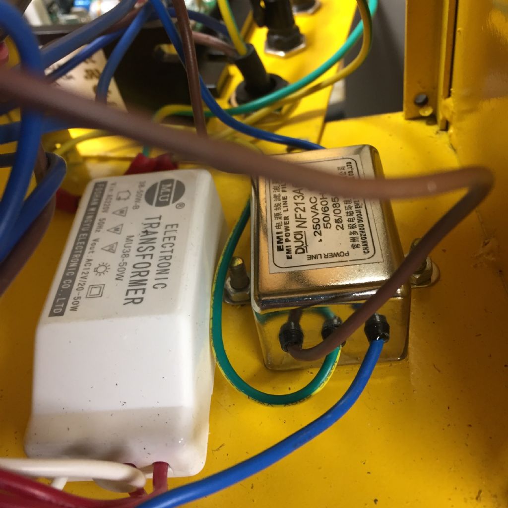

Hi Martin thanks for your posts. The marks on the white transformer were shadows not soot or scorch. I disconnected the supply from the main board to the speed control potentiometer and with the motor still connected switched on and did not trip the speed indicator showed 0000 and did not flicker I left the power on for sometime and nothing happened. Is it possible that the potentiometer could be the fault if so how can it be tested. As you can probably guess I am not particularly electrically savy I can wire a 13a plug and that’s about it. Once again many thanks to you all for your time and trouble to help me out John

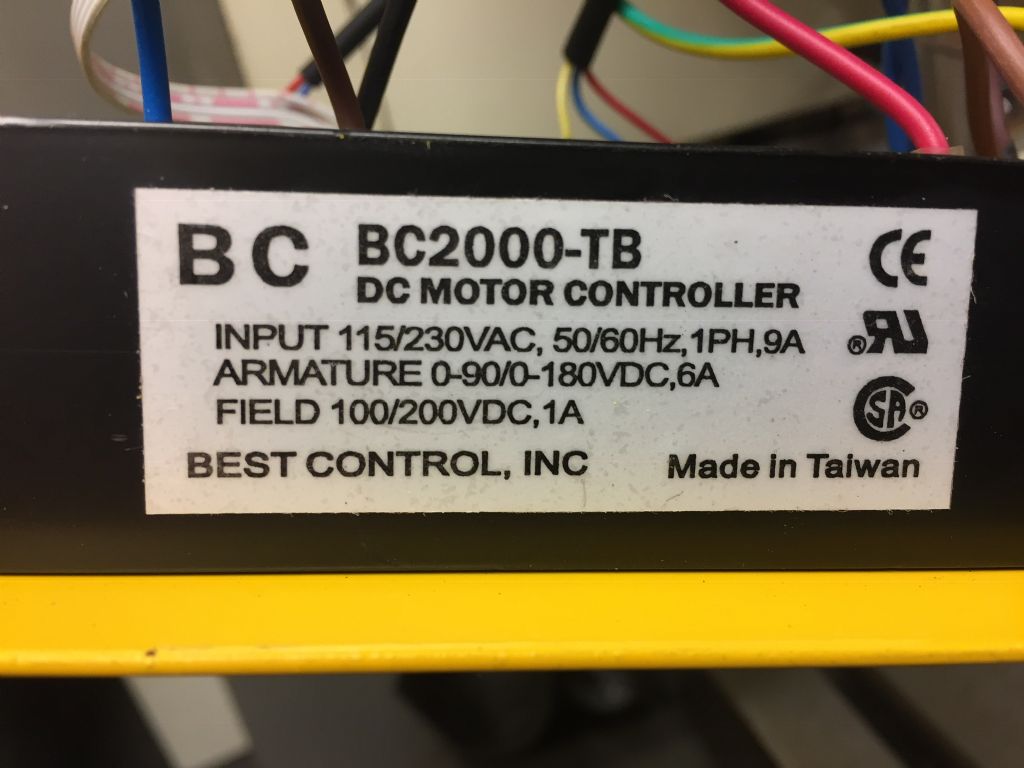

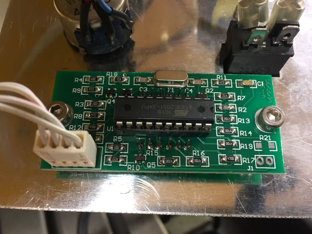

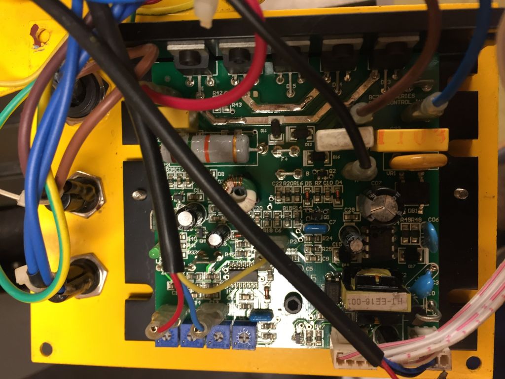

95da7cf5-beb4-4fe8-b49f-e2dda9736af3.jpeg8969e9d4-3be4-49c2-ba90-8f9590222e23.jpeg3040253a-9ba4-436e-ab02-a435c0e28179.jpegHi John steep learning curve photos attachedb9be8083-3324-45d4-86ed-101980f402dd.jpeg

Hi John the plot thickens. I disconnected the motor and connected a 60w lamp switched on the lamp lit the speed indicator hunted with random numbers, I adjusted the speed control and varied the lamp brightness. I reconnected the motor switched on it tripped I then reconnected the lamp it tripped, I will post some pictures as soon as I have worked out how to do it many thanks John

Thanks John the board is a Best BC 2000. I will try the test with the lamp. If it is the pcb can you check for faults that could have caused it to fail.

The mill is 6 years old so out of warranty. I have had a look in the control box and there is nothing obvious. I mailed Chester about service options but it is on a return to base basis they suggested a new board at £94 + vat. I don’t want to buy one without being reasonably certain that it is faulty
