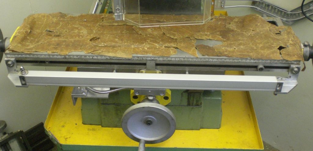

14/04/2023 10:45:22
Hi, I bought my DRO display and two glass scales from ArcEurotrade when they were selling them at a discount price, and I made my own brackets, which I didn't find that difficult, and I wanted to mount my X axis one on the front and still be able to use the stops.
There are more photos DRO's for the Major
Regards Nick.
