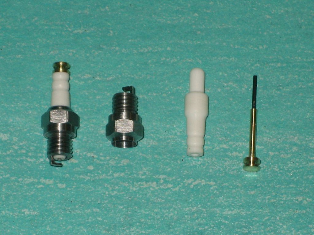

08/10/2010 09:16:03
Hi Andrew,
I was also looking at using Macor for plug insulators - very expensive stuff! Then I read somewhere that Corian (kitchen worktop material - 1/3 acrylic polymer, 2/3 aluminium trihydrate) was also a good insulator material unless you're making plugs for a high performance engine - clearly not a problem on a hit-and-miss. I managed to get half a dozen 2"x5"x1/2" off-cuts from an eBay trader (apparently, it's a popular handle material with knife makers) for a fiver and set about making some M5 plugs for my 2cc 4-stroke. It's quite easy to machine with ordinary HSS tools but it does wear the sharp edge off quite quickly so regular stonings are required. Had a few mishaps along the way - too heavy a cut with a worn tool - which would have been very costly in Macor!
Have (hopefully) attached some photos of the finished article. It's been run for about an hour now at up to 11,400 rpm and seems to be holding up well.
