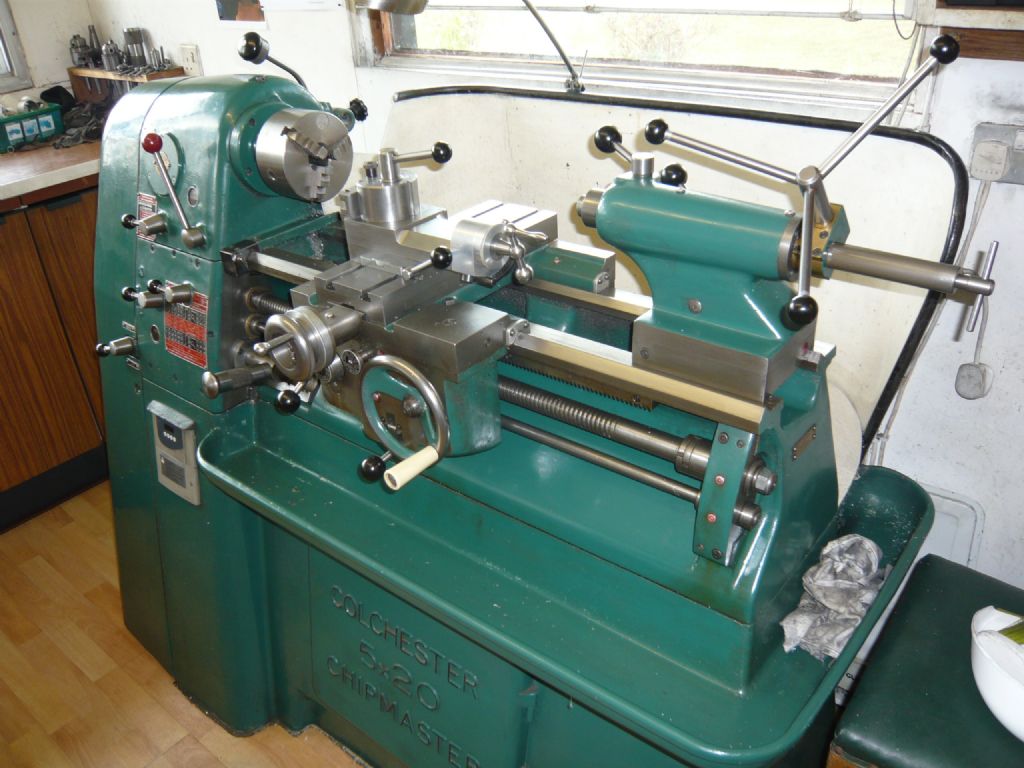

I visited the factory as an apprentice in about 1957, so this video reminds me of that visit. I think the whole factory was very proud of the machines they produced. Here is a photo of my Chipmaster, still going well.
I have rebuilt this old lathe and I think it now runs nearly as good as it ever did. Replaced the speed variator with an inverter, modified the cross slide and added a new lever locking top slide, plus the capstan feed tailstockall cleaned up.jpg
Alan
