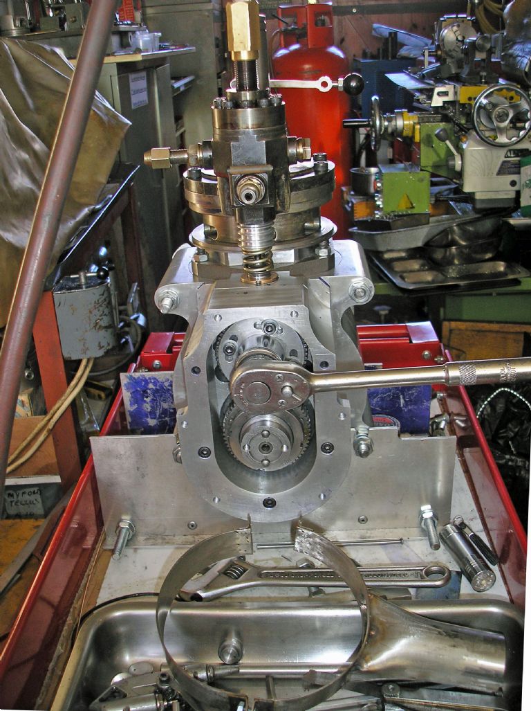

05/01/2020 15:56:32
Had my full size flash steam engine running yesterday on compressed air unfortunately have not got too much pressure and quantity for high rpm so just a pop, pop at low rpm.
Had to retard inlet poppet valve and use compression release valve to enable it to run with my limited compressor also added temporally extra mass to crankshaft for this test a lathe chuck.
Would run on about 90psi with this setup but need a lot more pressure to run on the proper valve settings..

31/12/2019 12:50:24
At long last am at a stage to test run on compressed air.
Unfortunately my compressor does not have capacity and high enough pressure.
Going on my experience with flash steamers will need at a least 150psi and a lot of air my petrol head friend at work has a screw compressor and 150psi so in the New Year will see what happens.
At 120psi it’s so near continually running and a sharp exhaust noise on air.
With high pressure superheated steam could be an interesting noise.
It has a variable compression release valve to ease starting but flattens my air supply.
Will finish welding the exhaust manifold today amongst other jobs.
All the best to you all for 2020.
Air test 1
Engine
Air test
