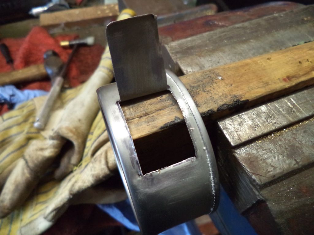

On with the mater in hand, I've tired various blowers and I found the best to be the ones made from 24V ex-military radio cooling vans you could get these quite cheep at one time but with scarcity they are getting expensive. And as is my natural curiosity I've stripped a fair number of blowers down. Then when making myself a lunchtime Tuna sandwich I looked at the empty tin and had the idea of making a blower out of it, I took the empty tin with us when we next went to the supper market looking for a suitable tin to make the inner fan out of to me delight I found that the smaller tins of Tuna they sell would just fit the bill. 24V electric motors are easy to obtain of the net.
A few manufacturing shot
Material
Drilling the base of the fan the vanes were put in with a wood chisel whilst the inside was supported by a lump of wood.
The gap for the exhoust vent
The exhaust with its paper pattern
Soldering the exhaust
Machining the top and bottom plates these were made from 100mm dia ally blanks bought of the net.
Completed blower
And yes it does work I recon at that size it would be fine for smaller 5" gauge and 3 1/2, 2 1/2 locos
If you need a bigger blower you'd just have to find some bigger cans.
Stew
