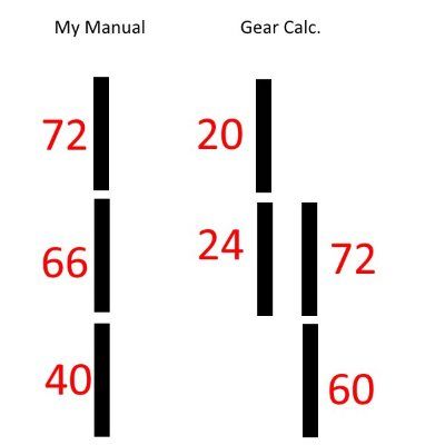

09/06/2016 21:20:55
Posted by Dave Smith the 16th on 09/06/2016 20:11:57:
Michael Cox 1, Not an 8TPI there.
The left hand set is what my manual says i need for a 2mm pitch thread. The right hand set is what the link that you gave shows i need to cut a 2mm thread.
Something not quite right there.
Dave,
If you click on the arrow at the side of the leadscrew box it will give you a long list of both imperial and metric leadscrew pitches so just select the pitch you have which is 2 mm. Where it says target you can input a pitch in mm or a tpi that you want make. You must then click to indicate whether it is tpi or mm oi the box to the right of the target. You can put in 8 as the target and click tpi. Then press search combinations and it will come up with the best combination. To reveal other possible combination then click the drop down button at the side of the results.
You can also add in other gears in the boxes below the row headed my gears, if you have others that are not listed.
If you have a 2 mm pitch leadscrew and you want a to make a 2 mm thread then the final gear ratio required is 1 which is the result given by the gear calculator but not by your manual.
The LatheNovice gear calculator is extremely versatile and I have been using it for a couple of years and it works very well.
Mike

Thread: metric on imperial
09/06/2016 14:10:38
Posted by Timothy Moores on 09/06/2016 11:04:49:
Some other possibilities for imperial/metric translation gears, depending on which gears you may have available (or be willing/able to make) in decreasing levels of accuracy:
47/37 = 1.27027 or 0.021% error (2 tenths of a thou in an inch)
66/52 or 33/26 = 1.269231 or 0.061% error (6 tenths of a thou in an inch)
61/48 = 1.270833 or 0.066% error (6 tenths of a thou in an inch)
The lathe novice program actually 17 different combinations of gears which have a low error.
Mike
09/06/2016 09:17:38
Posted by Dave Smith the 16th on 09/06/2016 01:37:15:
That gear calculator mentioned above comes out differently for my machine.
My metric machine with a 2mm leadscrew.
Picture below on my manuals figures and the figures from the calculator above.
(although i do wonder if my manual is correct, no mention of the high/low gearbox and the motor drives the spindle directly)
Hi Dave,
If your leadscrew is 2 mm pitch and you want to cut an 8tpi thread, which has a pitch of 3.175 mm, then you need to turn the leadscrew by 1.5875 turns for every turn of the spindle. Your first combination (your manual) gives a ratio of 72/40 = 1.8 which is hopelessly out. The second combination (gear calc) gives a ratio of (20/24) x (72/60) = 1 which is also hopelessly out .
If you use the lathe novice calculator that I posted above the best combination is A=50, B=72, C=80, D=35. This gives a ration of (50/72) x (80/35) = 1.5873 which is an error of 0.013%. This is an insignificant error.
Mike
