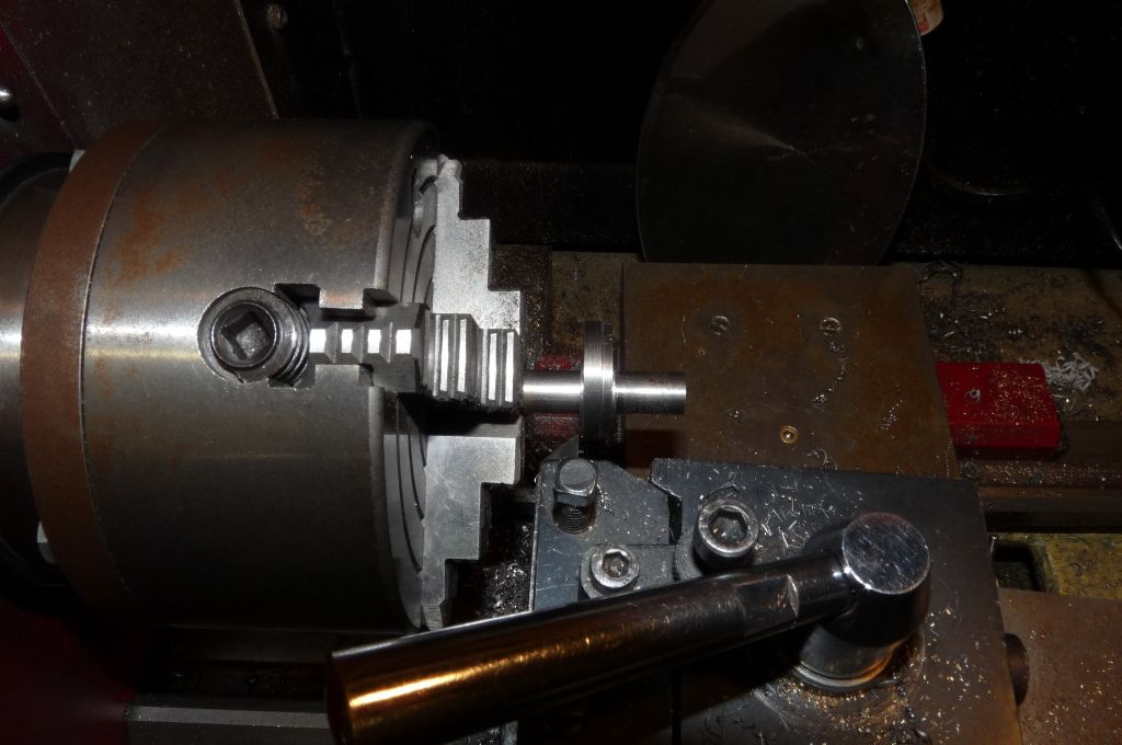

11/07/2015 20:09:50
Made some new studs, a right fiddly job - 7/16" long, 7BA. Only six though, could have been worse. Anyway, the sheave has been finished. Because the finished engine will be fitted with the Stuart governor the sheave has no boss, this makes room on the crankshaft for the governor drive pulley.
The sheave is turned to its outside diameter from a short length of steel bar:
Then I set the eccentric throw:
And then bored the hole for the crankshaft so it's nice fit, then turned the little cheek that acts as a spacer:
Next step is to part off - on the eccentric. This is advice from Harold Hall's build of the Stuart V10, the logic being that the parting tool will break into the crankshaft hole evenly around the circumference. He also strongly recommends the use of a rear parting off tool, which I don't have.
Parting off didn't really cause any evil demons to appear, slow and steady, show no fear...
In order to finish off the machining, I used loctite to fix the half finished sheave onto a short length of bar, here I've already turned the first side if the sheave:
Using the eccentric strap as a gauge to ensure the diameter is correct:
Now the workmanship is exposed:
The sheave is a perfect fit with the strap, nitwit put a very nice slot in the wrong place in the strap...However, it does not matter and only we know . Because the sheave has no boss now to take a grub screw, the grub screw is to be fitted in the centre (ahem) of the sheave. If you think the sheave is looking a bit of a funny colour, it's because the loctite needed getting pretty warm before it would give up.
So that's the sheave done. Next installment will be fitting the cylinder to the table.
Steve
