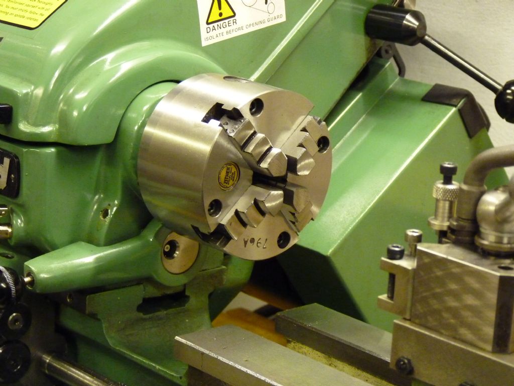

06/01/2015 21:11:29
I was lucky enough to get the Christmas period off this time (first in 8 years or so) and finally managed to fit my new chuck I got for my birthday back in May so I'm a happy bunny now face 1
That's the second time in two years I've been able to finish something, this beginning to be a habit wink 2
Paul

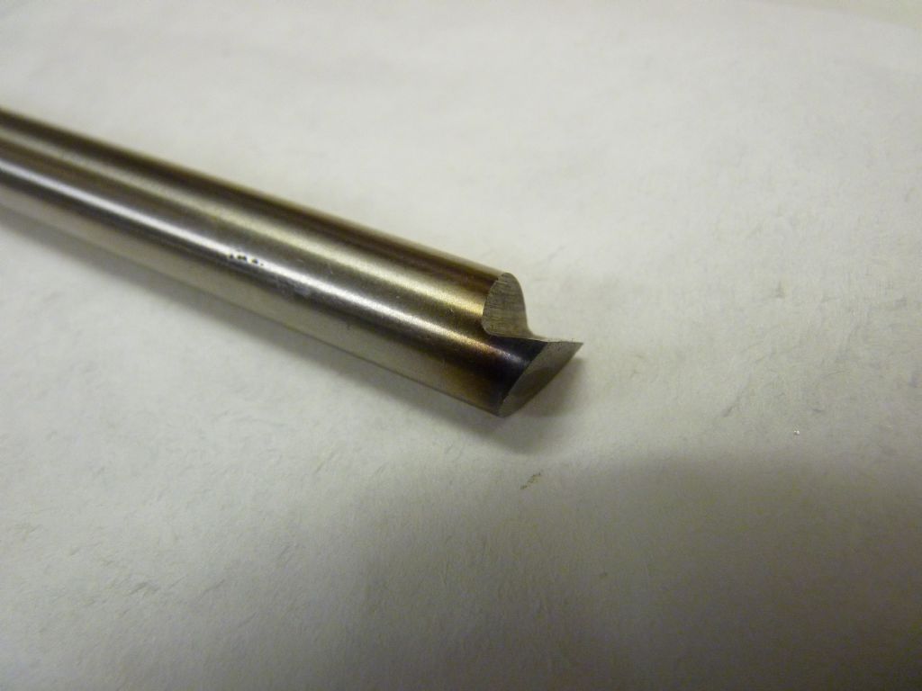

I ground this one up a few years ago
I seem to think it worked well enough but I gave up with it for reasons I can't remember dont know
I might give it another whirl now the topic has resurfaced.

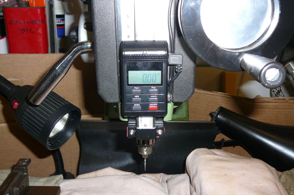

Right Gents, just an update.
Firstly I'd like to thank you all for the info and advice, it was very much appreciated.
I've finally managed to get the display almost stable. It now flickers occasionally but only by 0.01mm, which I can certainly live with, as there's no way I can machine to that accuracy in the first place!
The fix, however, you can pick and choose from the following items across the scale battery terminals;
1000mF electrolytic cap, 1F supercapacitor or a rechargeable 2032 cell. Any one of these stabilises the display (almost).
I just wish I knew why it was doing it and why fitting the normal CR2032 cell it 'fixes' it dont know
Regards,
Paul

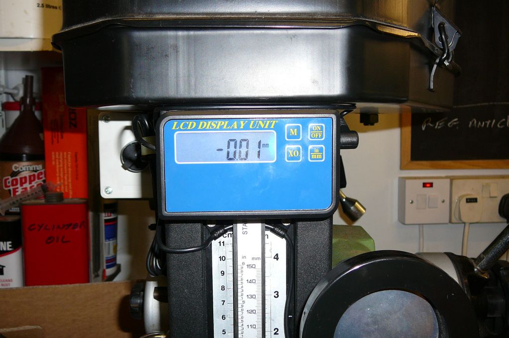

11/05/2014 11:07:25
Hi Les,
The scale takes a single 3v 2032 cell. The voltage at the scale terminals is 1.7v regardless of the display being on or off. As the display can be powered by batteries or external power I've removed the external psu from the equation by fitting batteries, 2x AAA, to the display with the same result.
I did fit a 200nF tantalum cap across the scale terminals last night but that didn't make any difference. I have got a few electrolytics but at much higher values but I don't know if that's worth a try?
Hopefully there should be a couple of pictures below, if not they'll be in my album.
Thank you all very much for your help,
Regards,
Paul

09/05/2014 16:53:11
After my original Z axis readout died on my mill/drill I fitted a new 6" vertical scale and a remote display as the scale display was rather hard to see where it's sited.
I found that when switched on the remote display powered the read out so I dispensed with the battery however the display now 'drifts'. You can zero it, turn your back and it's changed, re-zero it turn your back changes again!
I initially thought it was binding somehow but that's not the case. If I replace the battery in the readout the drifting stops. Now that's all well and good but with everything switched off any accidental movement of the quill switches on the readout for X number of minutes and eventually the battery drains and starts to drift again without you realising.
I was wondering if anyone had come across this or had any ideas of a fix/workaround.
Regards,
Paul
