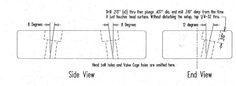

31/07/2019 18:50:26
I'm after some advice on how to set up and drill the spark plug holes in the cylinder heads .I think the attached drawing shows what is required.
 I have aTom Senior light vertical milling machine , tilting angle plate and tilting vice.
Thank You

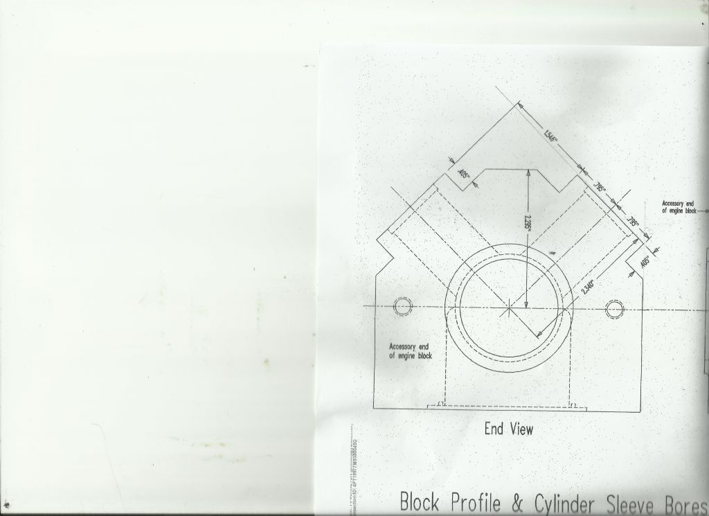

20/05/2019 23:26:35
Thanks for that Jason.
So the rotary table method is best because once the engine block is centred on the RT both cylinder banks will be aligned with the crank centre.
20/05/2019 20:01:58
Hi.
I've just started to build the V4 to Jerry Howell's plans.
I've made a start on the engine block and am at the point of boring the cylinder bores. In the build notes Jerry suggest mounting the block on a rotary table with the bottom face horizontal at the top and then rotating it 135* degrees and machine the first cylinder bank then rotate 90* and machine the second . Bit of a silly question but is this the same as having the top face at the top (horizontal) and rotate the table 45* for one bank and then back 90* for the second? because rather than mount the block on the RT I was thinking of mounting it on an angle plate and using a angle gauge to set it horizontal and then 45* each way. Also I don't understand the 1.546" measurement on sheet 8 it's to/from a point in thresh air?
Thank you
