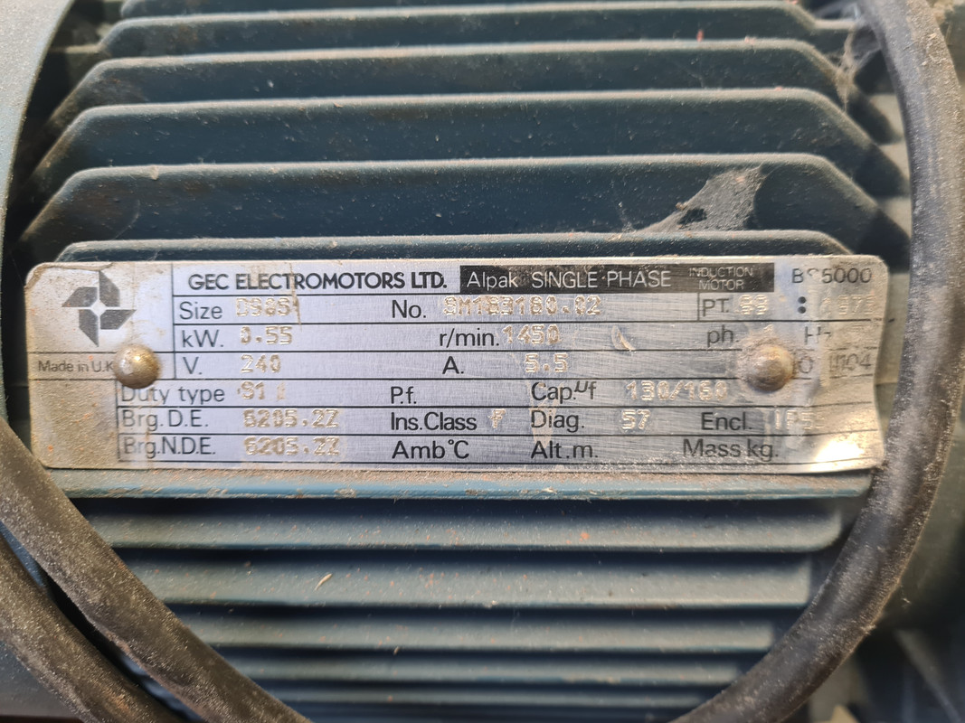

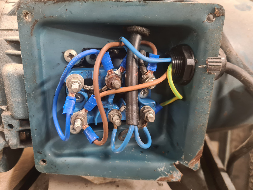

Posted by noel shelley on 24/12/2022 13:24:26:
U1 and U2 are your run windings Z1 and Z2 are the start windings. To reverse the direction of rotation swap over Z1 and Z2. Noel.
Thank you, i had to remove the block and i managed t JUST see the tags on the cables to swap them over.
Also thanks to the other for the help

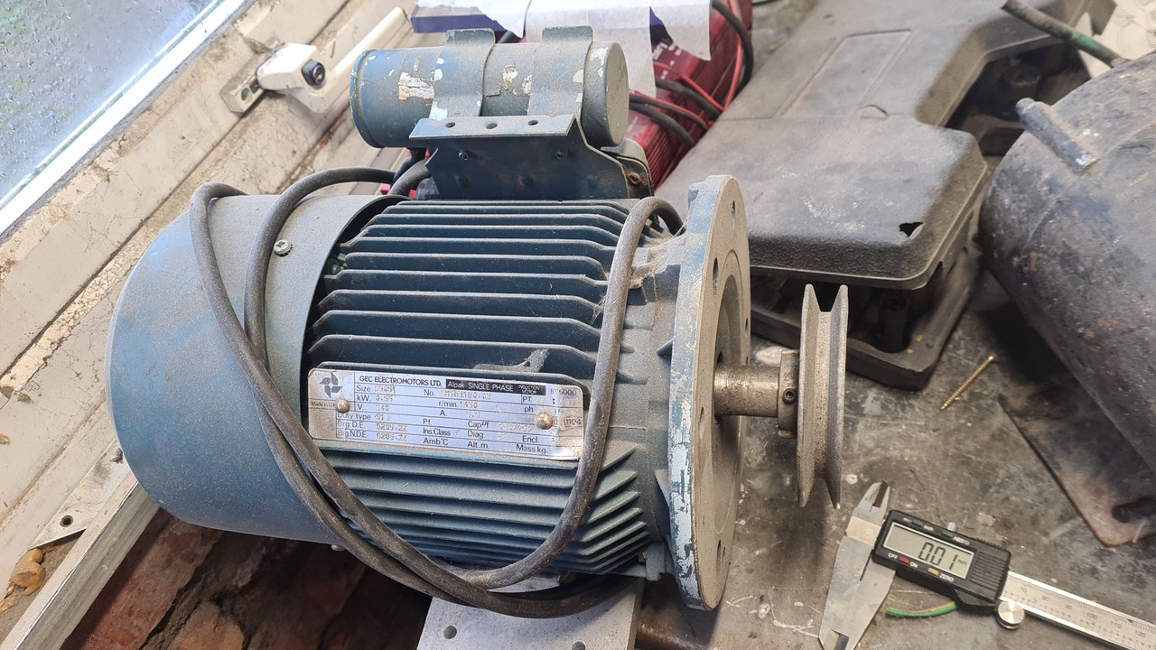

All I want to do is use the motor I have to run at lower speeds than the 1440rpm it is. Maybe as low as 500rpm. Also be used with a foot control pedal.
If I can use a VFD, which one AT1 or AT2. Would be good to use the dead stop feature as I use on the o e on my lathe.
The project is to fit a thick wall tube inside an outer tube thay is fitted to the motor spindle to use a grinder to do the job to round off the edges.

This is only a tester to see if what I am doing works so I can get a 3phase later if need be.
This is the motor I am using now though.
https://i.postimg.cc/MGbSsKmc/IMG-20221223-WA0000.jpg

24/12/2022 11:39:45
Excellent chaps thanks. Once my head is straight and stopped wobbling ill see about the windings. Had a bottle to many last night.
All best for tomorrow and new year chaps
I need to sort my head out with electrics soon enough as my workplace want me to be the maintenance chap and go on a few courses. Head aches to come i reckon, not easy to to old dog new tricks haha
23/12/2022 19:41:39
Ok i have googled etc etc and still cant get my head in gear.
In simple, can and how do i reverse this motor please.

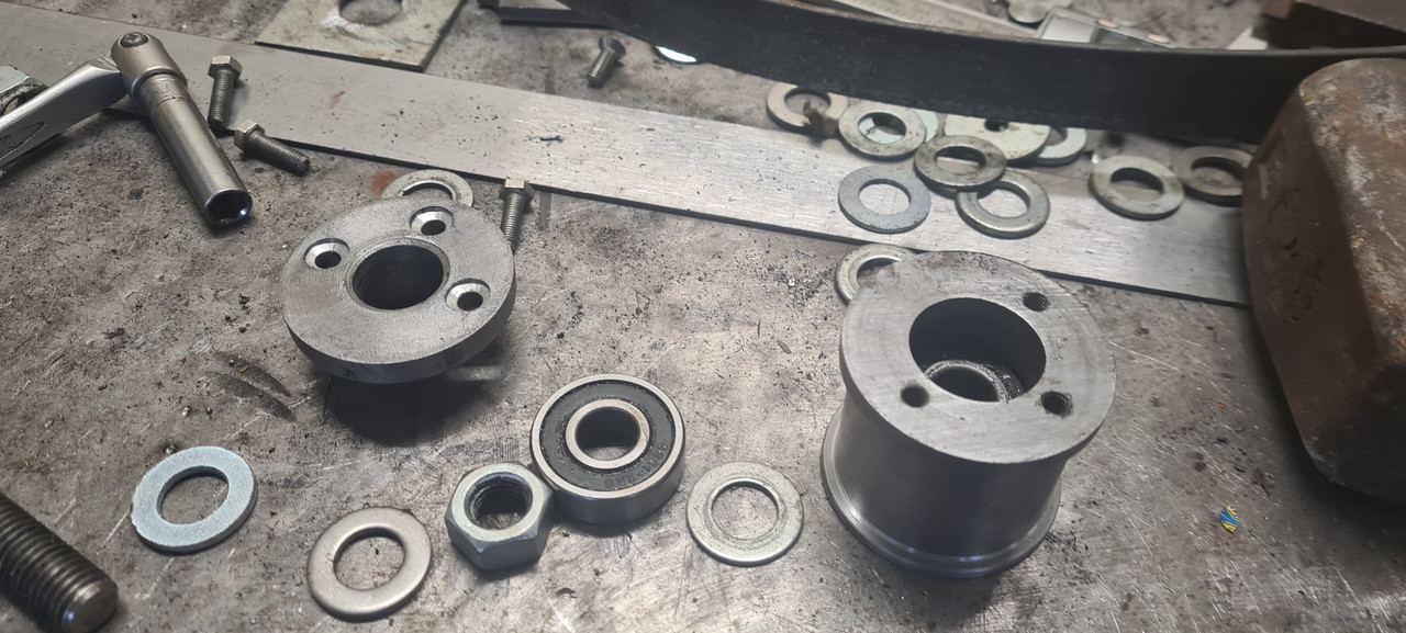

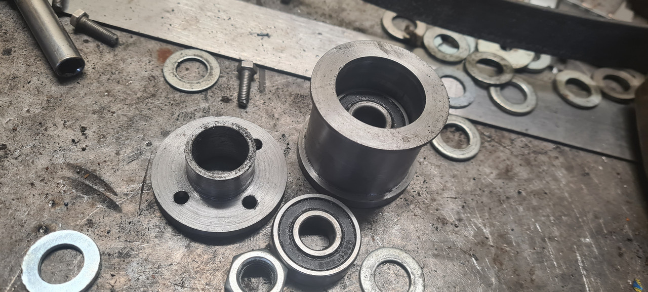

I recently amended the conveyor rollers from work due the bearing collapsing and turning the ends down for new bearings. Nice little earner aswell

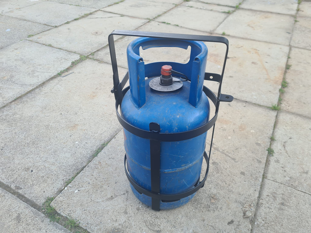

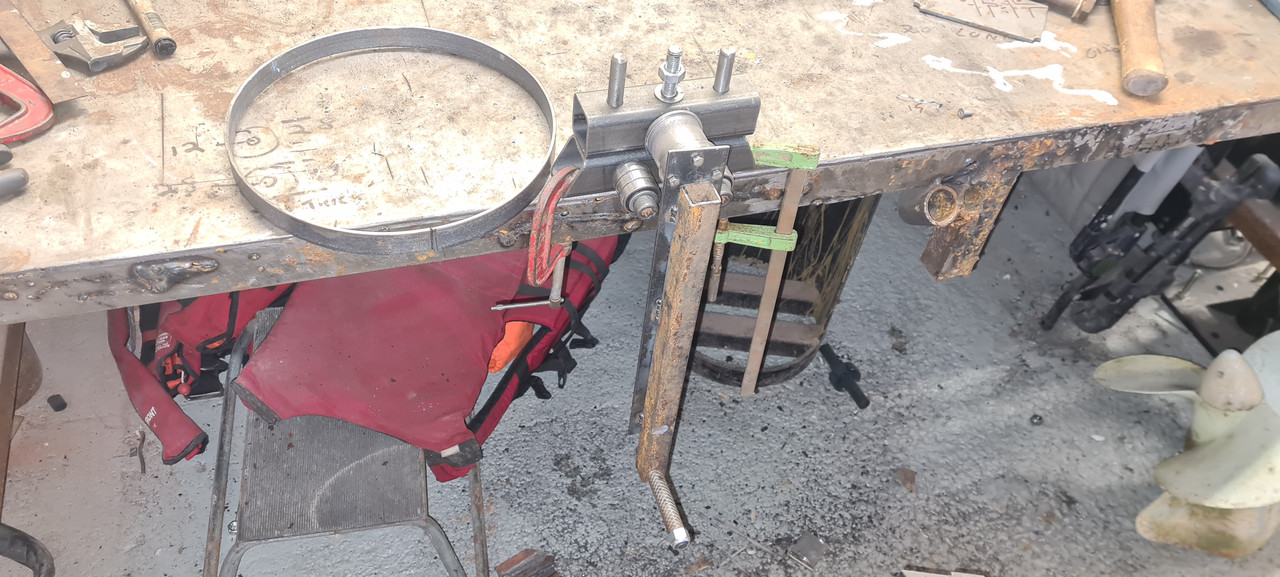

And only thing i got pics of was a roller i wanted to make for making these cages i sell.
these are not precision bits of kit good practice and work great

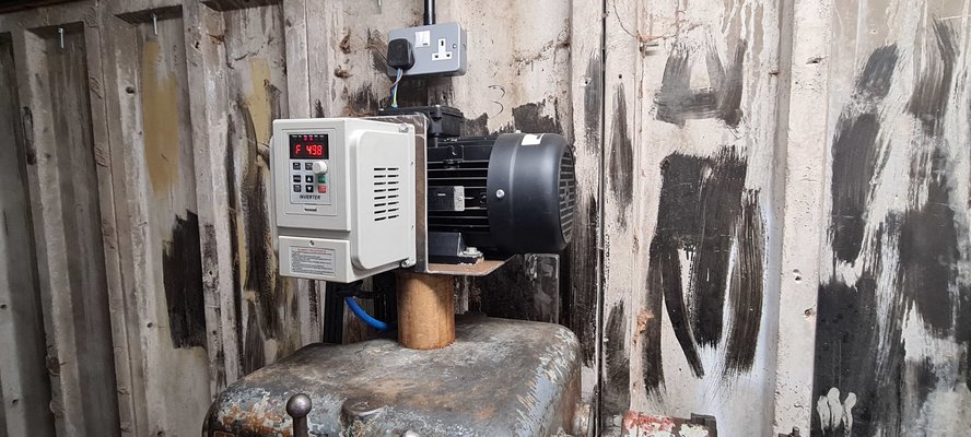

18/12/2022 19:39:51
Well i gave up on looking for info on the lathe. it does what it needs to do. A bit of a faff as the scale are not very clear so will be fitting a DRO some time.

I have it wired up to a 3ph 415 VFD and works fine. I just need to sort out a tapping noise coming from the top pulley. Il be stripping it down this xmas as have a bit of time off ans T works over christmas so lots of time. well aswell as loads of other things to do.

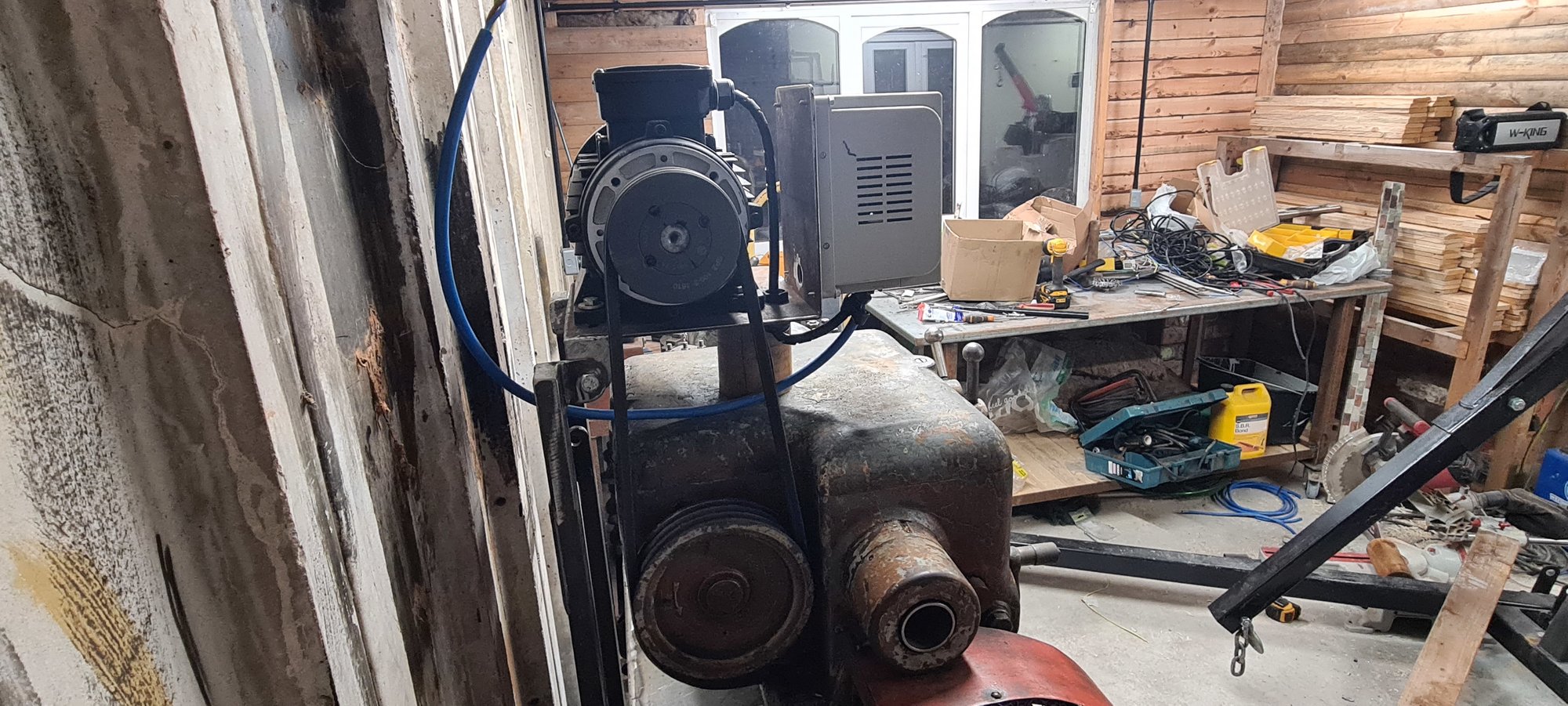

13/11/2021 20:59:34
Think i will have my first go tomorrow, made new cabinet now and sorted the fitting of the new 3ph motor and VFD out. need to programme the VFD though i think. it runs but its tech so ill sort that tomorrow aswell.
I also found the G box drain and filler, so i will be doing an oil change soon aswell.
storage for gears and face plates
the belt adjuster is temp as i need the lathe to make a decent adjuster.
Oh and not painting the cabinet, i was but not now. I will be at some point adding a draw or two in the end unit aswell for tooling.
