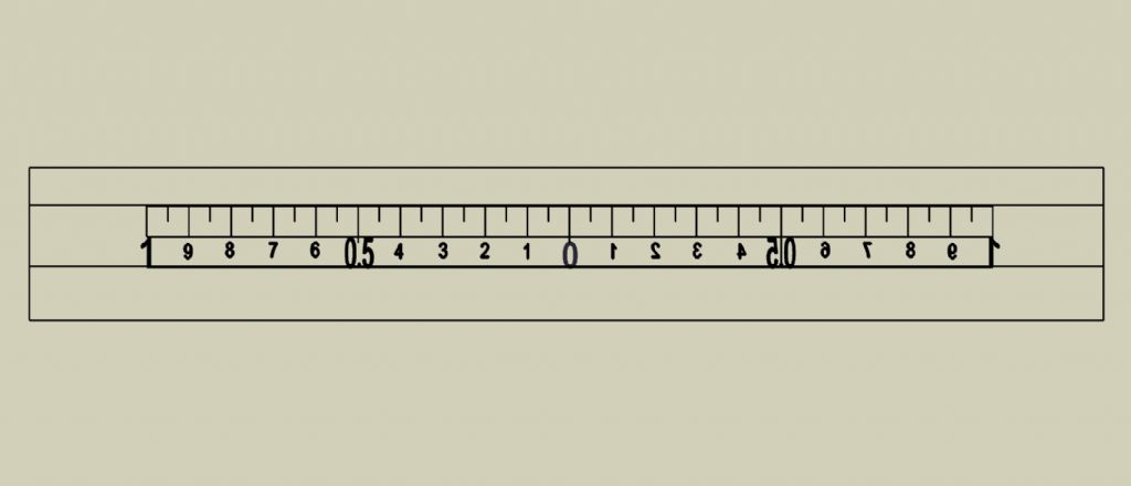

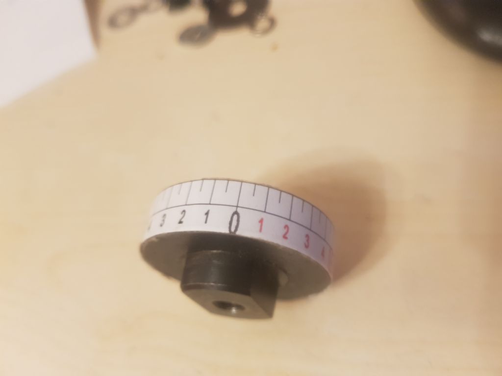

Thread: dirty metric fudge
07/07/2021 07:01:03
Indeed a good point, but i didnt want to post this for being shot down by hardliners who demand precision
I will post some pix of labels which can be scaled to suit, or anyone with cad can make their own
there are of course cases where a 1.57 thou error is unacceptable eg shaft fitting a bore. if its over it wont fit or else be loose.
personally i prefer to know exactly with my fudge but in the agricultural world ................
CNC world works at micron level - scary
I am trying out my simple fix for an adjustable micrometer dial (after all a dial gauge has one) but space is very limited and I am trying to keep it simple
Any one else been there pls pitch in

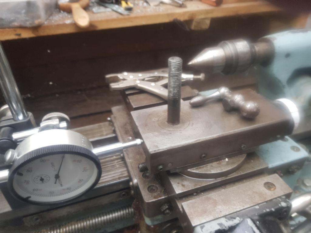

Thread: Tool post height
07/07/2021 02:39:41
Thnx 10^6 Pete Im on it.
Its going to be much more rigid and is probably why I only ever had mediocre results and only used small mills
07/07/2021 01:50:29
yes DW 2 but Ive only ever drilled holes or made small slots <1/4 dia, never tried surfacing
07/07/2021 01:42:52
stick a straight shank end mill in it
take the surface of the top slide with 1mm cuts
bad idea?

06/07/2021 20:03:46
isnt skimming the base of the tool holder the same thing
in the pic i actually went 1mm lower than I wanted to because my auntie dore Westbury had a blonde moment
06/07/2021 17:12:36
metric fudge dial.jpg20210704_153147.jpgHaving seen the cost of metrifying a combo slide £190 for the kit. I thought of a quick cheat which comprised making a suitably scaled label on cad and sticking around the rim of the micrometer head.
now Im sure this must have been done before, so apologies if this is old news.
You measure your rim - 36.7mm and make a label divided into 25/25.4 x 36.7
I made my divs 0-1.25, with the black scale counting up towards the work and also counting up red scale away from the work
I made the dial resettable as well - another story
The reason is that combo slide micrometers are normally used for close finishing cuts. So reset the dial to zero and proceed as desired
I checked the dial for 1mm against a dial gauge and it was spot on
Of course ther is a small gap between start and finish of the scale but its liveable, its not an absolute dial, its relative
I also thought I might make the cross slide with 2x unit scale so that it read diameters instead of radii so 1mm in becomes a 2mm diameter reduction
Is that confusing?
apologies for the scale pic is was a trial, I will get a better pic but you get the gist
06/07/2021 16:53:35
OBTW I wish there was a way to save a post in hand, cos if you stray from the page then your work is lost
yes i could save a txt fill to notepad
also once a pix is inserted you cant move it or get below it for further text ?
06/07/2021 16:49:29
Having invested in an RDG QC tool post system - very nice too - to be fair RDG was totally up front in saying that while the tool post could accept 12mm shanks these are too high for a Myford - 10mm or less ok.
What isnt said is that 12mm is far more common than 10mm. however a brave Myfordian had this solution
Video Link Deleted see CofC
drastic maybe?
I tried a simple way and milled out the slot of the holder 3mm deeper
this is the result
Edited By brian jones 11 on 06/07/2021 16:50:34
