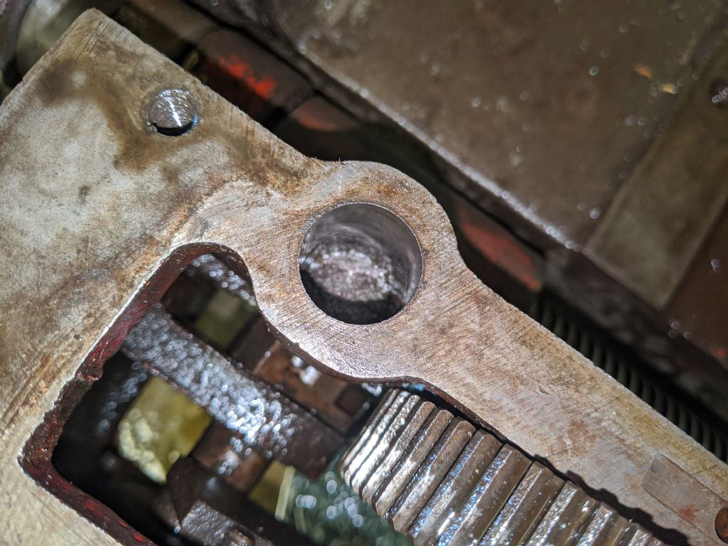

I did not check the holes of the worm box for ovalness, but they seemed round to the eye. But I will measure them tomorrow. They seem round enough so I doubt that I will change them, but the measuring is always useful. I'm very happy you appreciate the bling. I will be blinging a few more handles as they look much nicer without the dings in. Mainly the apron handles since they're the most used. The handwheels can stay semi-polished since they are going to be well worn and show some character. Although who knows... I may bling at a later date! I hope the measurements are useful to you

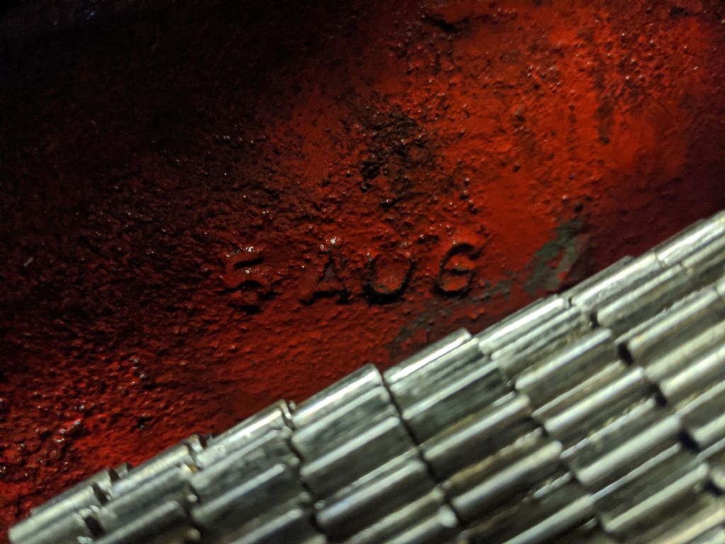

05/08/2020 00:22:00

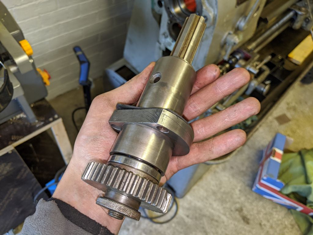

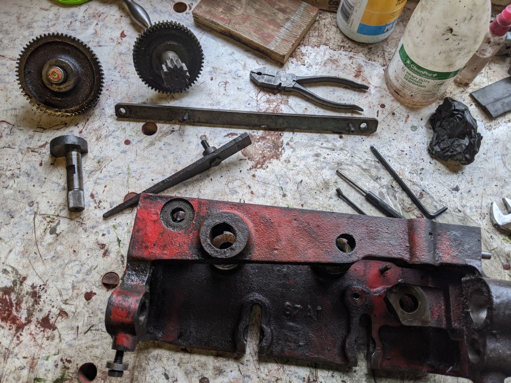

Anyway, back to cleaning. I was happily surprised how easily the whole assembly came to pieces

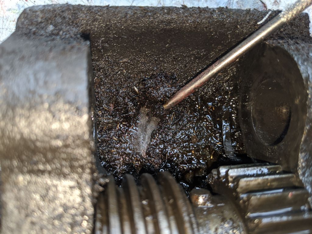

I started by cleaning a section just to see how easily the dirt came off, and I was happily surprised once again!
This shaft was held in with a set screw, which was easily removed with little effort
Then the next shaft was removed through a set screw that I thought was just an oiling hole for a bushing. Clearly not. This was very gunked up, but all clear now!

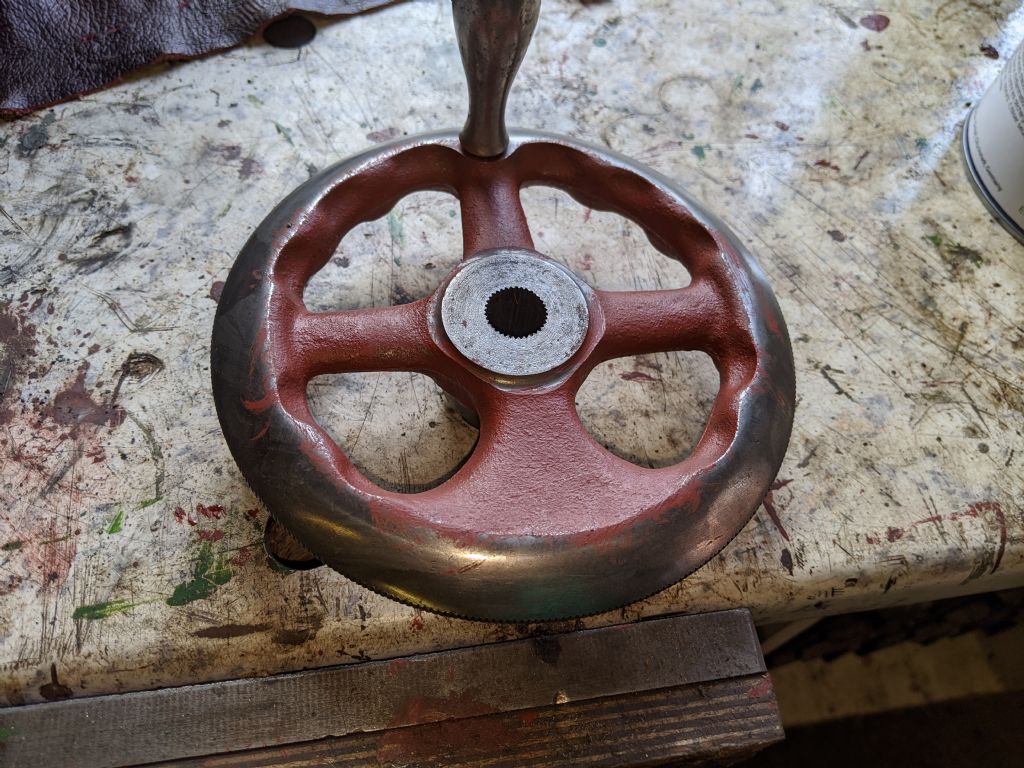

Here we have a few of the parts, still missing the handwheel shaft and the broken half nut, but as far as I'm concerned, a very simple apron. Only made less daunting through reading Hermans forum posts. So lots of appreciation there.

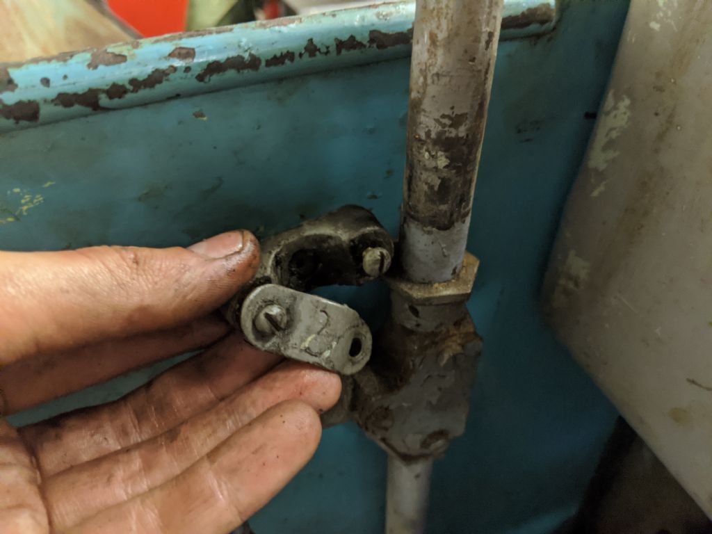

Then I popped out one of the tag holder pins and rotated the tag out of the way. This allowed me to go in and clean behind them since they had paint and gunk stuck, which meant they did not lie flat. More of a cosmetic issue. I bent them back flat and they look a little cleaner now, more like they're on the surface rather than having paint go up to them.

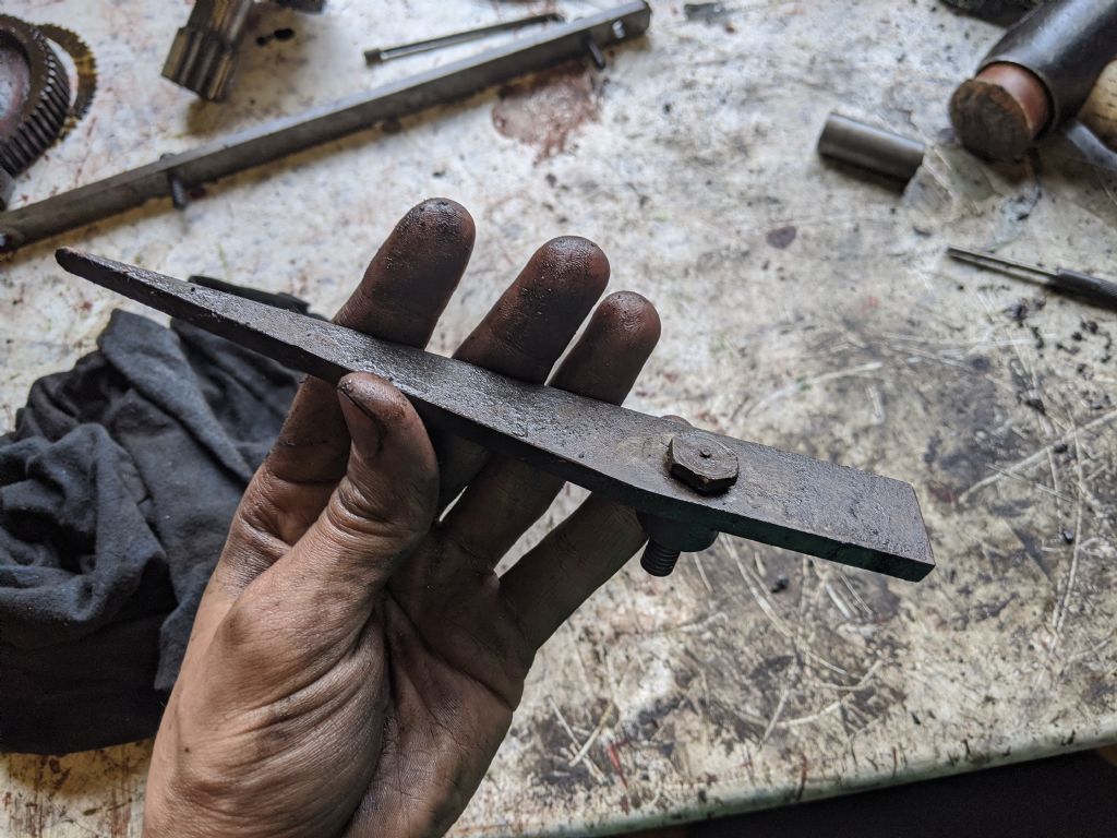

Then I removed the level/locking bar that stops the feed and screw cutting lever from being activated at the same time. So the machine does not pull its self to pieces. I have taken many pictures of the sizes below, since Hermans lathe was missing these parts. More to doccument them since Herman had a sketch of one that someone had made. Hopefully this helps someone somewhere someday!
I could almost have done with some of those hand garments too!

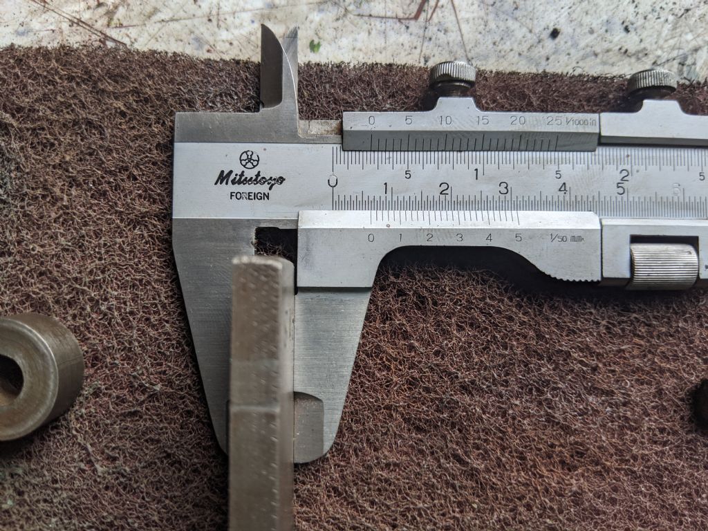

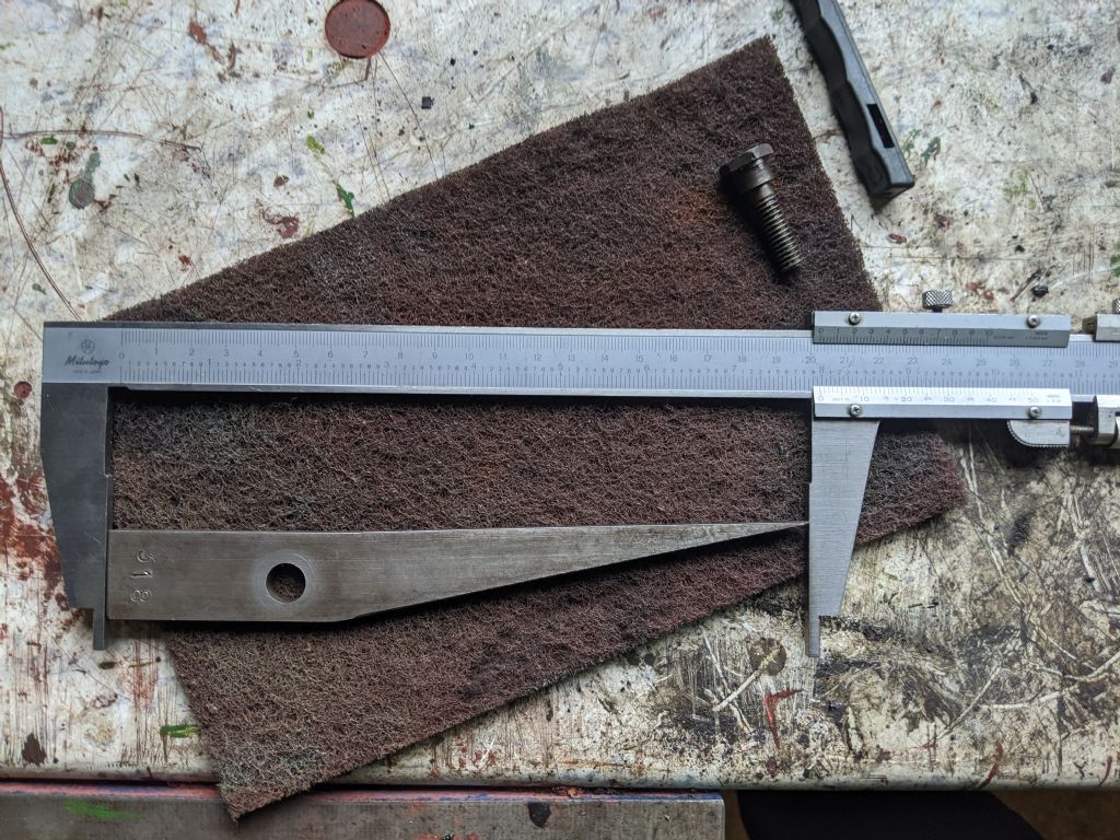

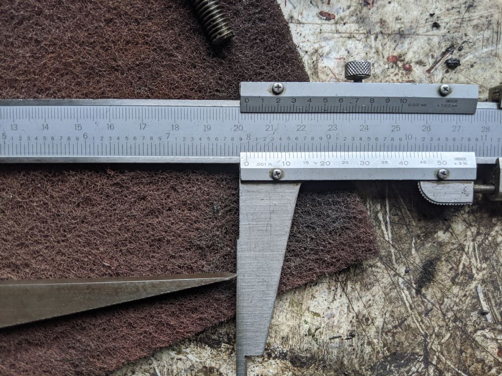

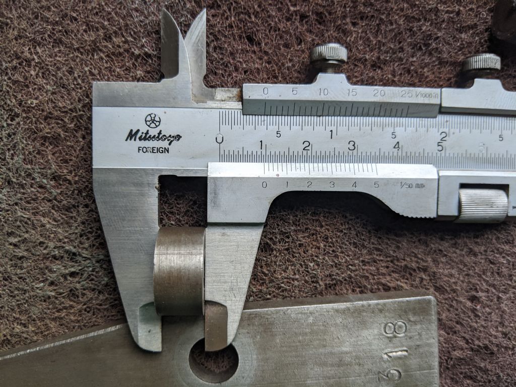

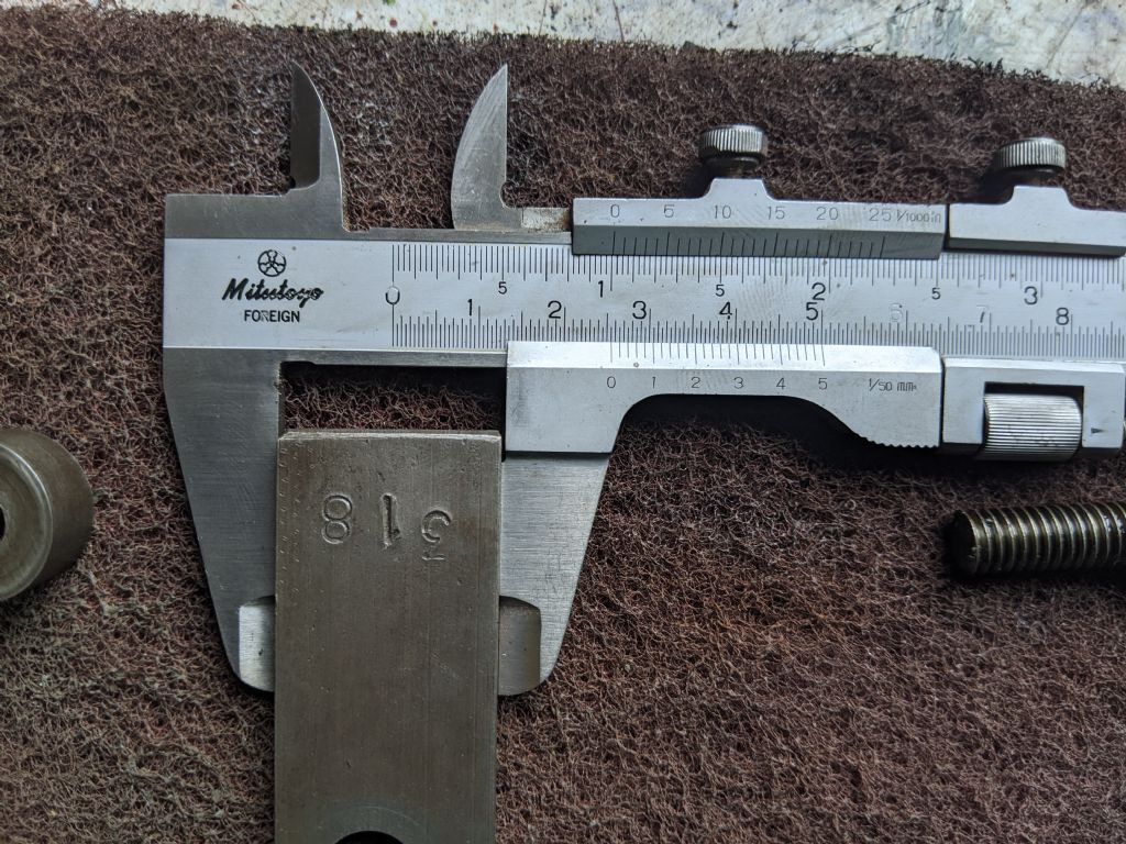

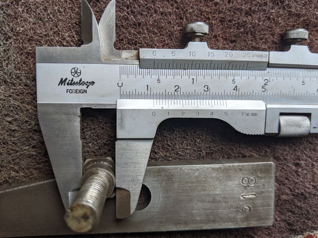

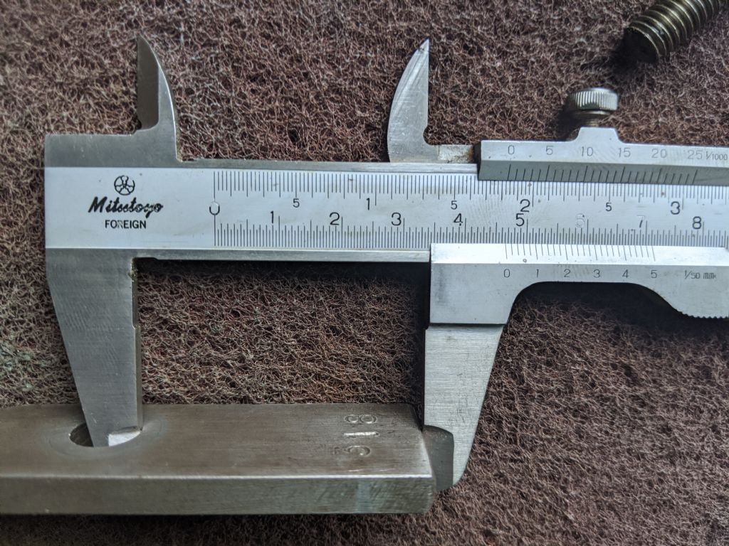

I did not measure the hole, but instead the shaft that goes through it. So it is always loose, so it is allowed to spin/turn
The thickness of the spacer is the only important feature, I am unsure if Herman knows of a spacer or something, but one is needed to put the bar at the right distance, and its thickness is as measured below. Fine tuning may be required (Pictures only represent half decent measurement, so take as you will)

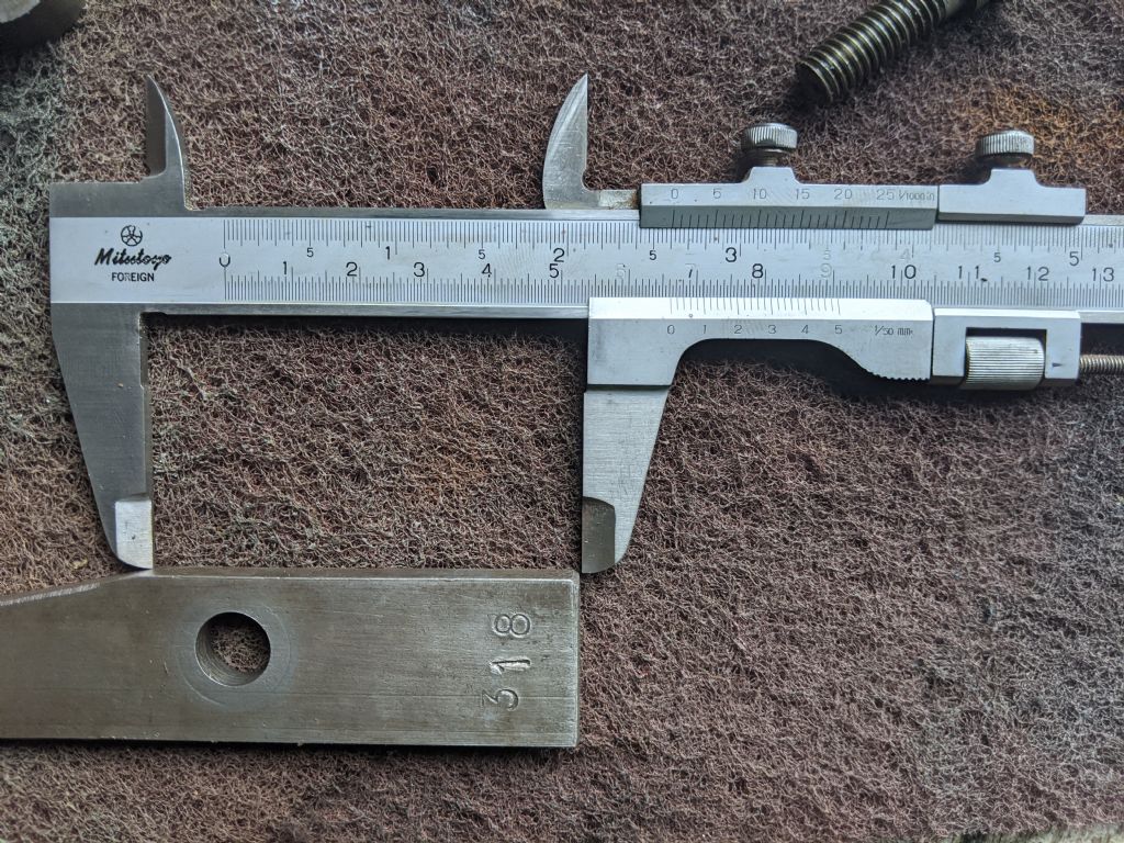

Then, lucky me, I got to get the big calipers out. A lovely piece of equipment from a very lovely home. The men in Scarborough that I bought some tools from. I regretted not purchasing a few bits from them, so I asked if I could buy a few more and arrange a courier. This is weeks ago now, but I got the big vernier, slip gauge set and the larger depth micrometer. So It really came in handy here!
Overall length may not be critical, but it is good to see a full measurement.img_20200804_162358.jpg
Then, after cleaning all parts, I moved to reassembling everything
I figured out that the spacer that I made was slightly too thick, preventing the circlip from engaging properly. This is why the whole shaft came out when the new(original old) hand wheel got stuck and I gave it a yank. So I really had to take this all to pieces anyway. So, the spacer is now the correct thickness and the circlip fits in the slot very nicely. I also took good care to clean out the spaces where the wormbox fits in. This will provide better registration.

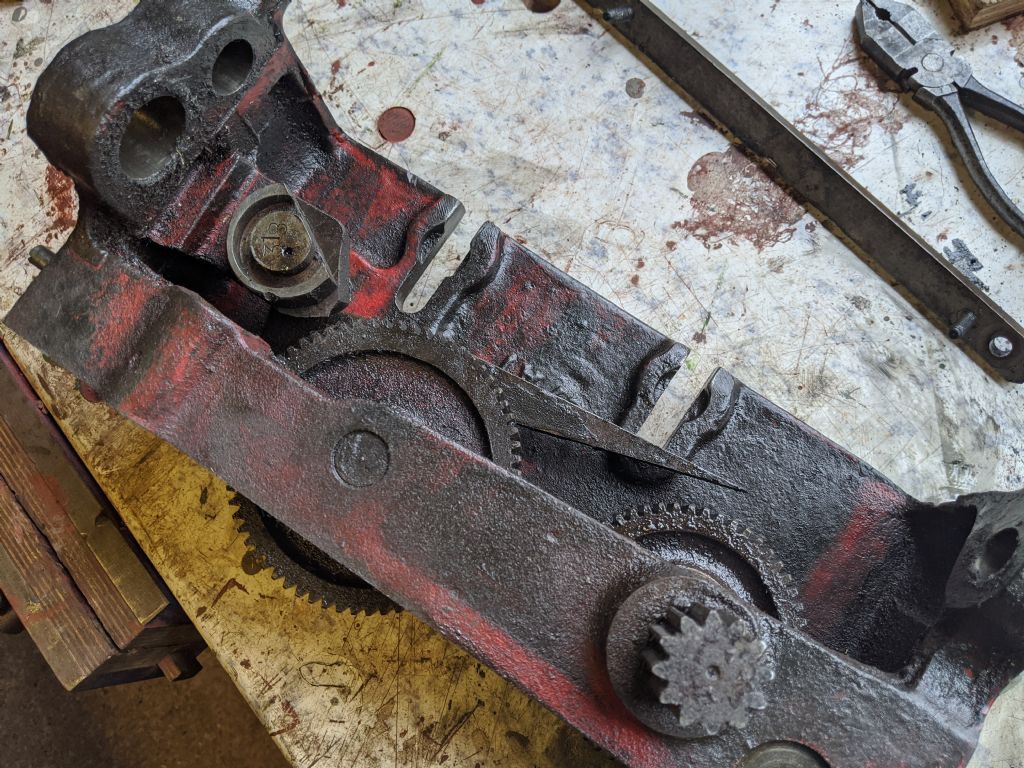

Very long post ahead. But with good progress so I'll dive in

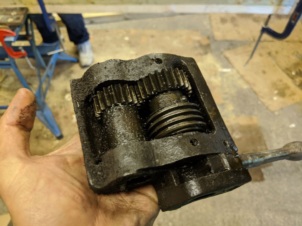

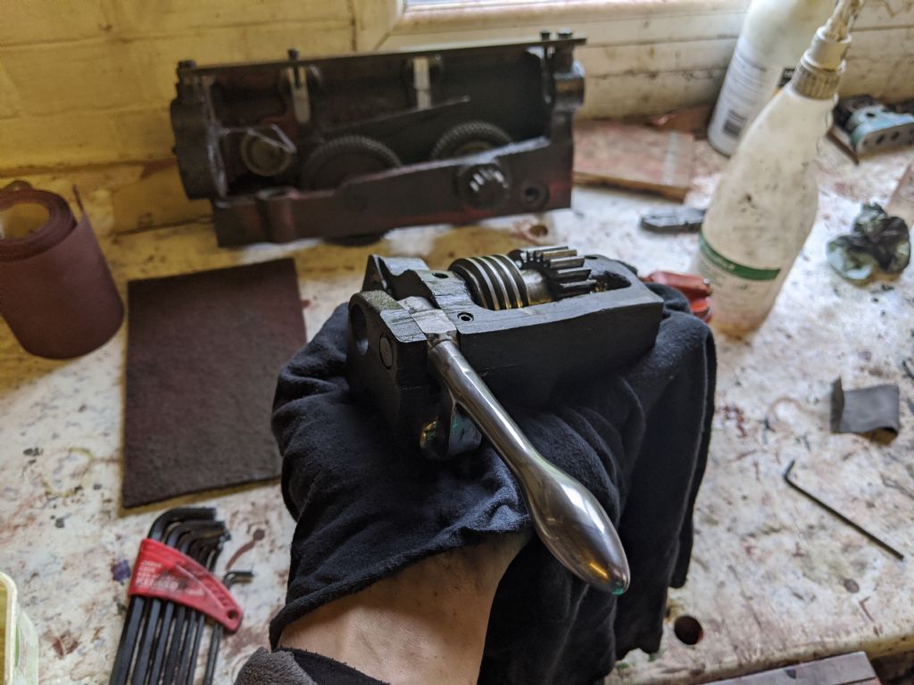

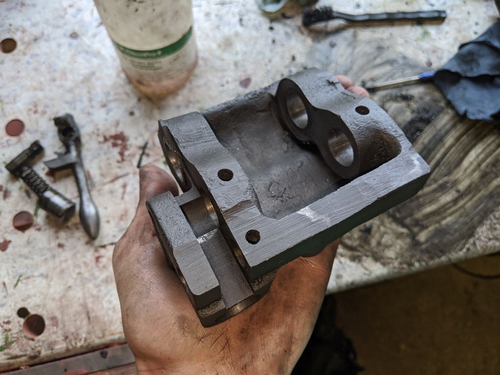

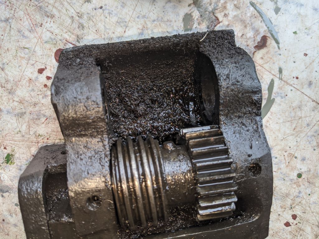

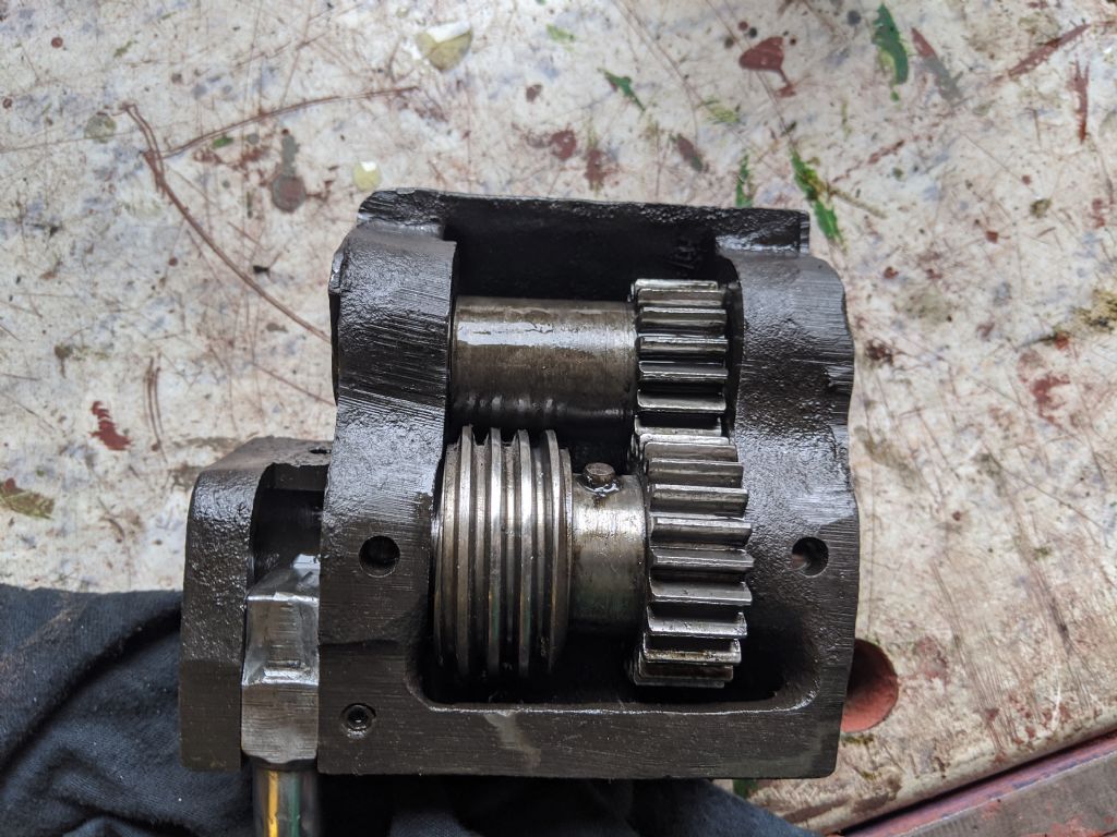

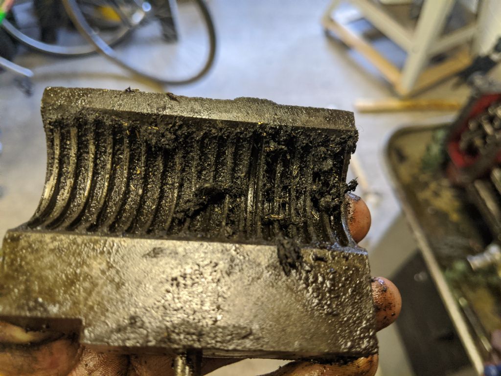

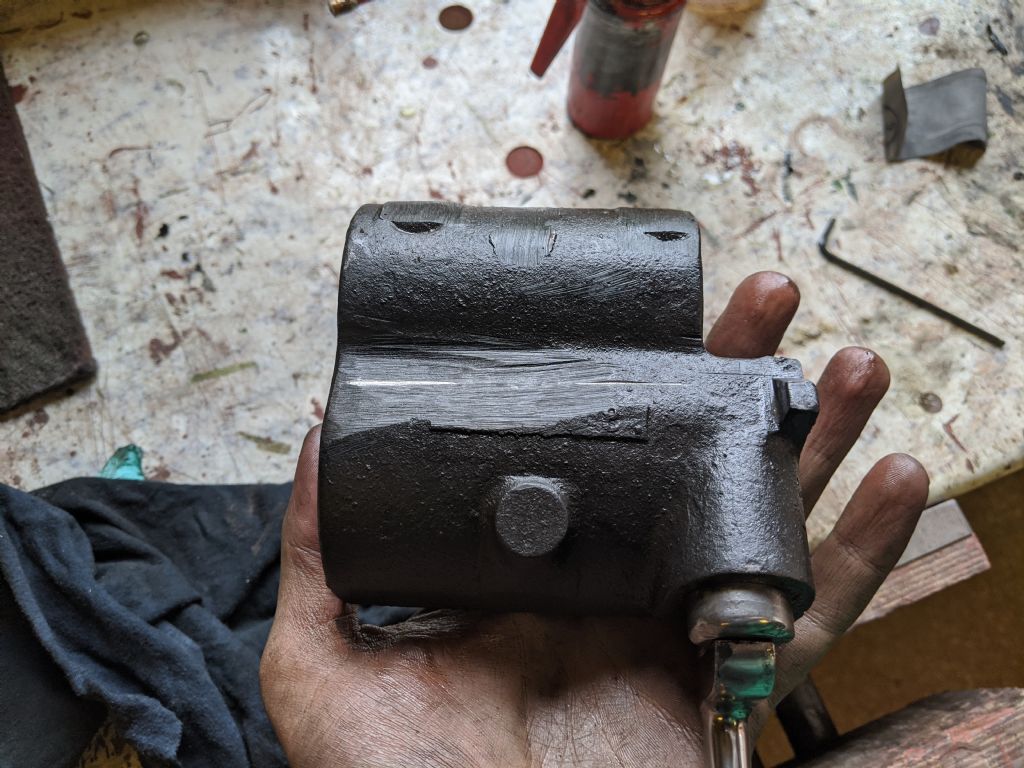

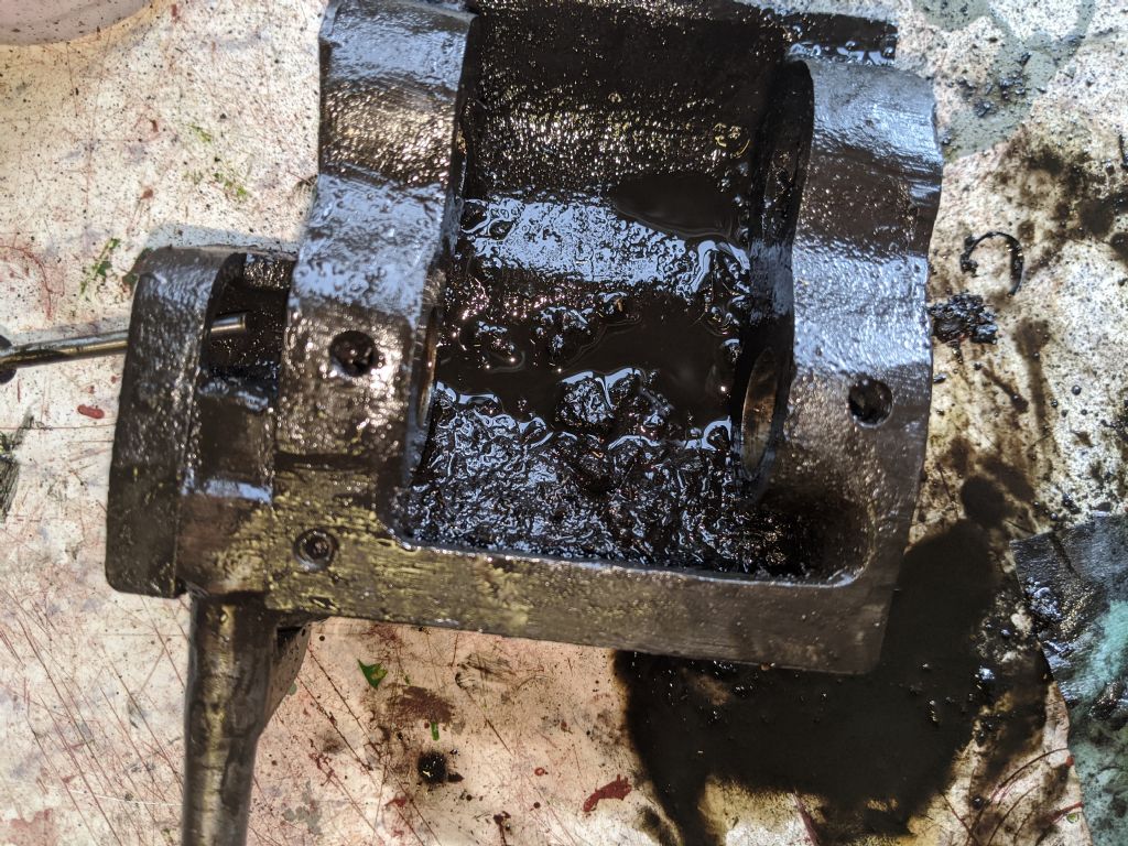

Started off by taking the Wormbox(thanks Herman) to pieces. I was a little scared by the spring, but it wasn't as strong as I thought it would be. So good news.
Absolutely filthy
Cleaned up the body

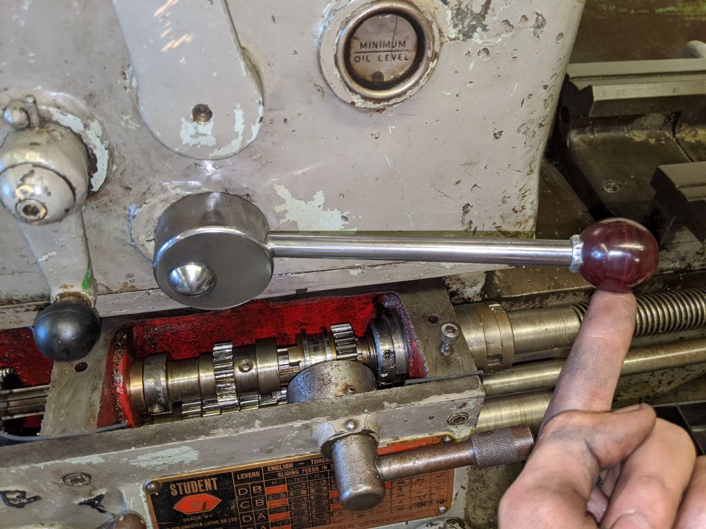

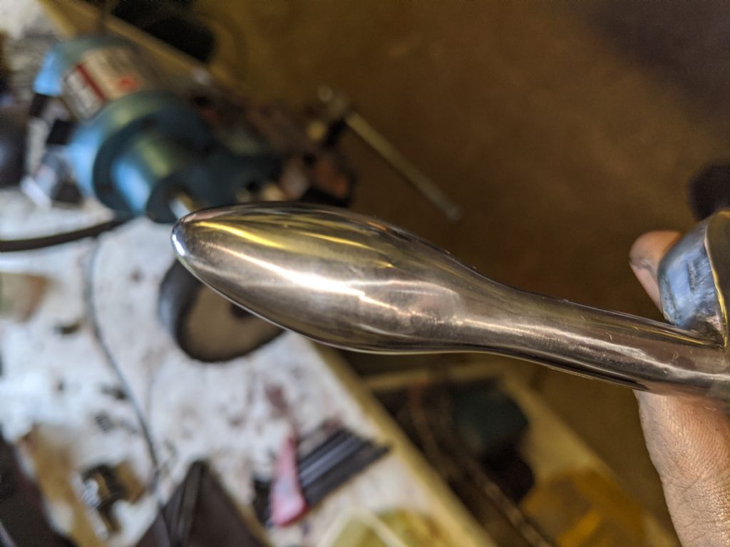

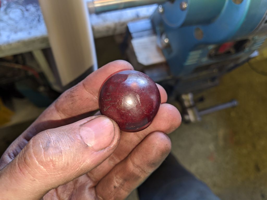

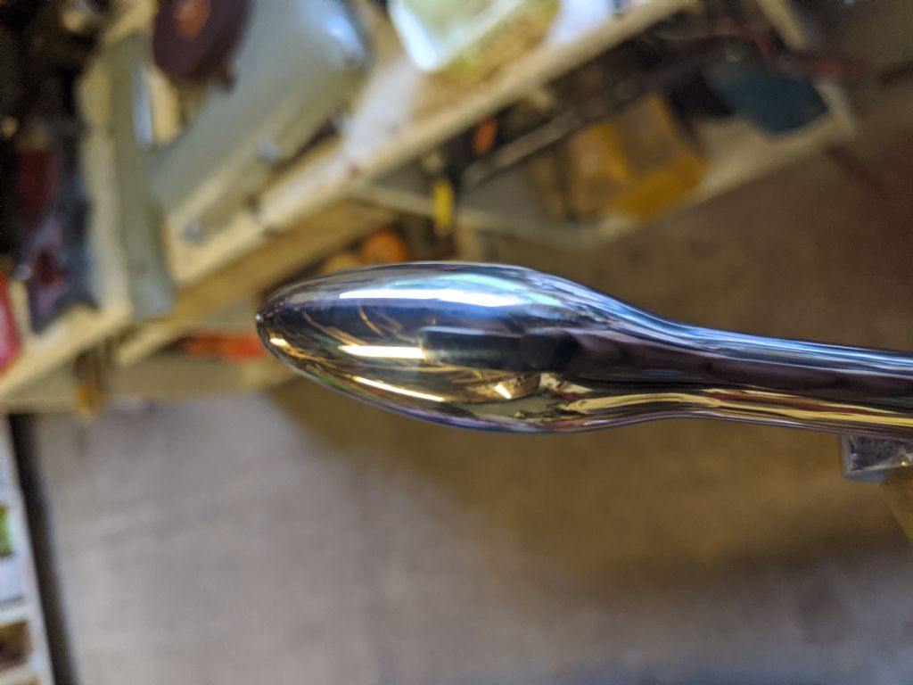

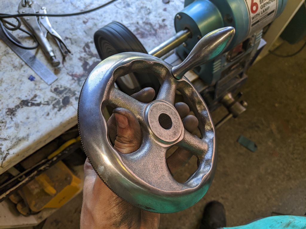

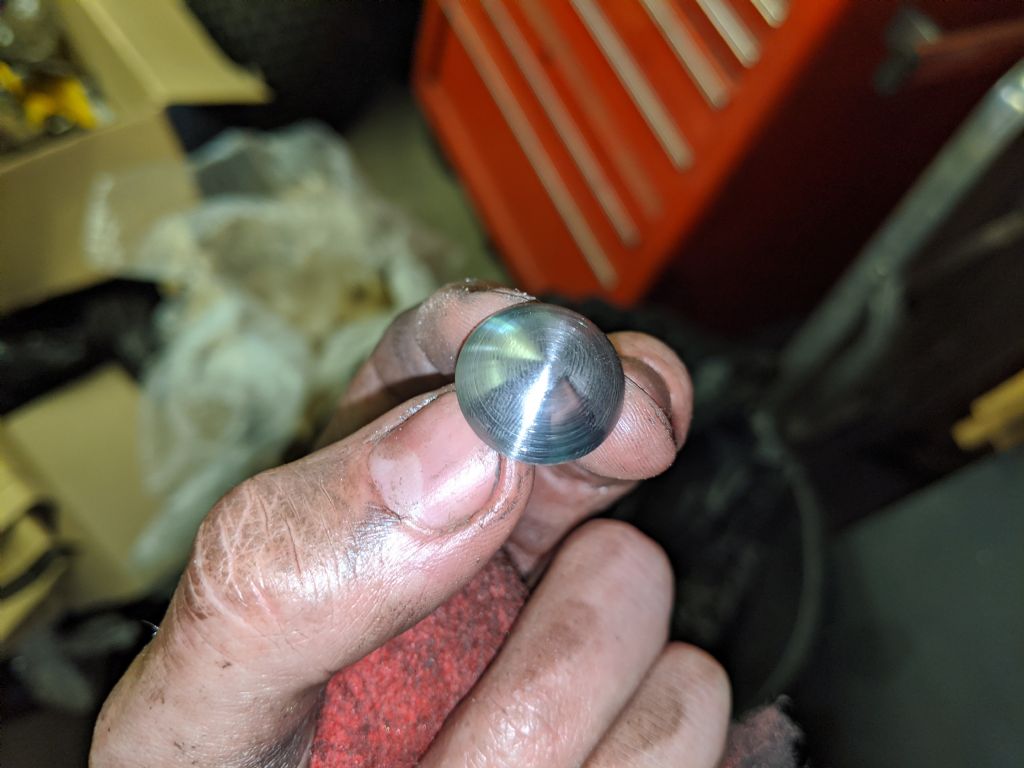

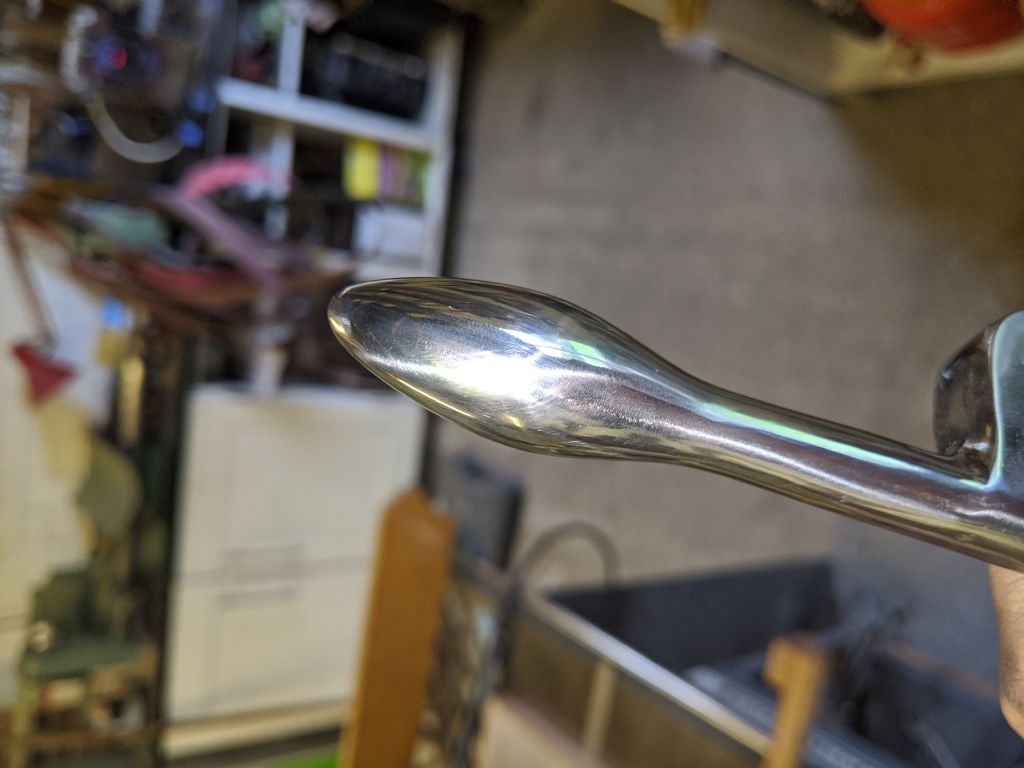

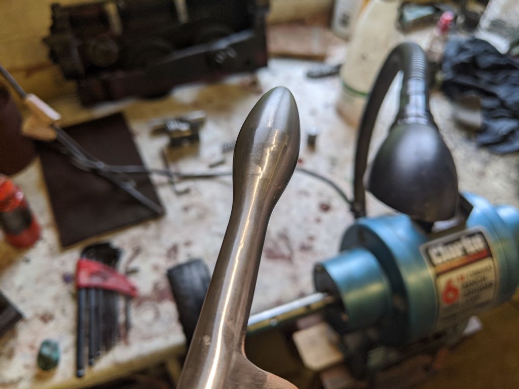

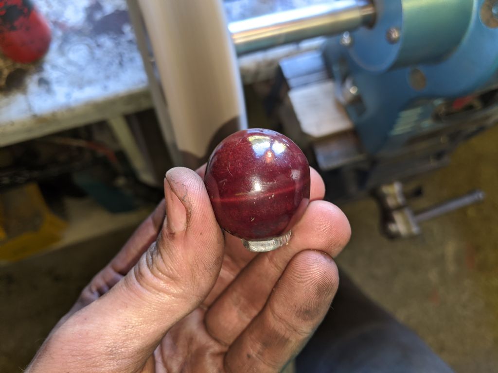

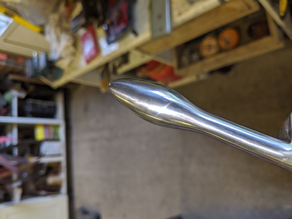

I decided that the lever at the bottom was very dinged up and not very nice to hold. And its about time I did some BLING. Got to show Herman how it's really done...
So I started off using a 600 grit belt on my belt sander, but using the unsupported belt section so it was slack and conformed to the shape. I used this to remove all the dings, then blended lots of surfaces.
Then I went to my standard green compound on a standard buffing kit wheel as a prepolish. This left a buffed surface, but not a nice shiny mirror surface like true bling should be
So I moved onto my proper buffing kit, starting with a Green 439T compound with a white close stitched polishing mop. If anyone wants a good source of polishing and bits, I find The Polishing Shop To be extremely useful for all my abrasive needs
From there I moved to a Blue P164 Compound with a Loose G quality mop
And finally, to finish it off, I went to a P175 compound with a Loose WDR quality mop.
So you tell me Herman. Do I BLING? laugh
It took me possibly 20 mins, so not too bad, and I'm very happy with how it turned out. I may be tempted to do a few more handles.

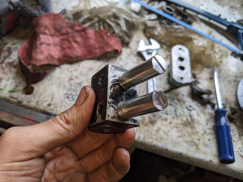

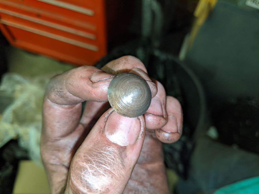

So I stuck it all back together. I spun the little spun plug 90 degrees so that its using the less worn area now. It's now very clean, and I oiled everything
Then onto the rest, lots more cleaning. I have made more progress, but I'll finish the update later

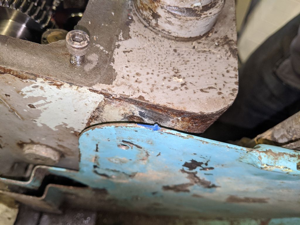

04/08/2020 12:20:59

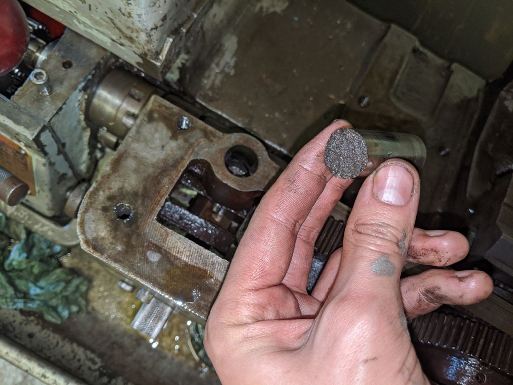

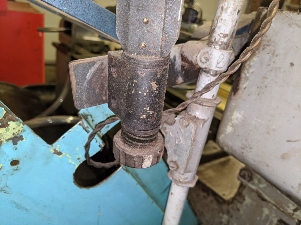

Result!

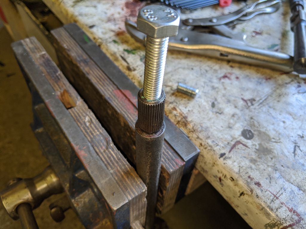

After an hour of fiddling, one good pry and it just popped out.

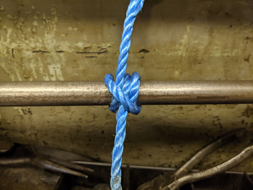

However, I started off by trying the knot method. This worked better than expected and it did hold the shaft, but even with me pulling it, there wasn't enough force to get it out
I did find a small bit of aluminium, but it was only 1-2mm thick, so didn't do much
I spent a while struggling and thinking what to do, pulling on the shaft occasionally, to no avail
Then suddenly I had a fantastic idea that I don't regret in the slightest. Not ideal, but i decided to get a nice screwdriver and stick it in the end collar and give it a gentle pry. And there was a quick pop and it came out. I didn't have to apply much force at all. I was quite surprised. I had tried with a smaller screwdriver but I wasn't applying much force at all as I am aware of the damage they can do. Luckily it worked out this time.
Then I carefully held a bit of leather around the collar as I pulled the shaft out, for one of the balls to still land in the chip tray. I have them both, so no loss yet.

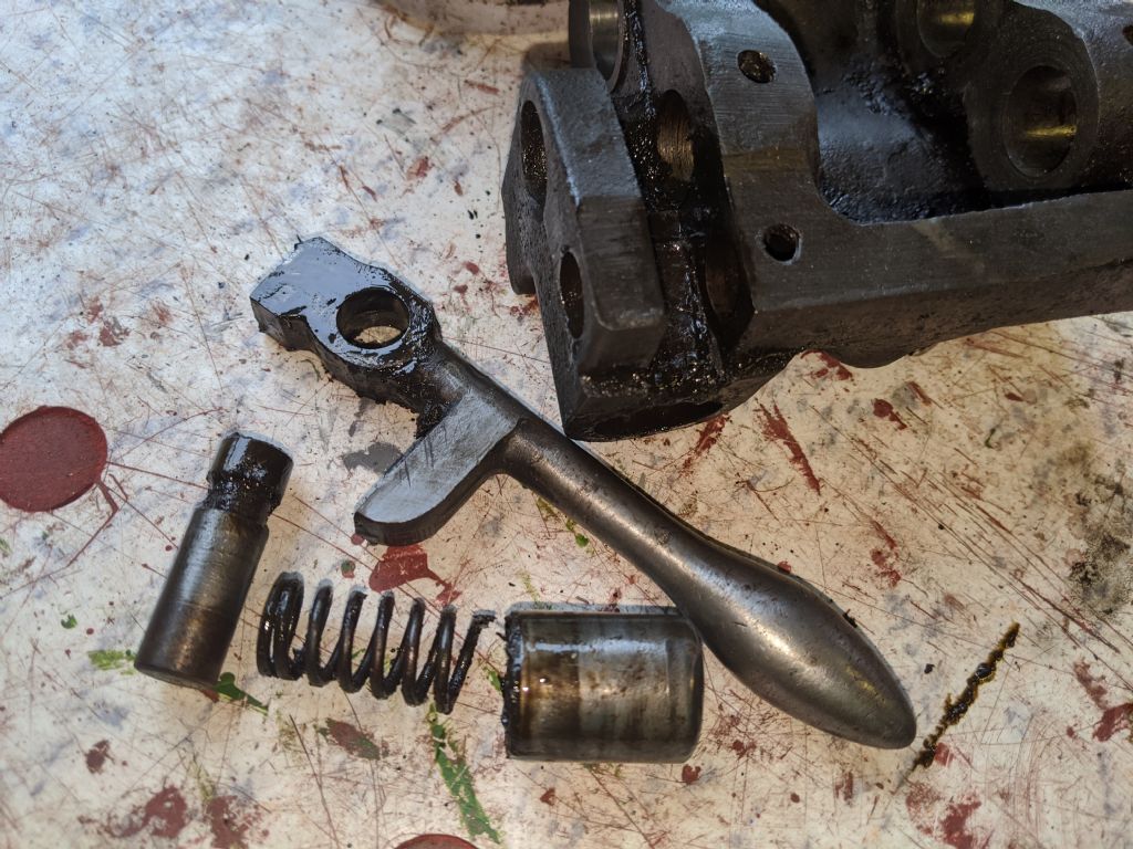

I was interested to see that there isn't just a spring in there. Well there is, but it's not just a spring, looked different. Not quite sure. I don't want to mess with it as it worked before.
Took a bit of effort, but it slid out eventually

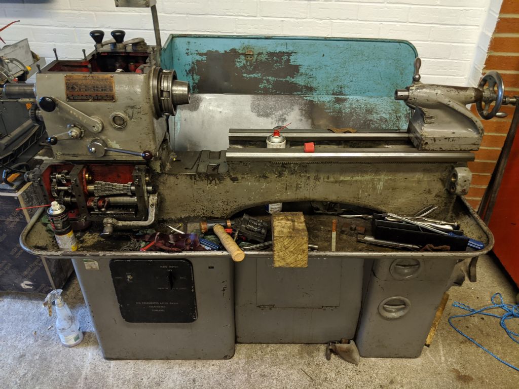

And now I have a very bare lathe. I could put it back together and have a lathe without feeds
Whatever this bit is called, is very dirty
In fact the whole thing is dirty. I will be cleaning for a long time
As for the holes, they are not as oval as yours Herman, but they are ovaled by less than 0.5mm, so I think that's good enough for my use. Maybe by the time i'm 50 I'll re do them. But Hopefully this lathe will have an easy life with me.
More gunk under, followed by more gunk
Anyway, time to get on. Apologies for the screwdriver sin, but it couldn't be helped and it got the job done!

I don't have any aluminium bar lying around, so I may try the rolling hitch, to begin with.

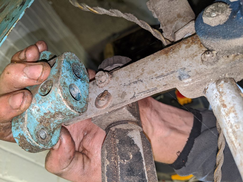

03/08/2020 20:16:47
My friend says he has some goggles so hopefully he will be able to find them for next week or whenever it is.

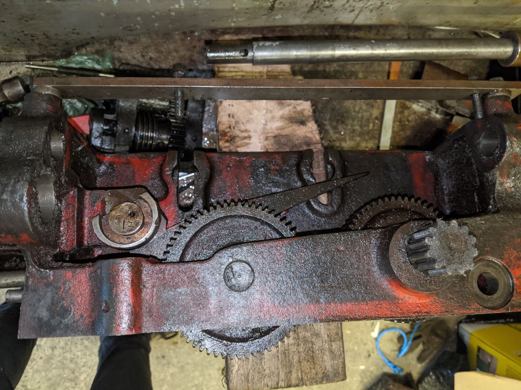

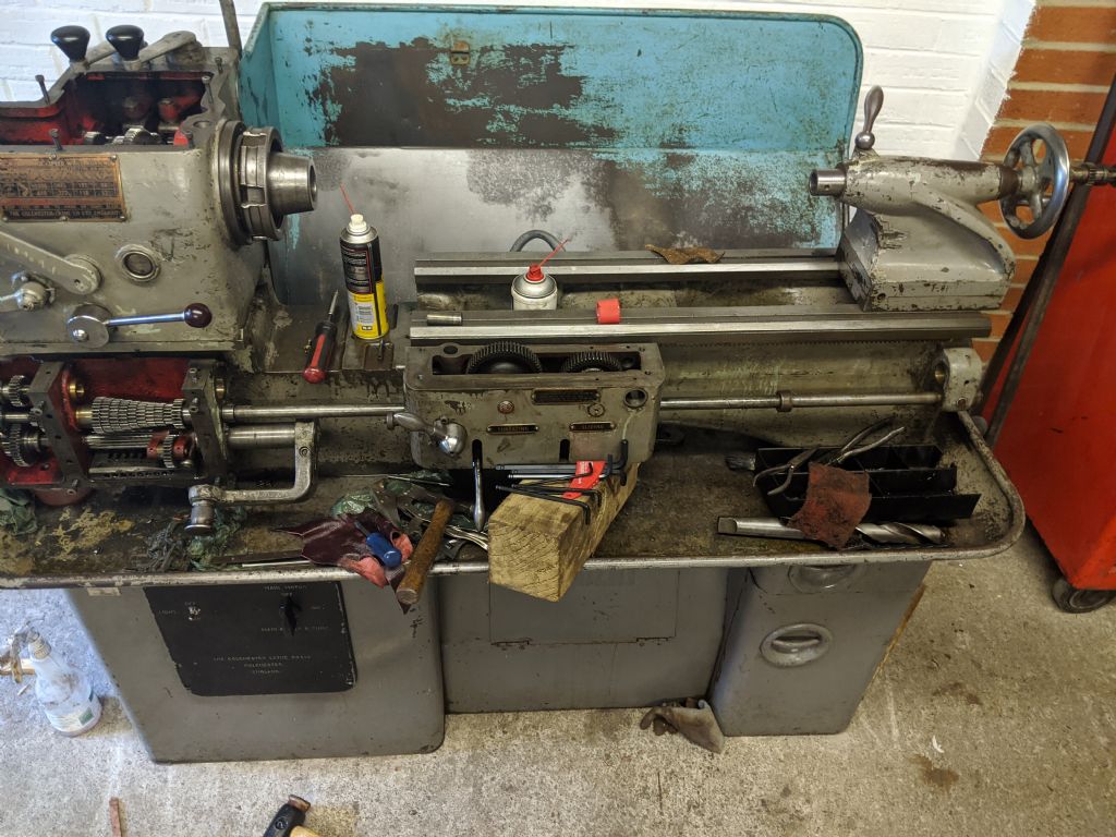

A little bit of progress today, although now I'm stuck

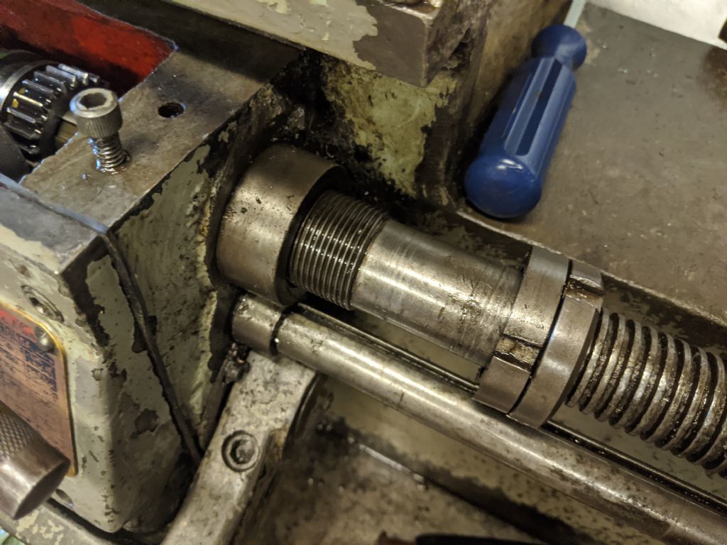

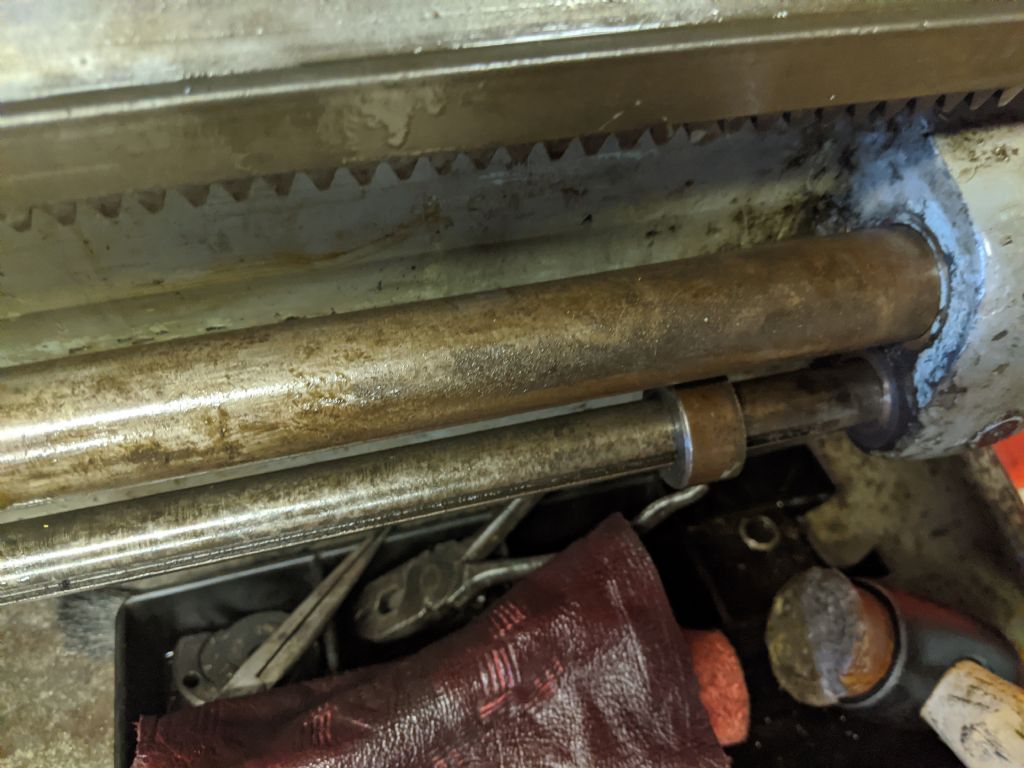

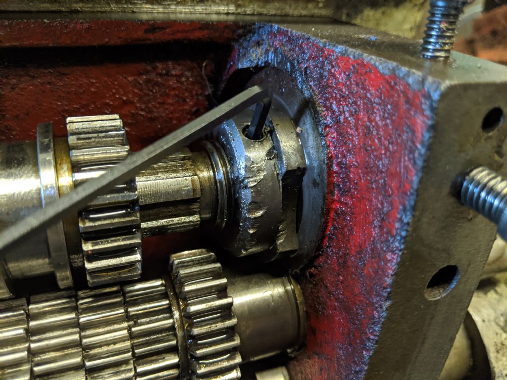

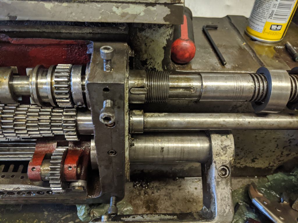

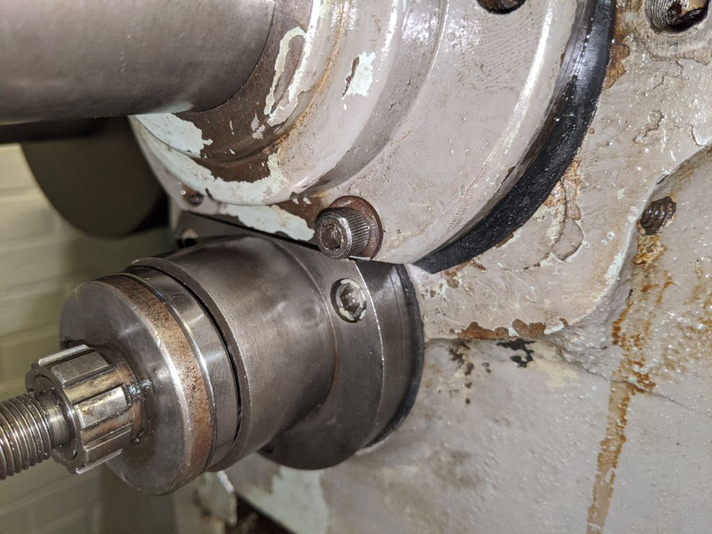

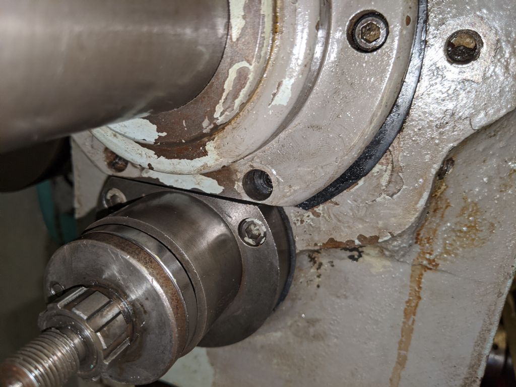

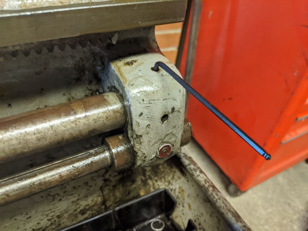

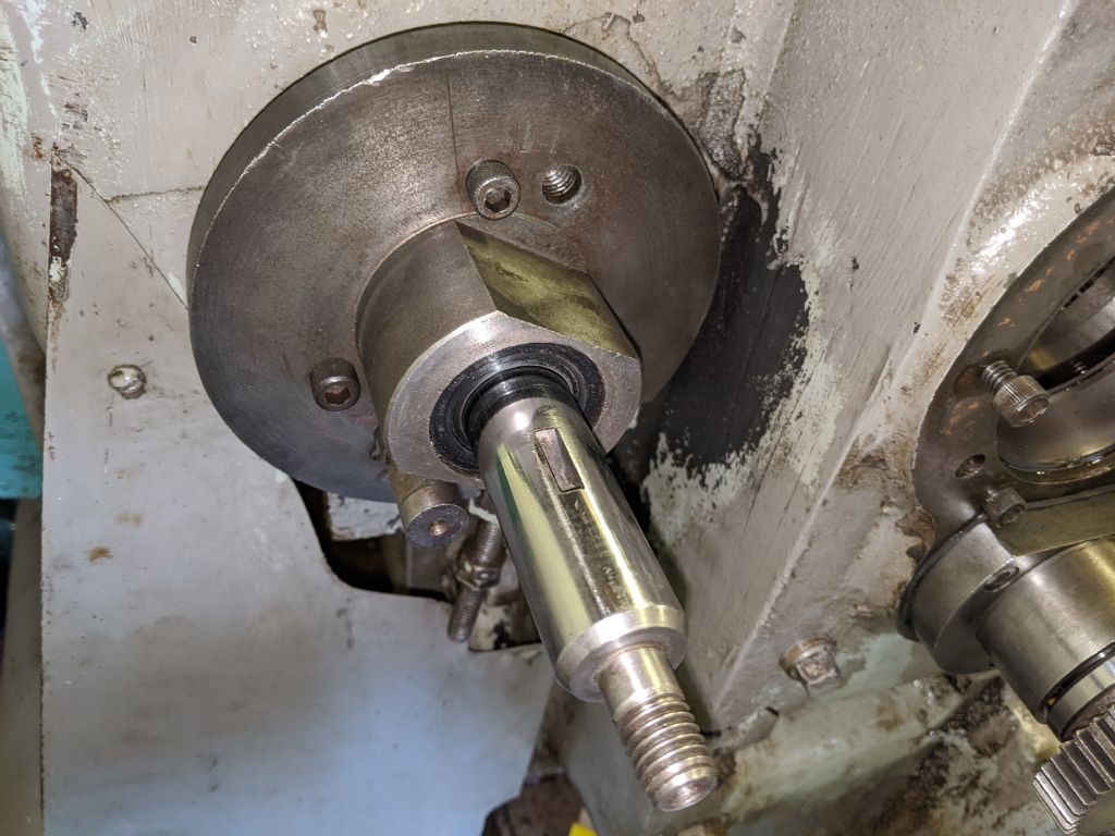

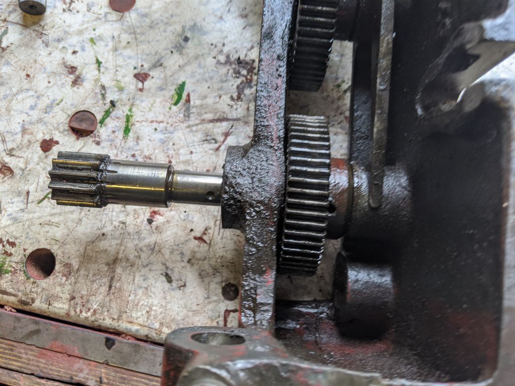

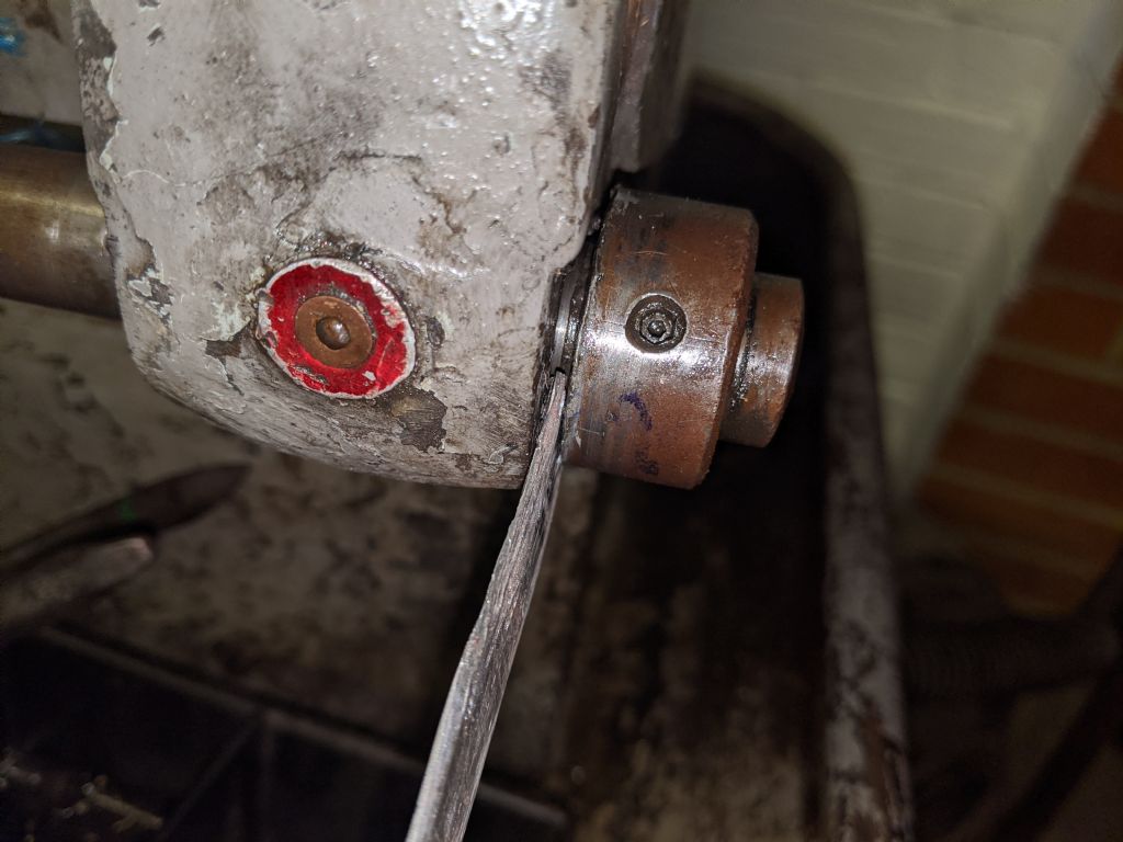

Getting the leadscrew out proved a bit more difficult. There's a step that Herman missed in his post so I didn't think to undo a screw and it left me just scratching my head for a while. Until I'd had a cup of tea and thought about it properly

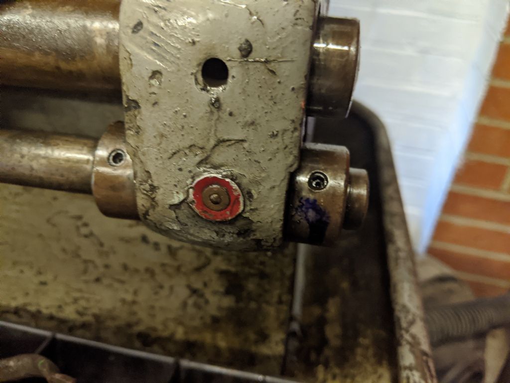

So the first step was to undo the collars. They came off quite easily, although I will clean the thread out and make sure they fit better when they go back on, as they were stiff in certain places and slacker in others.
Then my inner collar had a set screw instead of having slots like Hermans. I put a bolt in and used that to turn it a bit. The marks were already on the collar, so someone must have been in here before me. That's not to say I didn't leave some more...
Nothing I can't clean up before reassembly
At that point I went to the end and looked at the set screws down there. Thinking about this further, the grub screw only holds in the bushing, so shouldn't effect the leadscrews removal.
While I was down there I also removed the grub screws from the collars on the feed shaft. But, the outer one's set screw is stuck and the Allen key just spins. No good, but at least its the outside one rather than the inside one. The inside one came loose very easily
At that point I thought the leadscrew should have been free to move along a bit, but it would not move far. So I took a look at the shaft and thought that it was a bit dirty so I cleaned all the muck off. I plan to sand down the leadscrew for 370 hours to remove all the imperfections and then polish it until I can hang it in the bathroom and use it as a very small cylindrical mirror, as that's how all functional lathe parts should look! Bling must make it work better!
Anyway, joking aside, then I sat around for a while and had a break. I came back with a fresh perspective and tried to remove the screw in this gear first, resulting in the leadscrew coming out a bit, then i could unscrew the collar some more, then get the leadscrew out further and so on until the leadscrew was free!

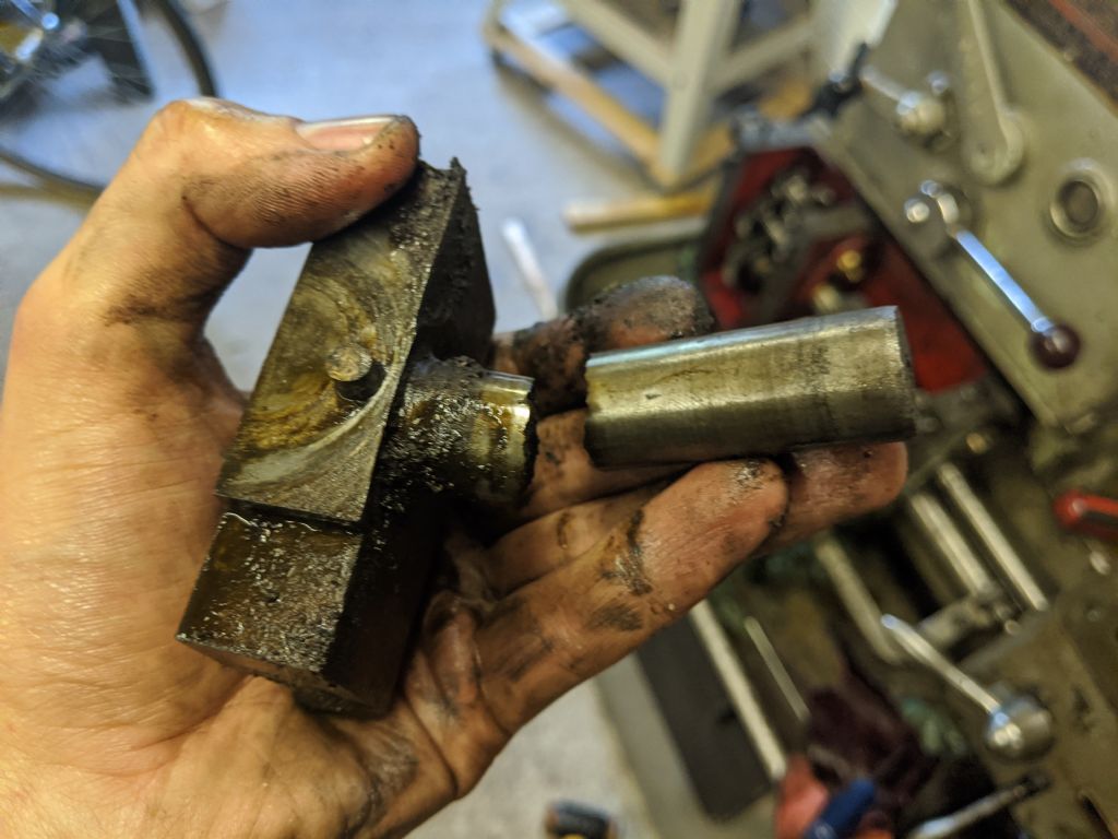

Having the leadscrew out allowed the half nut to drop out, since the shaft is shorter and broken. The feed shaft needs to come out to allow it to be reinstalled once fixed. The break lines up perfectly when its aligned
Definitely worthwhile taking it out, especially for a clean. Probably 2mm thick gunk at the bottom. Not good
Anyway so now I'm stuck. I cannot get the feed shaft out. It should just slide out. It will move about 2mm and then it just stops. It definitely feels spring-loaded like Hermans should have been, but I gave it a very good tug and I can't get it to budge. Any ideas? I've checked for pins and things like the later models have, but I haven't found anything.
However, I did find something coincidental. At the back of the gearbox, since the gears have been removed, I can now see that it says 5 AUG. Which may refer to the 5th of august, which happens to be my birthday. It probably doesn't mean that really, I can't imagine they'd date all their parts like that. In which case, what does the 5 AUG mean?

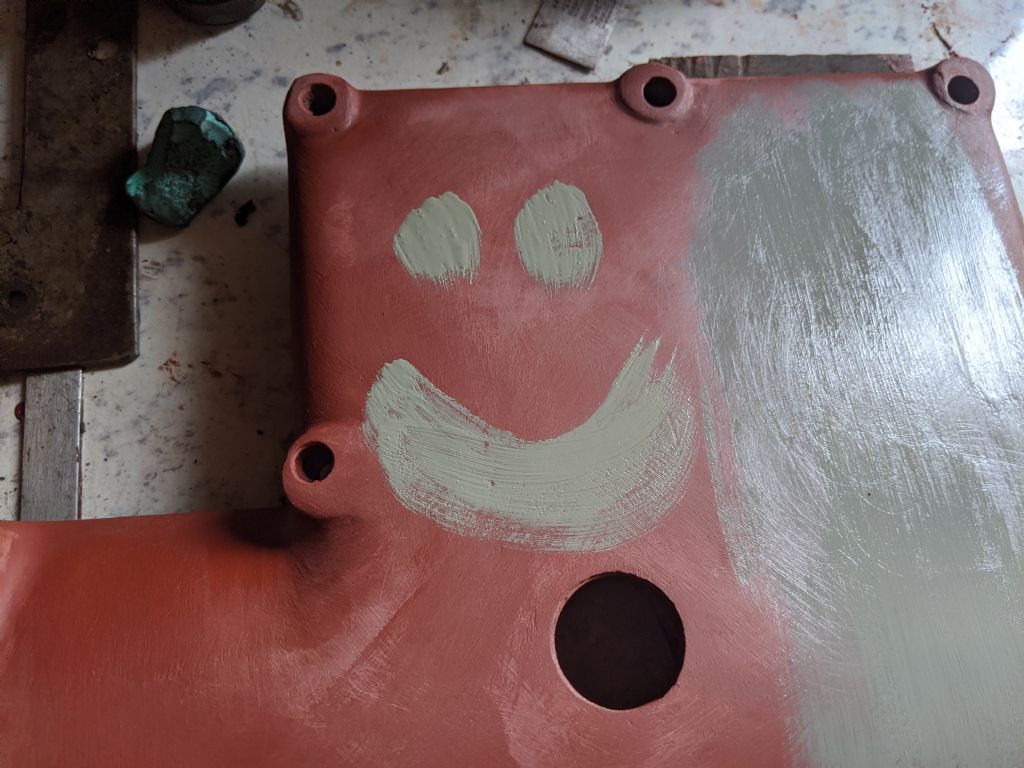

02/08/2020 14:02:56
Good news, followed by catastrophic news.

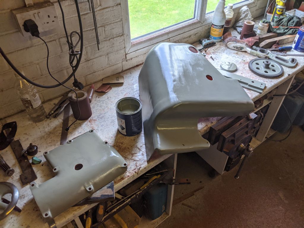

I finally got some paint on the parts, They aren't perfect, but a good start
Bad news after pictures. It might ruin your day. Hopefully the smiley paint face will soften the blow
Painting will need sanding down and spraying at some point, but I may as well get good coverage with a brush then worry about the finish on the last coat

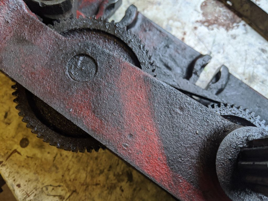

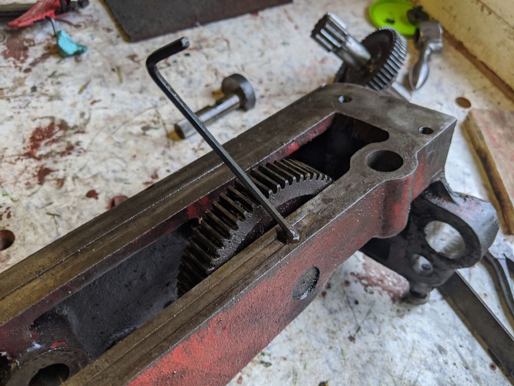

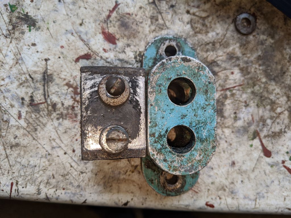

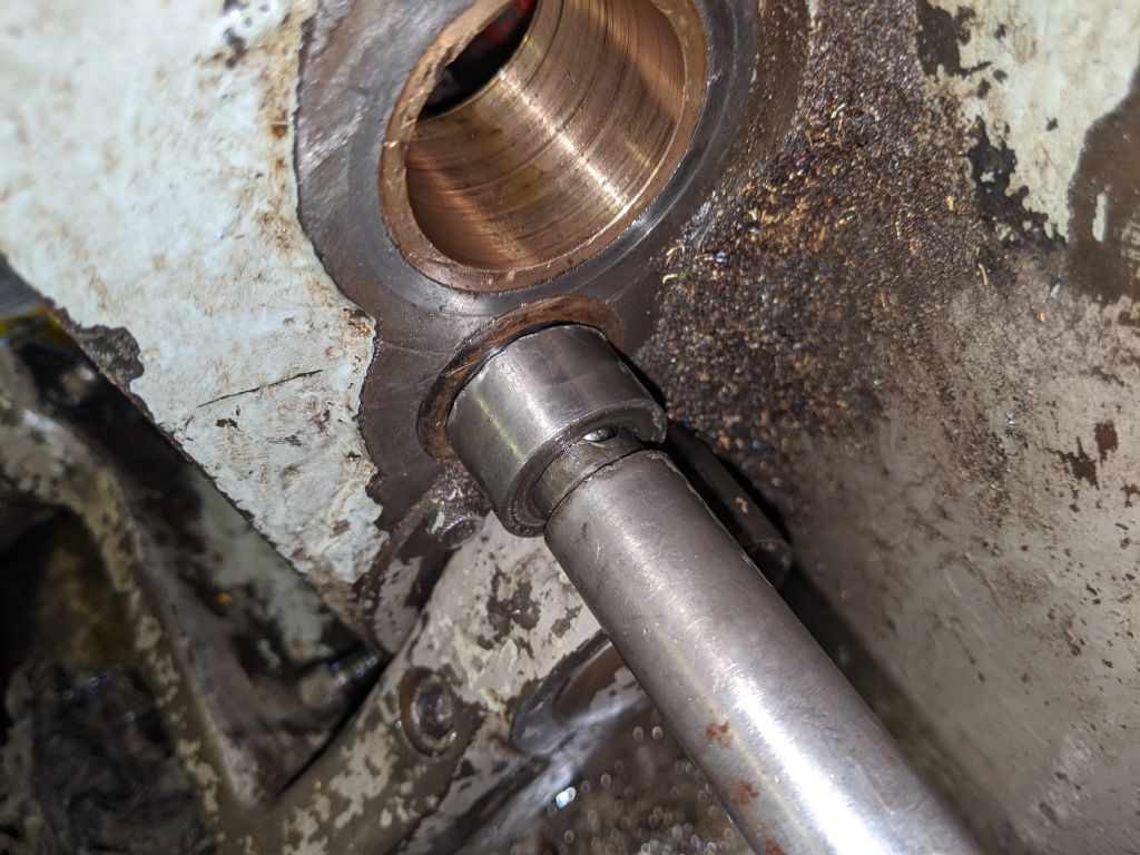

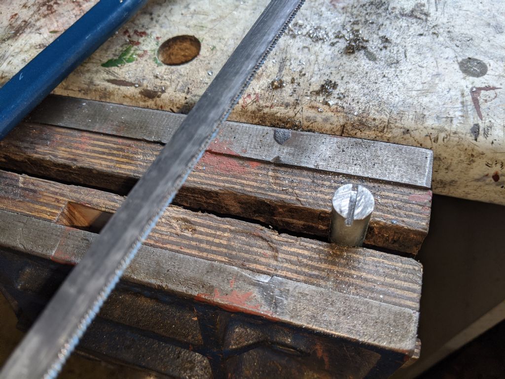

Now onto the bad news. As I said in the last post, i seemed to have messed up the threading lever when I took it off to polish it.
The lever has always been tricky, hard to engage and even harder to disengage. I finally know why.
It looks like at some point there has been a collision. Resulting in the shaft that the half nut traverses up and down with being sheared off. This is not good news.
I have been in here before messing around, but I never tried to take anything to pieces. And there is absolutely no way that in my use of the lathe that I have done this. I'd have heard it go.
Anyway, so now I really need some assistance. I would extremely appreciate any input
Firstly, I need to remove the apron fully. Is there a way to do that without taking the threading change gearbox to pieces? As I don't want to remove all of that.
As far as fixing it, my first thought would be to drill a locating pin through the center of each part, then brazing back together. Or whatever fixing method is best for cast iron.
If only I could have got Traci's half nut. I don't think colchester spares will be cheap, so I think fixing is the only option
Edit-My friend has an oxy-acetylene torch so I could try my hand at brazing. However, advice very much appreciated
Edited By Richard Kirkman 1 on 02/08/2020 14:13:56

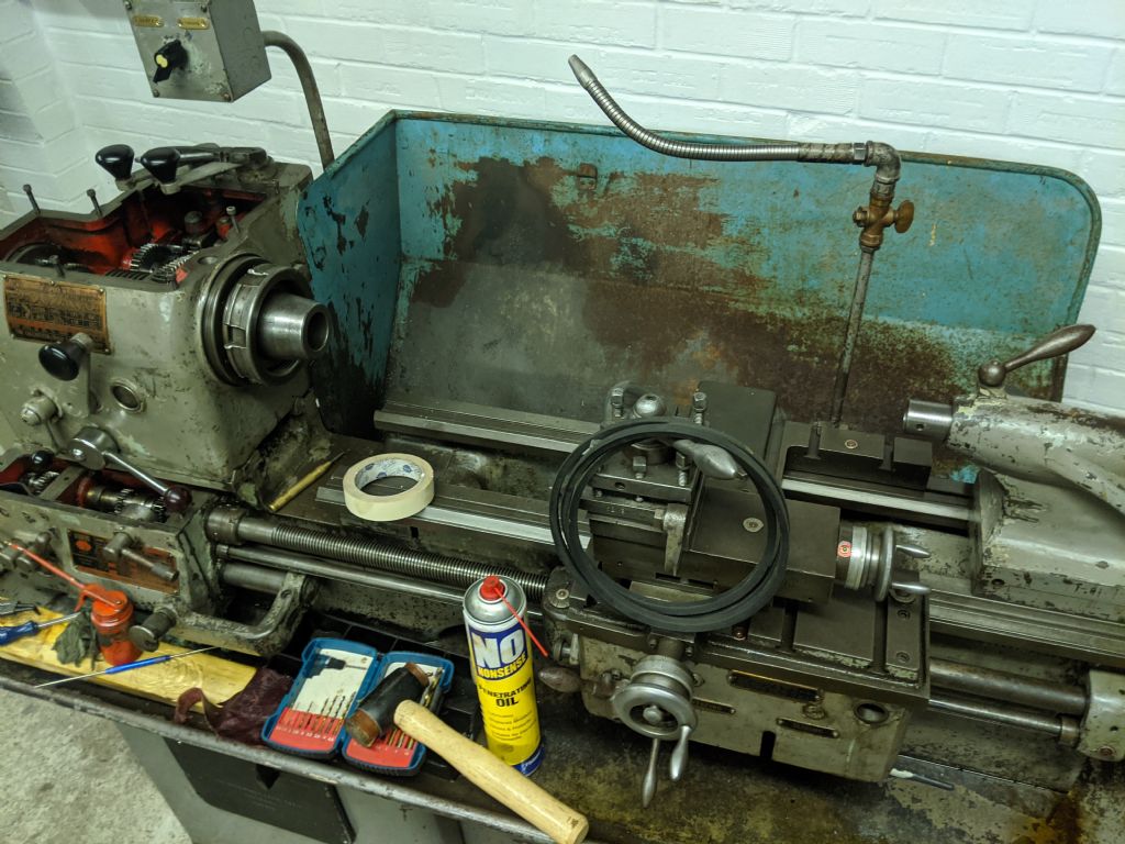

I'll do it properly next summer. Meanwhile, I need to do some turning! I may even fill up the coolant tank!

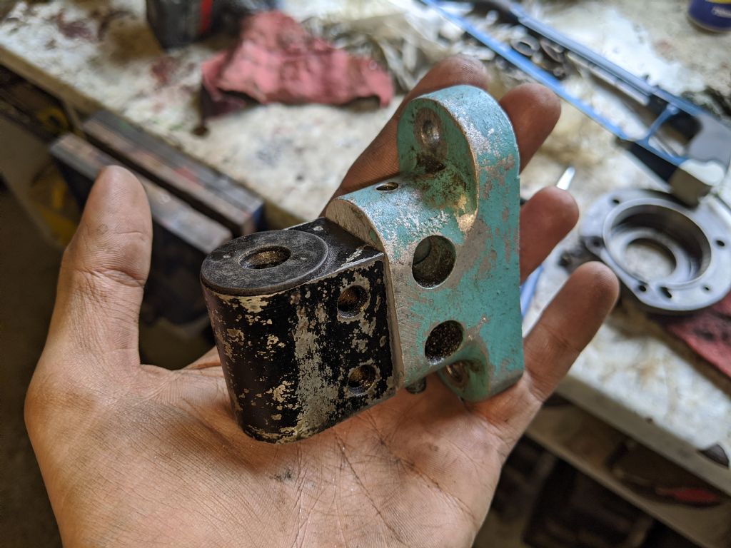

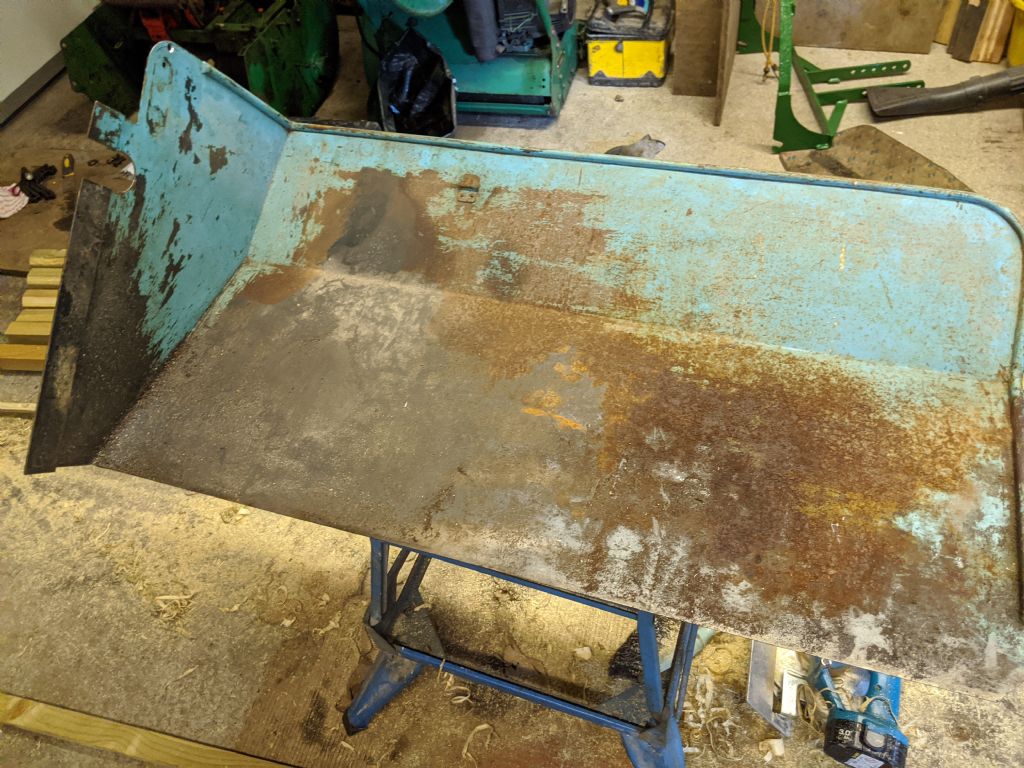

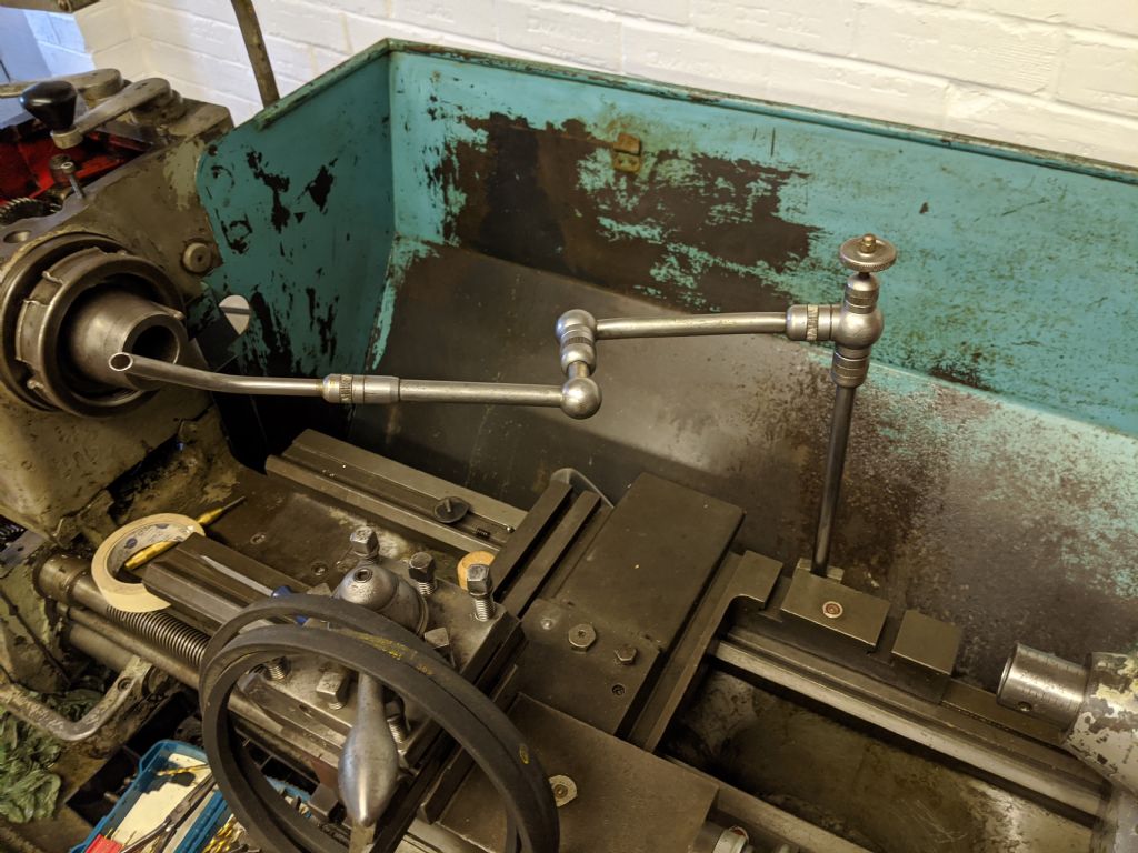

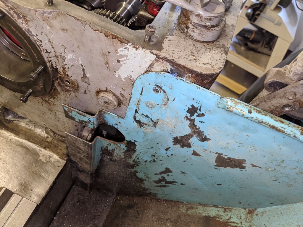

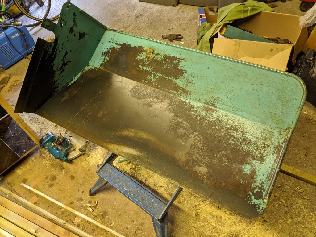

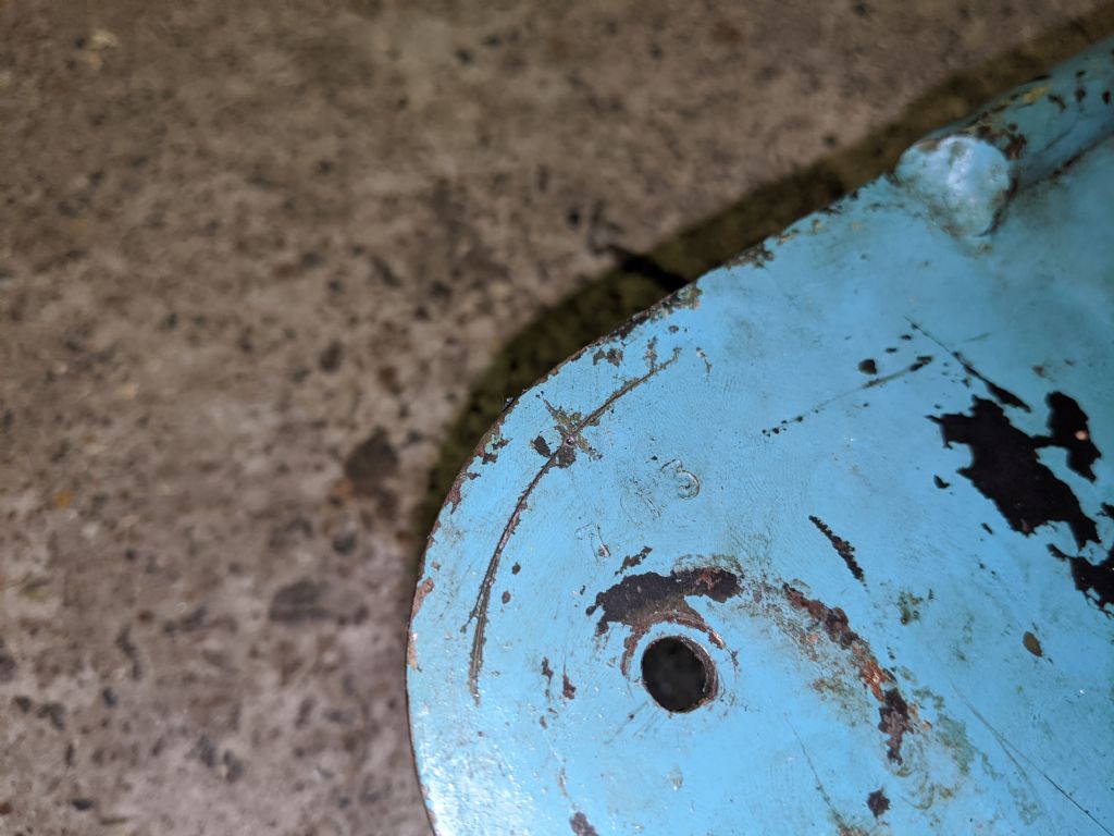

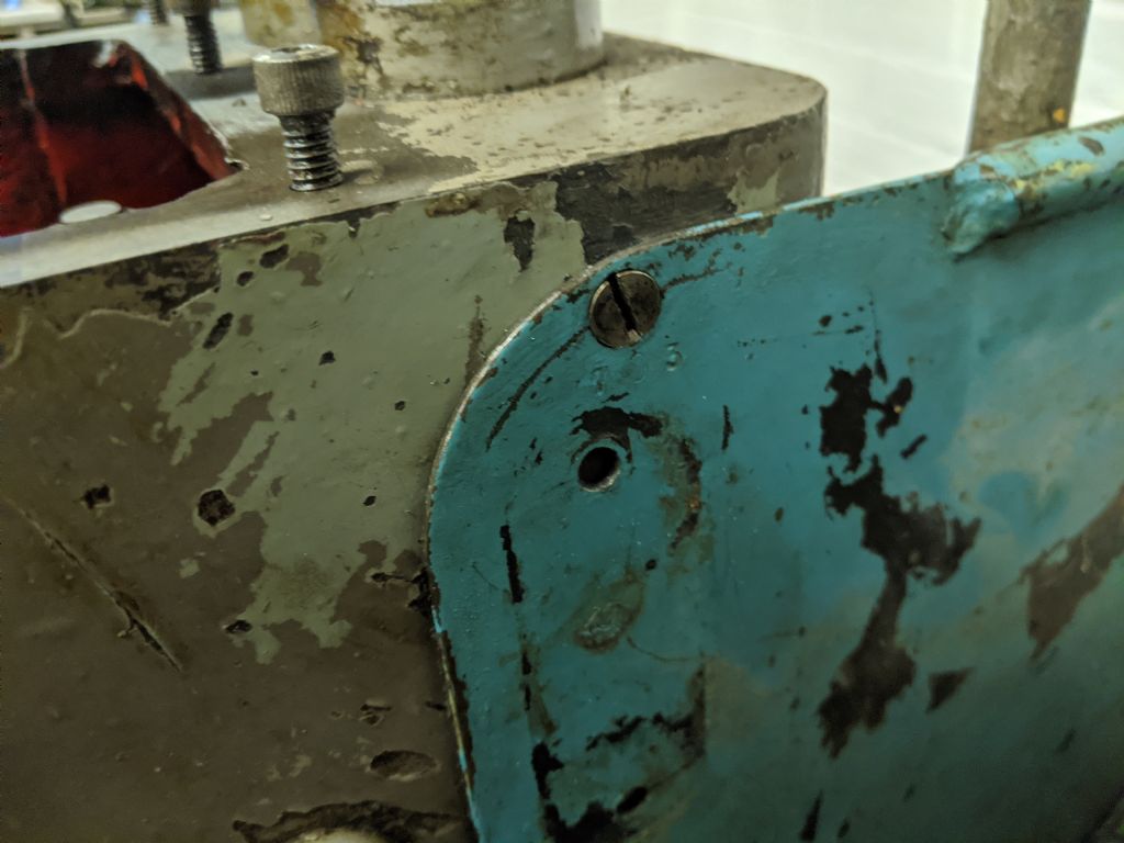

Little progress, but something. I got the splash guard cleaned up, or at least as much as I'm cleaning it up for now
Just wire brushed it and oiled it up so it hopefully won't rust any more before I paint it
Then I polished up and cleaned the new tap, since its an original one and my old one didn't seem very good. I like the new one more
I'm trying to get the other covers painted asap so I can reassemble fully and get the light mounts sorted. But I also need to take the apron to pieces to fit the new hand wheel and do some tinkering, since I seem to have messed up the threading lever when I took it off to polish it. Not good. I may have to fully disassemble it. We shall see tomorrow.

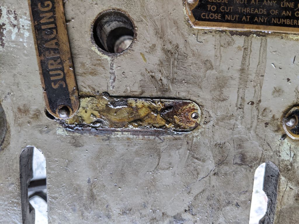

30/07/2020 21:46:47

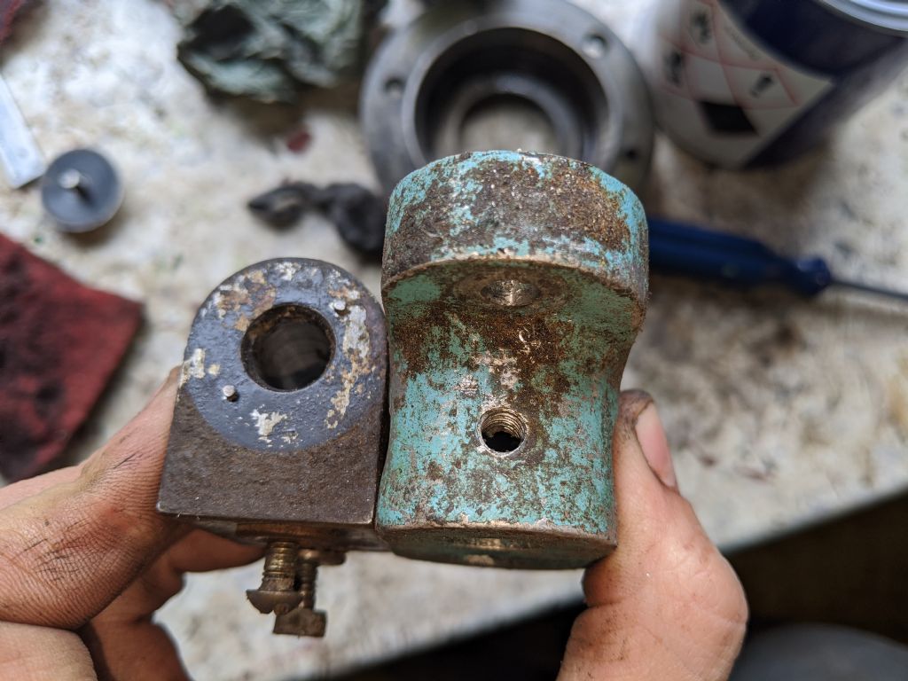

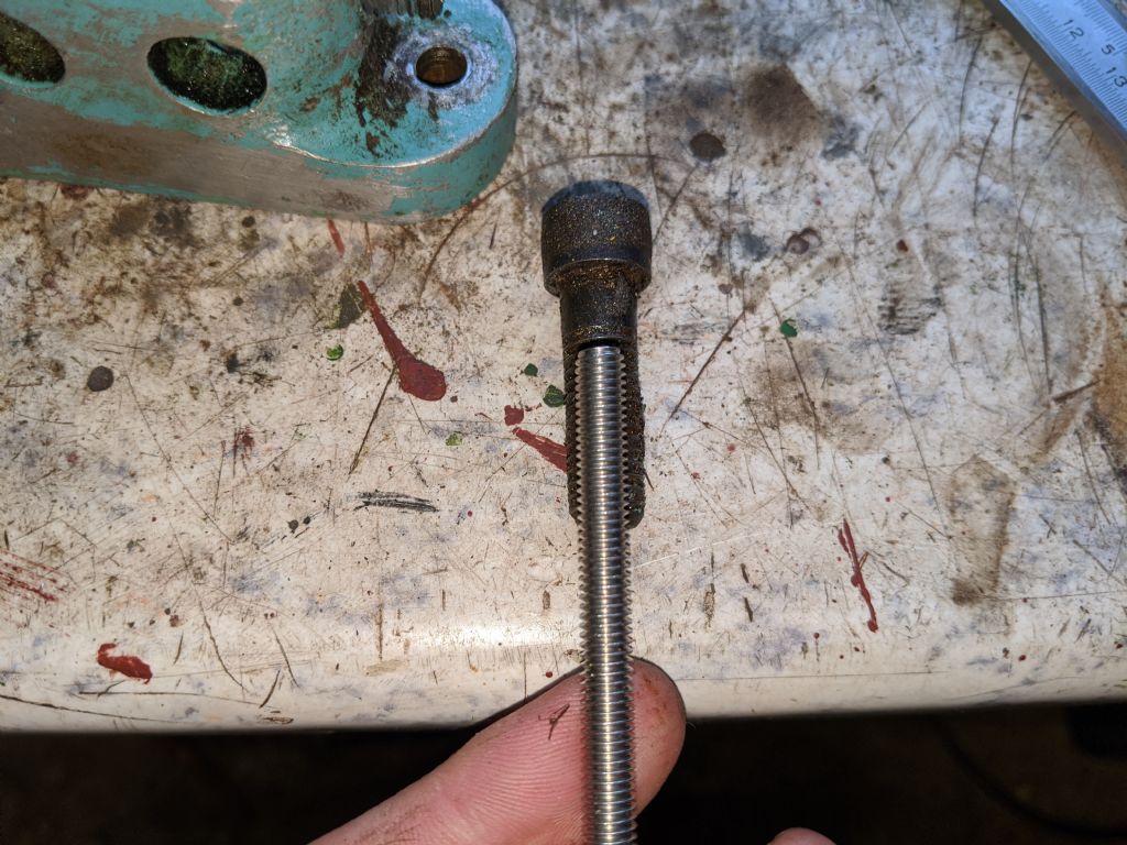

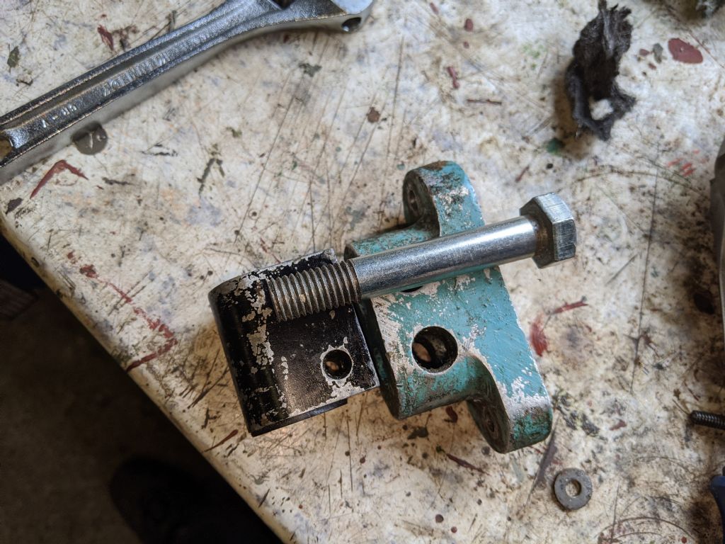

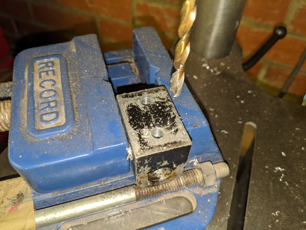

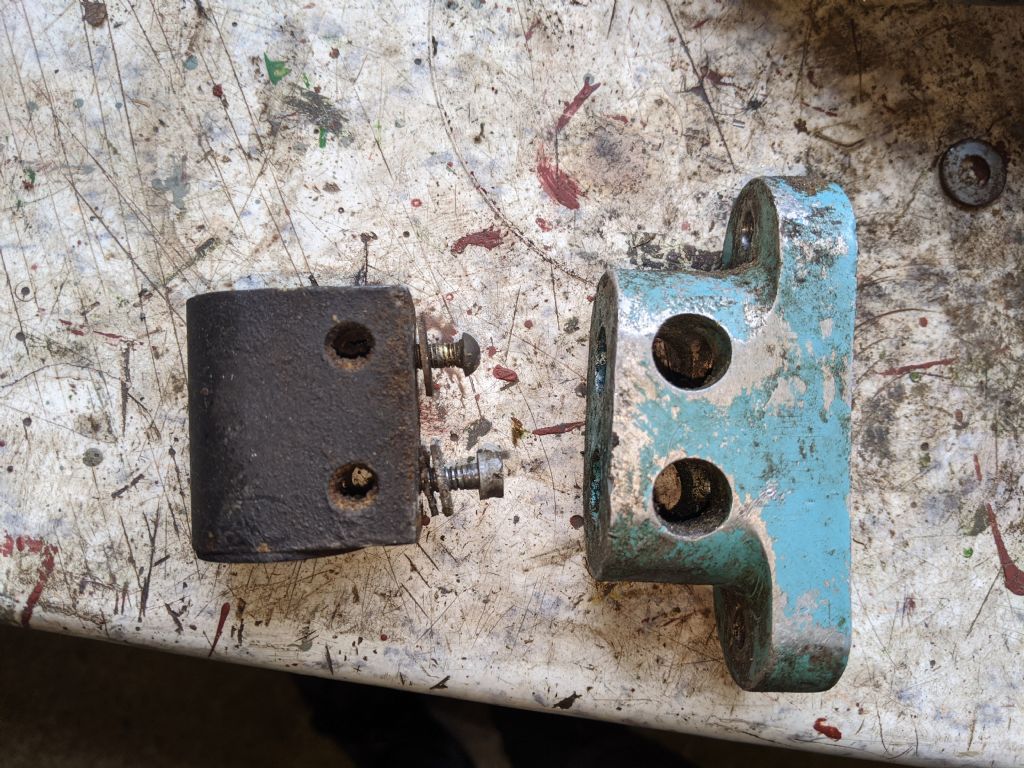

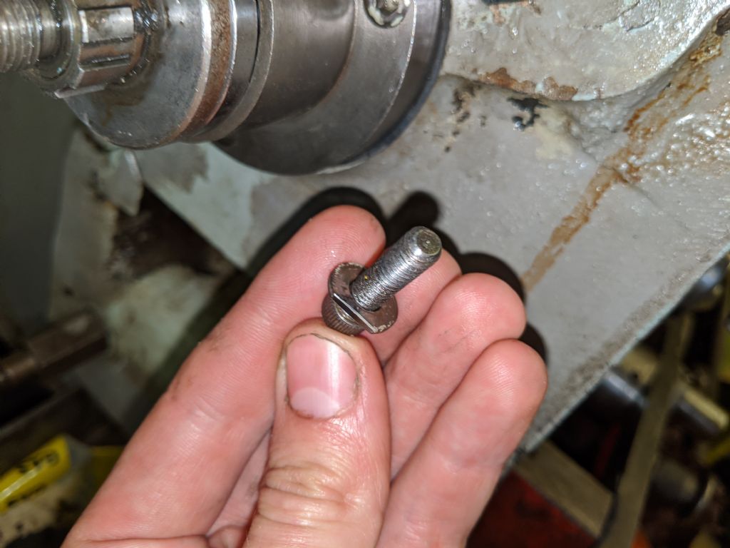

All sorted now, I just decided that It needed to fit, so I've made it fit. I'm not a fan of modifying parts, but there was no other option here. Apart from get a different one from Colchester spares
And very luckily the bolt I said I might have fitted perfectly
Simple, I just laid out my hole spacing, drilled and countersunk. Then I cut the bolt down to the right size
I think It looks very acceptable. Not out of the ordinary too much. Only someone who knows these machines would ever notice
Then I have a plan for mounting the light mount very easily. I plan to drill down a 3/8ths bolt and tap it M6, then I can secure it on from the back flush, and it can look nice with the hex head. There should be plenty of space for it. But I need a lathe to do it accurately. So onto more assembling
I've messaged a friend about potentially tig braze filling the broken out bit of casting, but meanwhile I am just using one of the longer bolts and a washer that I made fit. This holds the gasket so it wont move, so presumably It should seal alright. Only time will tell

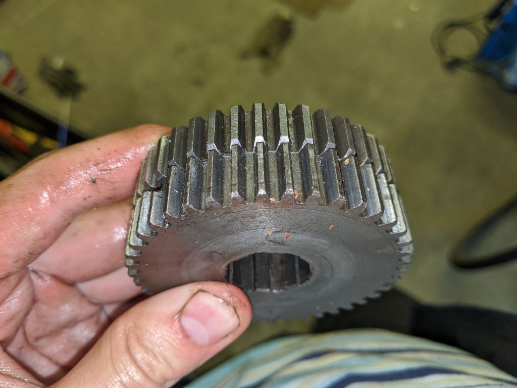

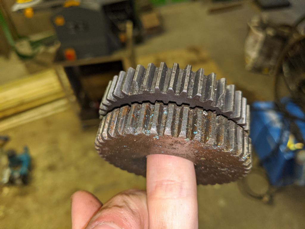

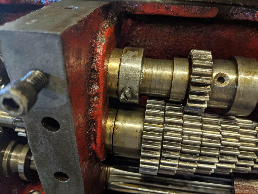

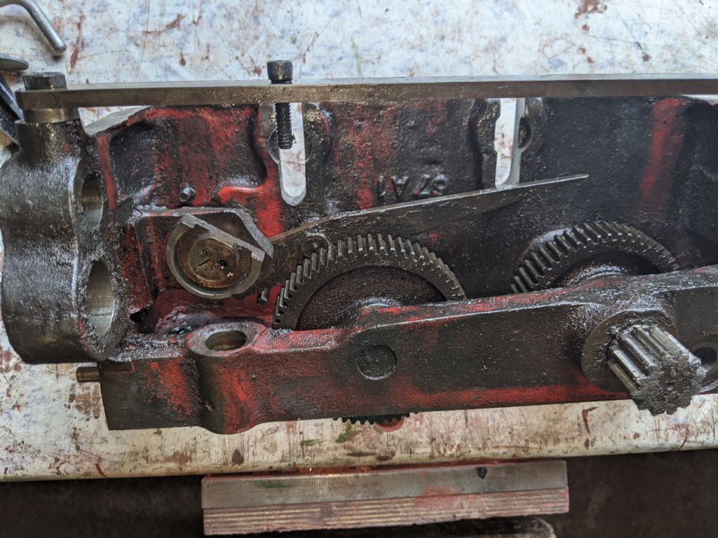

Then comes the question of gearing. The gear that fits on that lower shaft has 2 teeth that are partially damaged. The spare one has all its teeth intact. But, the teeth look a little bit bigger. Is this just wear and will I be okay to use it? Or should I swap all the gears on the end of the lathe to make sure they're all the same.
It's not a big difference and they seem to mesh okay
The reverse forward switch needs a mount onto the splash guard too, otherwise the whole thing is too wobbly. Not too sure how I'll do that yet as I don't want to put a hole into the splash guard and just put a bolt and nut on the other side like it was. Perhaps welding a little bit on for a mount would be good

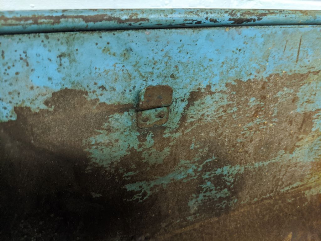

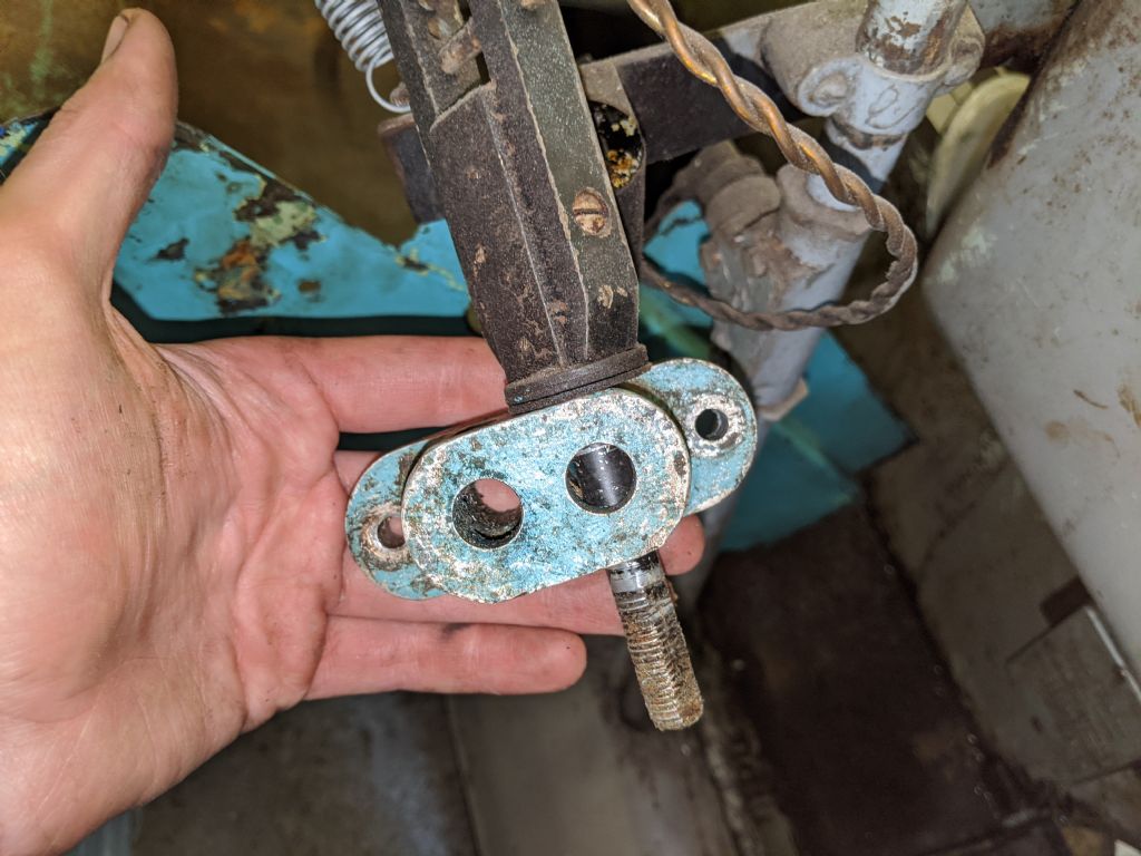

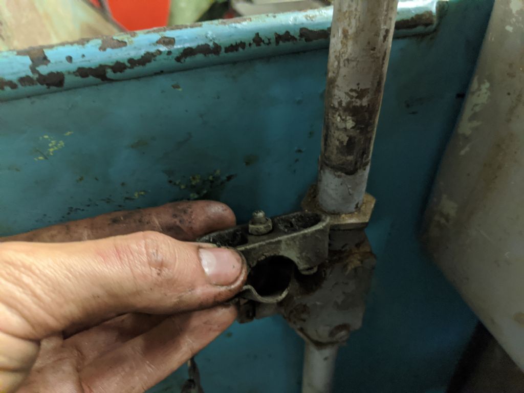

Then, a quick question. What is this little hook/tag for?

I've looked at the splash back this morning. Not great news, but problems to be solved!
The mounting hole does not line up conviniently.
I do not particularly want to put any holes into the headstock, and I'd like to put as few holes as possible into the splash back.
I started off by removing the chuck guard which had been added at some point. I do not plan on reinstalling it. It just gets in the way.
This is how the light was mounted. As far as I know, the light was attached to the back of the headstock orignally. But I don't have any holes for that, so i will try to use the splash back's mount. It needs a good clean. Everything does
Obviously not in the right orientation, but the hole size is right at least
Since all that was out of the way, I looked at the mounting of the splashback. The holes don't line up perfectly, so some work is going to need doing
The pictures make it look closer, but it's probably a good half-inch away.
So I began to work on fitting the light mount together in a fashion that would work nicely.
The holes lined up, So I just had to come up with a way to get them mounted together. Luckily the blue bit had some holes for set screws, and I found some set screws the right size in the spare parts!
So I drilled out to 10.2mm then tapped M12. Cut the bolts off and put slots in (with two hacksaw blades. Thanks for the tip Phil, it worked very well)
Fully mounted.
So now I just need to mount the blue bit to the splash back and the splash back to the headstock! If only the parts could have come from an identical lathe!
Edited By Richard Kirkman 1 on 30/07/2020 14:12:37

However I did get 2 parts back onto the lathe, both the oil seals are definitely in tight with their silicon gasket. I'm praying for no more leaks...
The shaft with the gear on actually went back in a lot easier than it came out! It's got a gasket installed with it now, so that should reduce the chances of leaks even further.
As it turns out, the yellow bearing cover replacement part that I wanted is the wrong size. The last of the 3 mounting holes doesn't line up, so i'll have to fix the old one somehow

Mid day update, More progress.
I tapped the end of the shaft to m10 as there was enough meat there. It was over the drill size however, so I tapped extra deep so there is more engagement so the pressure is more spread out. I also used a bolt that is twice or three times the length. So that will fit nicely now.
I couldn't see on the diagrams in the manual how this was meant to fit as it was a bit complicated as the model was meant to have the forward reverse switch going through this shaft too? Or at least it was in the manual
Then I got onto cleaning up the handle and shaft properly. The little button at the front came off accidentally. But it made cleaning a lot easier. It was quite scored so I put it in the drill press and cleaned it up a bit. Nothing too extreme. I don't see any point making it perfect as it would take a very long time, and then I'd have to get everything perfect
Then I gave the old ball a bit of a polish on a very fine buffing wheel with some very high grade compound. It shined up nicely. Once again, not removing the dents and scratches, but just making it look a little bit better.
Then It's all done, Finally a satisfying click instead of a sloppy handle! I believe the feel of the machine is very important. The better it feels to use, the more I'll want to use it!
Upside down, but still shows the same thing. The mount for my light isn't original, but the holes seem to line up for the mount. So I will probably need to machine something to make it fit nicely. I'm not too sure how it's meant to be done. Does anyone have any pictures of this?
Then I moved back onto the Apron wheel. A little more wire wheeling and it was looking good enough to buff. I can't see myself in it, so it's safe. But it definitely looks the part
Then I stripped all the paint, cleaned it and put a coat of red oxide primer onto it.
