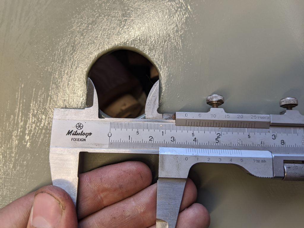

Hello all, I could do with some help
I have a wheel from a belt sander I've been rebuilding, however, the wheels bore is too large and not concentric with the outside surface so I get about 10 thou runout at best after I've shimmed it. Not great when it's spinning very fast.
Video of runout
I'd like to bore the center out, then plug it and rebore it properly so everything is concentric.
I have a slug of around 40mm aluminium just the right size to do so, but before I jump in and start making chips I just want to ask about the fit. The motor shaft is 24mm so the hole will be reamed to that at the end.
I've looked in the zeus book about what to do, but having never done it before I could do with a second, third or more opinions.
If I want the plug to press in and never come out again, what sort of dimensions should I aim for?
Would it be better to drill out the majority of the center of the plug as well?
Will the center being removed after effect the fit?
Thanks

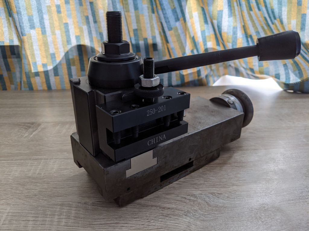

Thread: Colchester Student Mk1 Won't Start
05/06/2021 11:12:18
Quick update

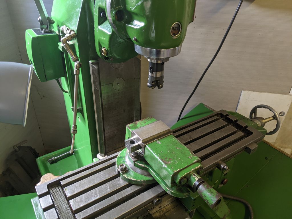

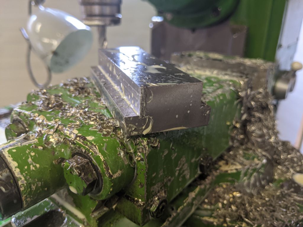

I no longer have access to a milling machine at home, so I enlisted the help of Phil to machine me a 304 stainless steel t-nut for the top slide so I can mount the new tool post.
I did initially go to the university engineering workshop to ask for their help but they were not interested as it was hard steel and they wouldn't let me in to do it either.
So, Phil helped me out greatly. Big thanks to Phil for all of his help

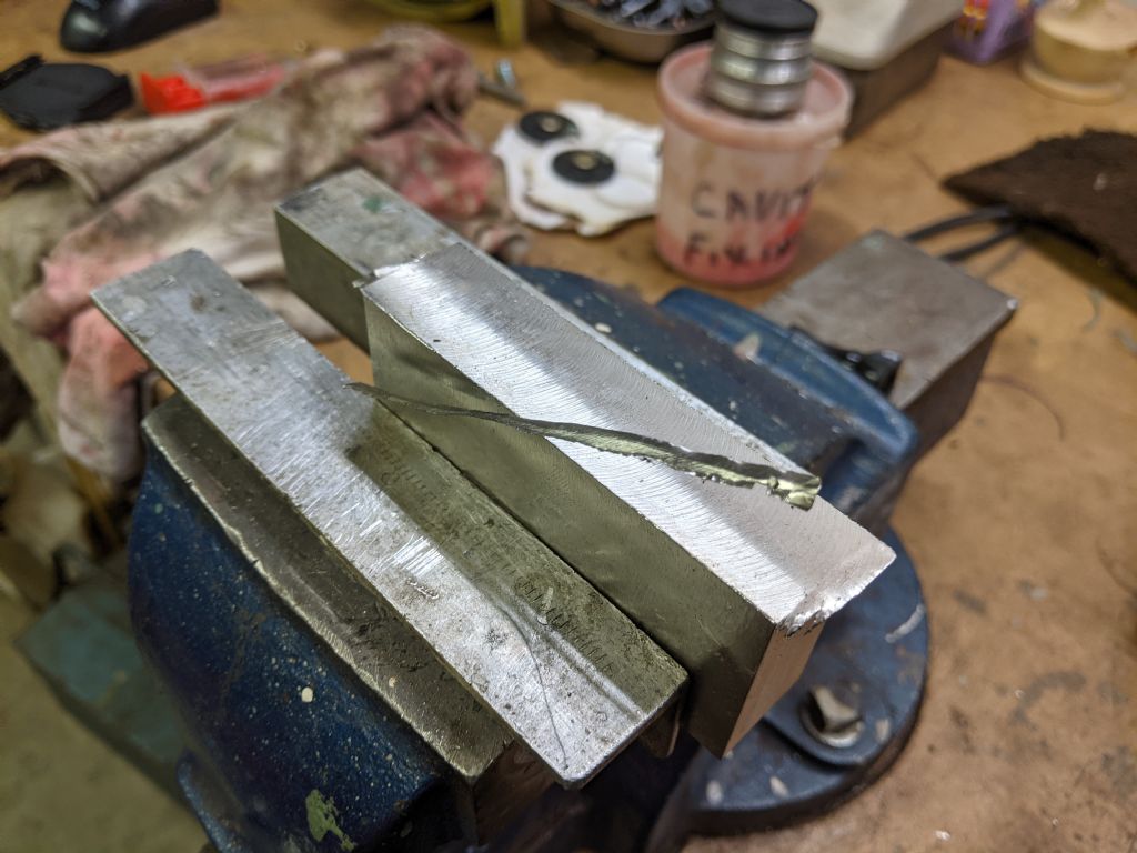

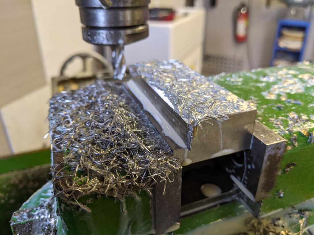

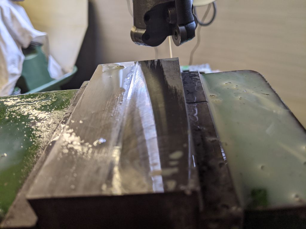

304 is a pretty tough steel, especially for an unexperienced person like me, but we made the best of it. We started using a face mill to make the block square, then we took it to size.
Cleaning it up gave quite a nice finish. Although I did get some chatter later on.

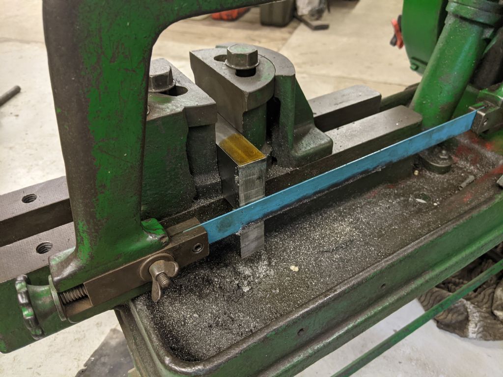

The end dimension had 10mm to come off, so it was much quicker to cut it off with Phils very nice mechanical hacksaw.
Some faces had 1mm or two to come off, so It took me quite a while when taking 0.2mm cuts. The steel got some very nasty burrs too, if that's the right word when they're so large! I presume that'd due to the steel being hard and due to my milling direction.

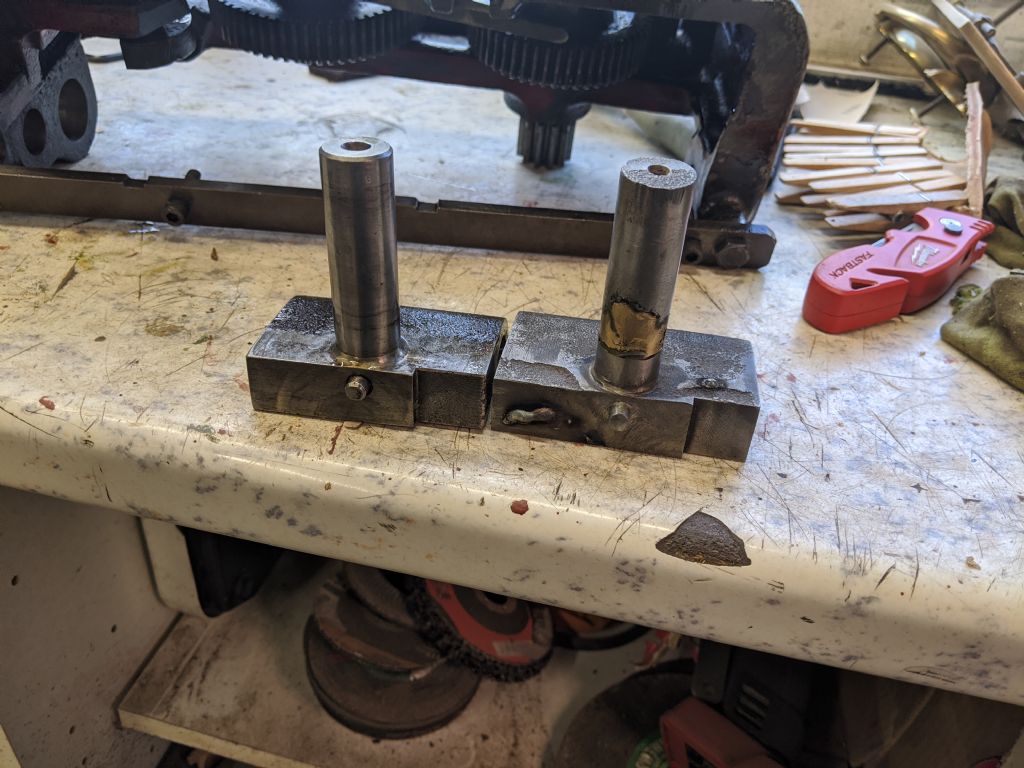

Then I cautiously moved onto using a hss endmill to cut in the slots. After 30 passes of 0.2mm cuts we has a 6mm recess for one side, then the other side was done.
The hss worked surprisingly well. I had bought a carbide endmill to use, but it wouldn't fit in any of Phils chucks.

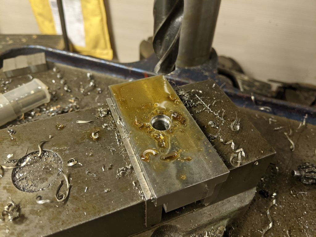

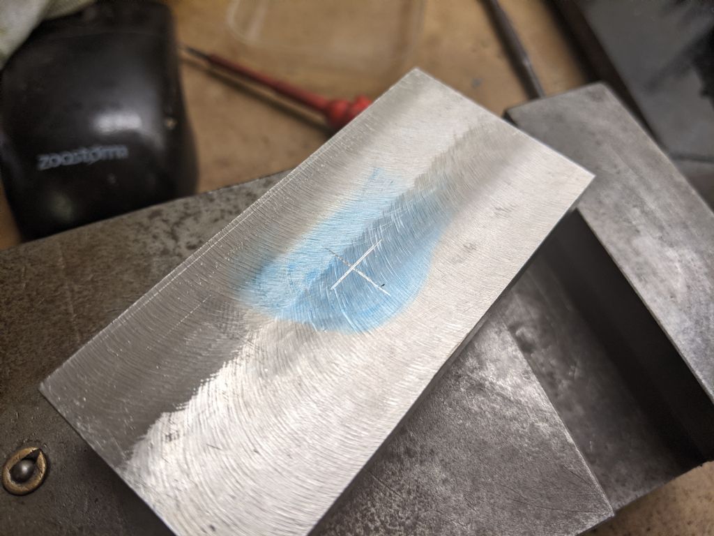

Now to size, it was time to deburr and drill the hole

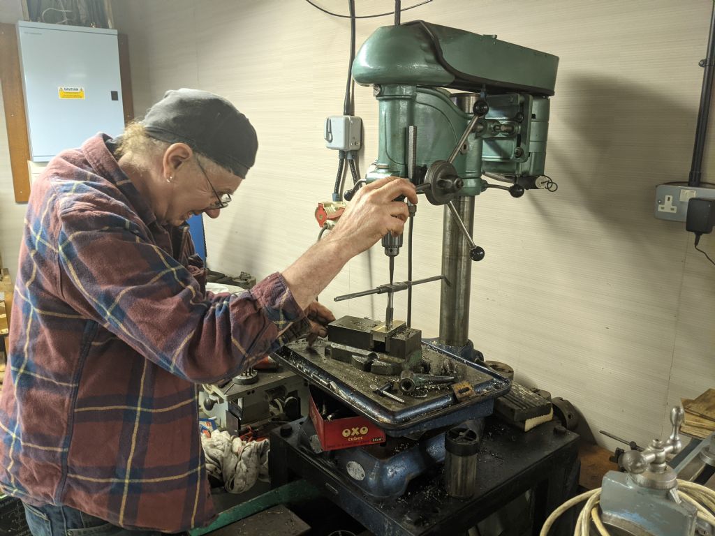

The drill size was stepped up very gradually as the metal is tough and we didn't want to work harden it at all.

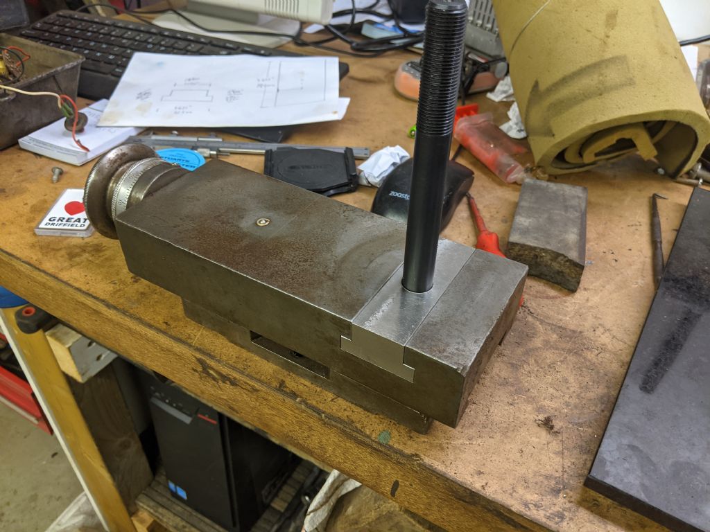

Then we got the 5/8ths sae tap to go in the hole and lead it in using the drill press to ensure it was square
The tapping was slow but worked well with lots of lubrication. But it all went smoothly from that point. A very nice fit for a novice like me! Room for improvement in the future, but I'm happy.
Tool post fitted. I can't decide if I'll turn down the extra thread on the end. It doesn't add any value, but who knows if I'll need it in the future.
Next step is to get back home from university and disassembly everything to clean and get parts from both top slides to pick the best of each. Then onto some turning!
Thanks again to Phil for his time and help, if you want to see more there will be some footage of the milling on his Youtube channel.

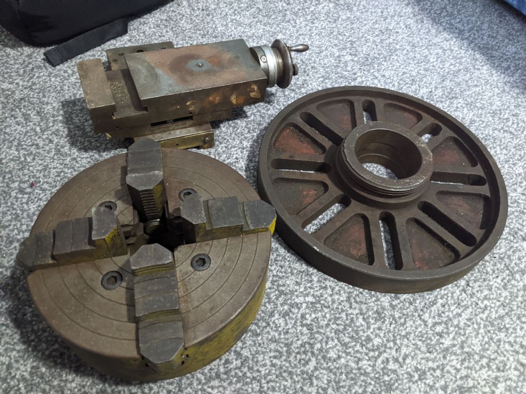

I hope everyone is well.
I seem to have acquired a few new toys. I saw these pop up in Grimsby and the seller offered to deliver them to Hull for a very reasonable price. Not extremely cheap, but I'm very happy.
Now I won't have to cut up my 4-way tool post in order to attach a QCTP. Hopefully, there will be a fun build making the T bar to go in the slot and making the mounting post(depending on if the QCTP comes with one) I'm considering this one. Alongside this being a nice upgrade for the lathe, my topslide is quite worn and is easy to turn at one end, and very difficult to turn at the other, so this should be an all-around improvement. I'll take the best parts from each and put them together.
Arc QCTP
I didn't really need the 8 Inch 4 jaw, but it's not often I see them come up, and for the price, it was worth it. The faceplate may come in handy at some point as well. Plus it'll be fun to clean and paint them both.

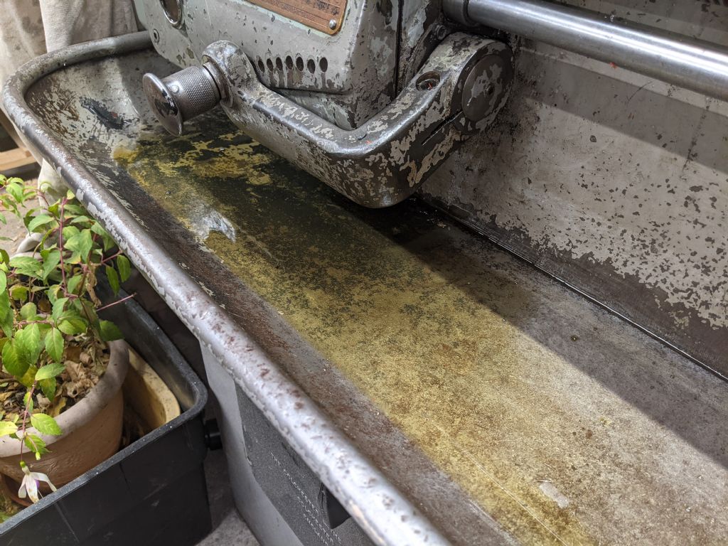

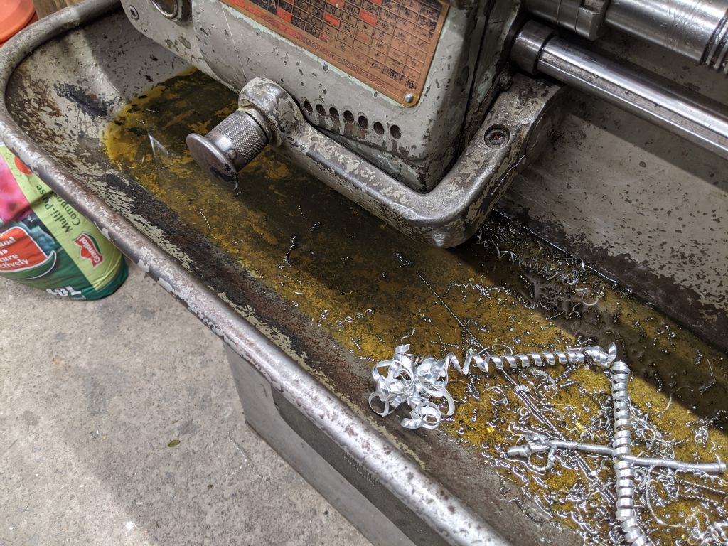

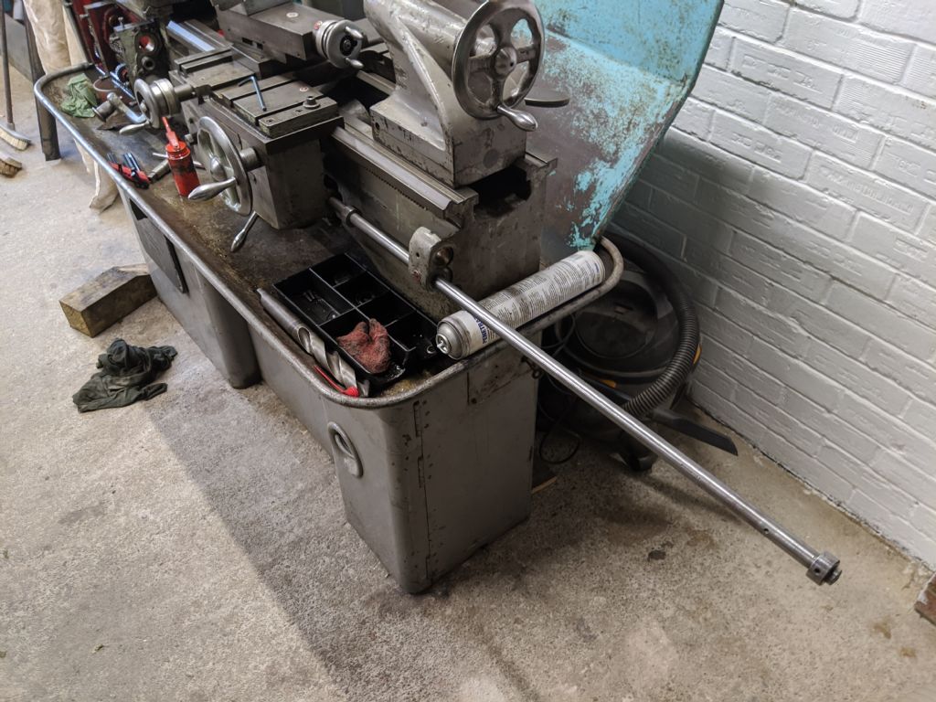

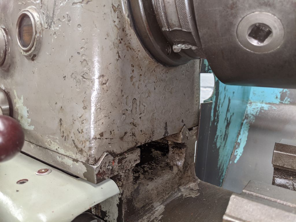

As for today's progress, I've attempted to tame the leak.
This was the leak when I got home
And this was the leak today. Much more oil
I suspect the bolts and things have shrunk slightly due to the colder temperature in the garage. Alongside using the lathe heating up the oil will increase its viscosity so it'll leak faster.

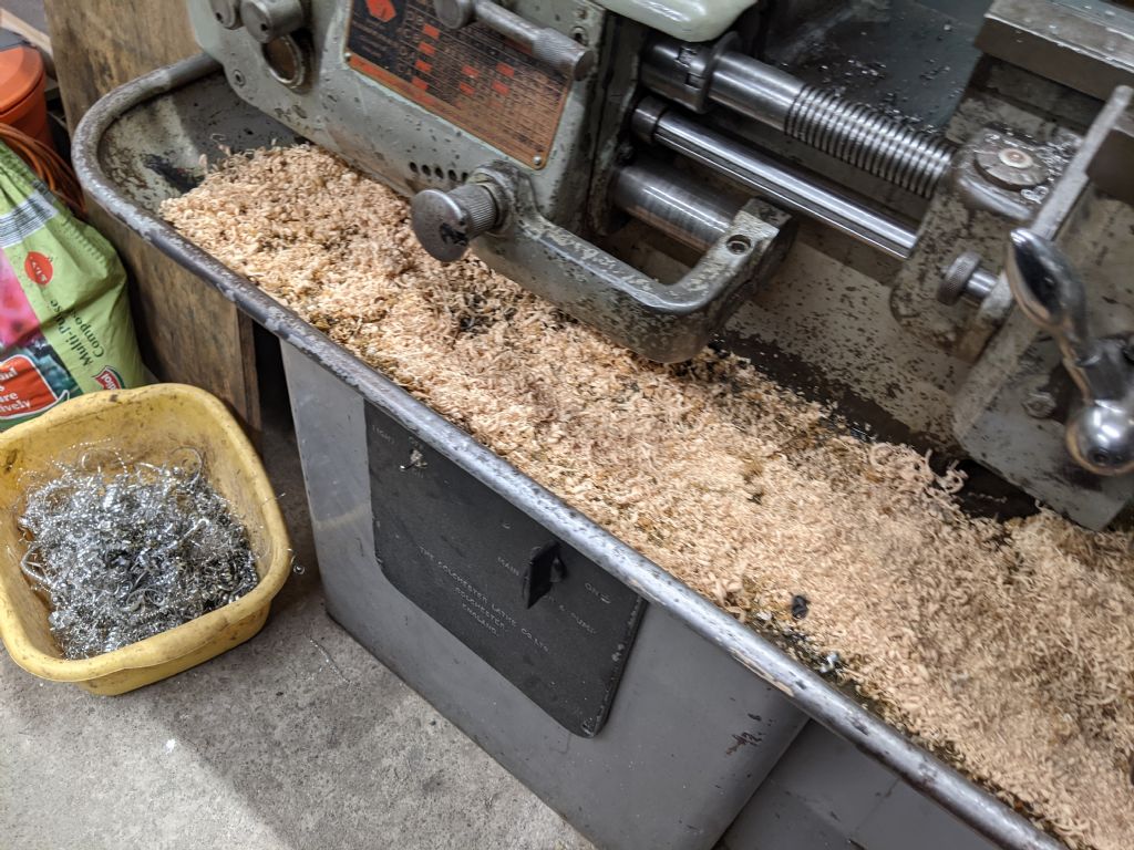

Luckily I have been doing some wood turning, so it was very easy to mop up the oil. I haven't used this method before, I was surprised how well it worked with nice dry shavings. Very minimal mess!

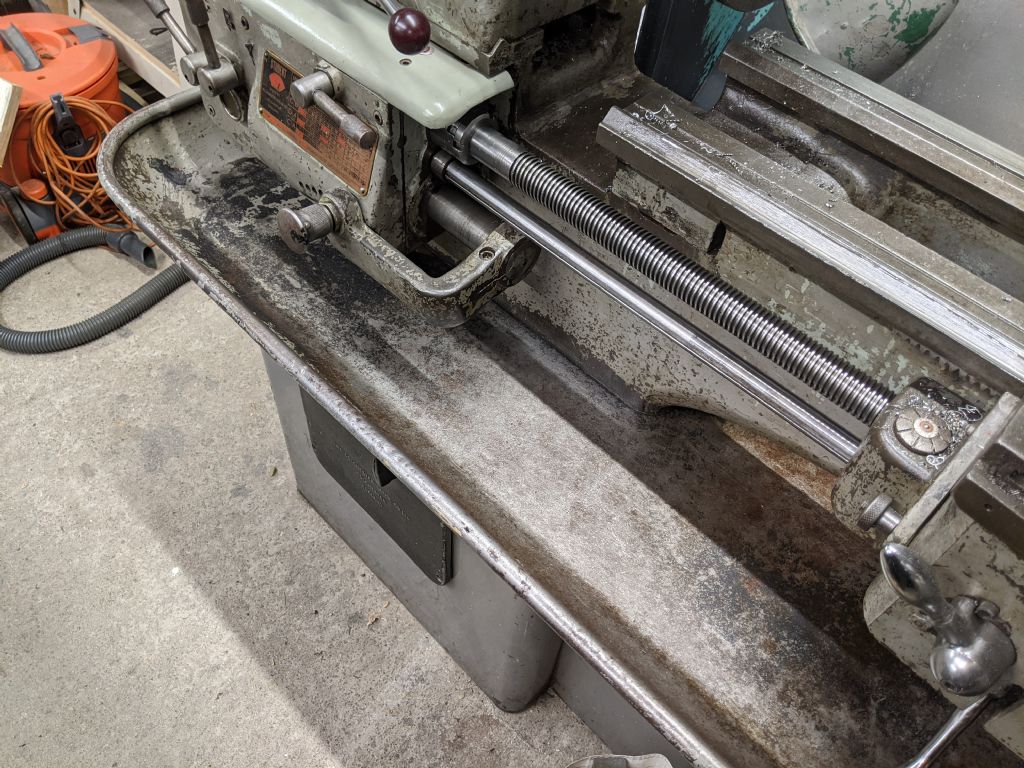

All clean once again. Much easier to see future leaks!

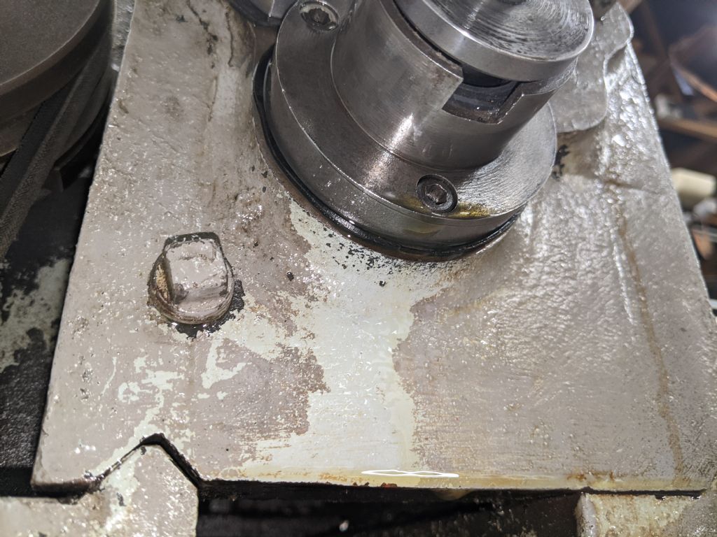

So once it was all cleaned I went to where I suspected the leak was coming from
The bolts holding these gaskets tight were not fully tightened as snugly as they should be. So I have just tightened them up a little more. Still not overly tight, but I think they're good now
I checked to see if the oil seal in there had leaked as well, but it seemed dry when I stuck my finger in the slot. Very surprising. It looks like I've made it work.

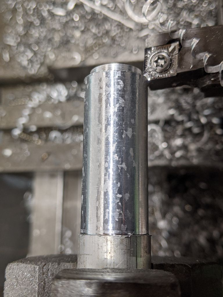

Me thinks those are oxidized aluminium. Was the raw stock stored in a sealed container of sorts?
It was just some 20mm diameter. I didn't think oxidization would have penetrated that deep? That was immediately after a cut of around 1mm from the diameter. The raw stock is just kept on a shelf in the garage. I've not seen it on the other aluminium I've been turning. But I don't know what type this aluminium is, I was given it when I went to Scarborough.

Speaking of which, I did a bit more turning today, just a little aluminium for a project I'm working on (some incense burners made from wood, but need metal inserts to hold the incense)
Anyway, when I was turning I did a finishing cut with my cutter and it produced a lovely surface finish, as do most cuts on aluminium. However, I saw imperfections in the surface finish. Having studied metallic structures at university I really should know what this is. However the steel samples I've looked at only showed their structure under microscope after being polished and etched.
So, just out of interest my question is, are these lighter and darker spots in the aluminium impurities, spots of different hardness, or grain boundaries?

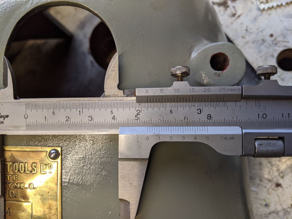

23/12/2020 18:53:06
Yeah Mat, it's really satisfying to come home to a working machine after 3 and a bit months at uni with no practical work!
I think mine was 1.5mm or something. I can't imagine the difference in thickness is making that much of a difference.
As for preload, I haven't done anything specific. I left the bearing closest to the chuck alone. I just tightened the other one enough. Not too sure really. I do know preload needs to be set so the machine functions. Phil's lathe turns much more freely than mine, so It may be worth setting my preload correctly one day. Perhaps when I do a full repaint.

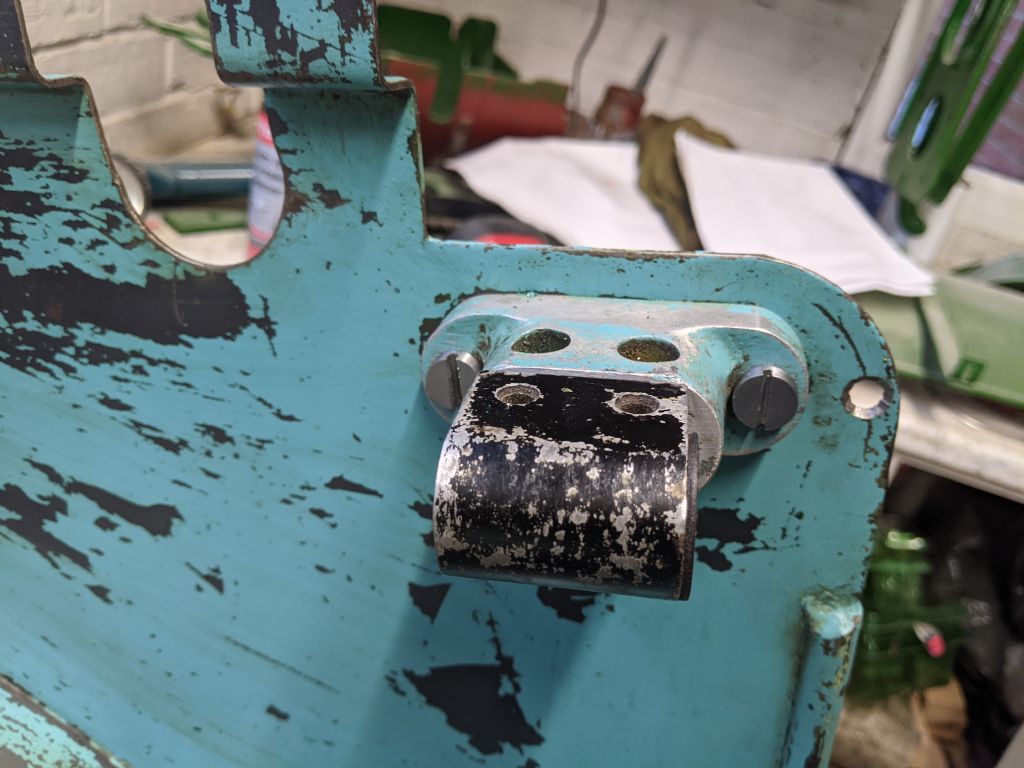

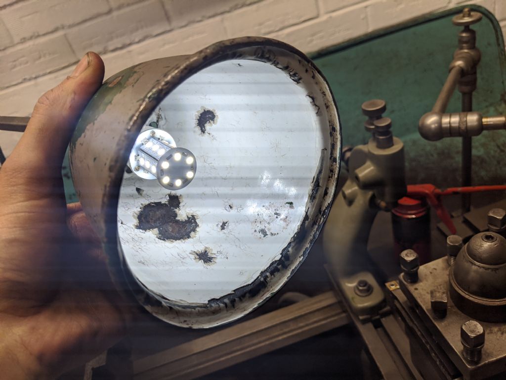

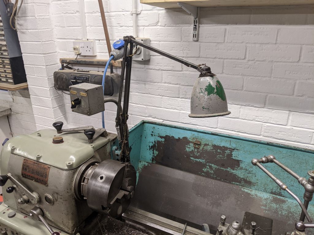

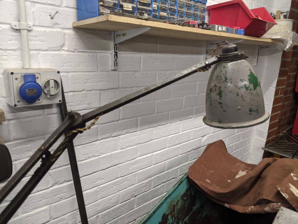

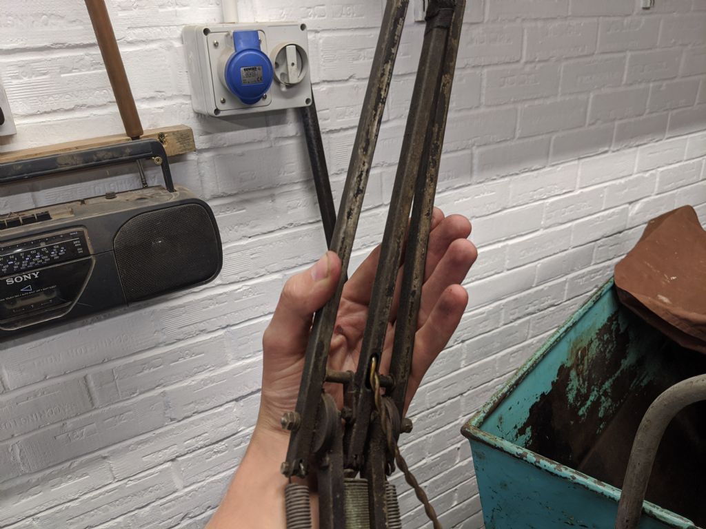

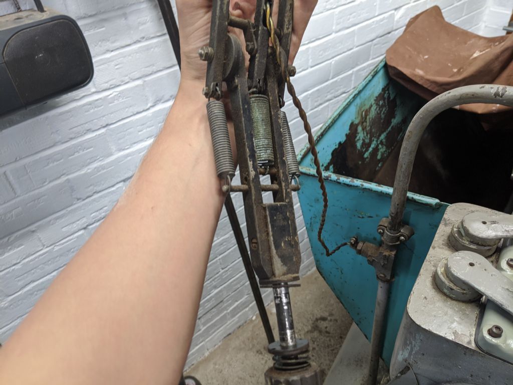

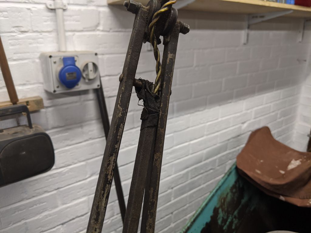

Anyway, I got the light mount mounted today, so the lathe is almost in one piece!
It seems to be in just the right position for me, so I'm very happy. I need to find some more turning to do now...

Looking at the leaks, I'm still not quite sure where mine is coming from. The headstock and gearbox still seem to be as full as I left them!
Although they are both above the level so I think it may be leaking out of the end of the spindle. Hopefully this will stop when the level reduces.

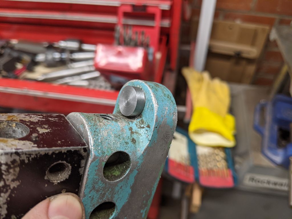

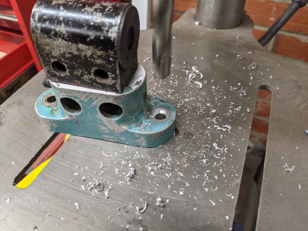

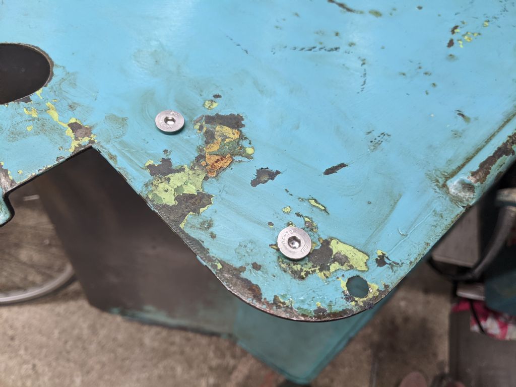

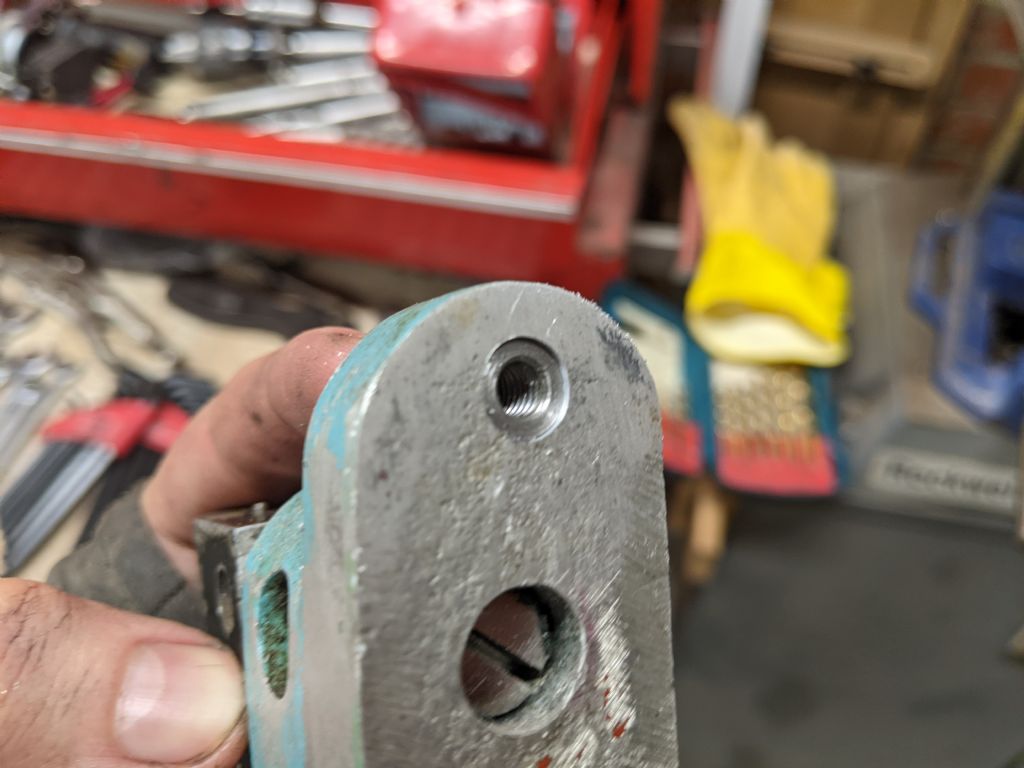

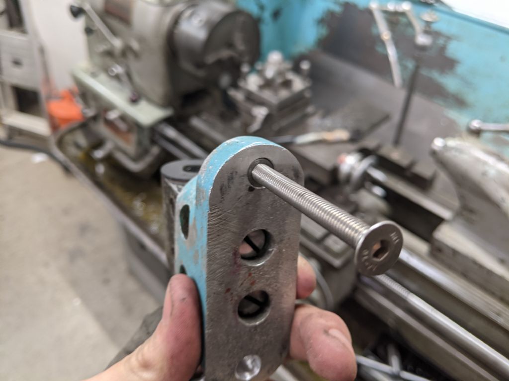

And then I decided to make the mounts for the light to mount to the backsplash.
I enlarged the holes in the mount so that the mount can use a m6 thread and still have enough meat in it
Turned some steel plugs with thick heads so I can cut slots in
Tapped to M6 so it can use the countersunk head bolts I have
The long M6 bolts, which have been cut down now.
These will go through the other side of the backsplash, so the holes will be countersunk until the bolt heads are flush, so the backsplash can still be mounted nicely.
I'll finish mounting it tomorrow

As much as my lathe is English, I suspect it still shouldn't be leaking this much!
I'll look into the source when I have some time.

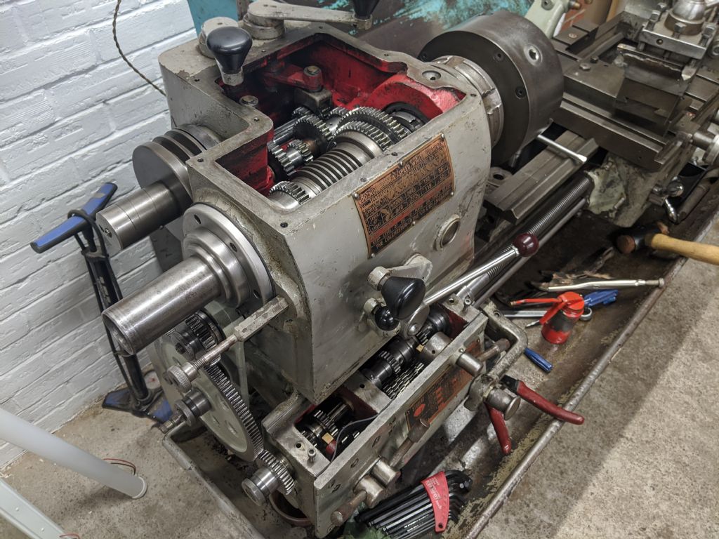

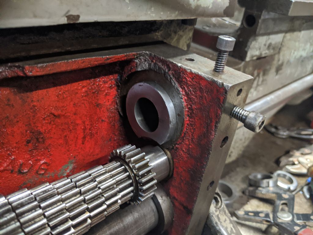

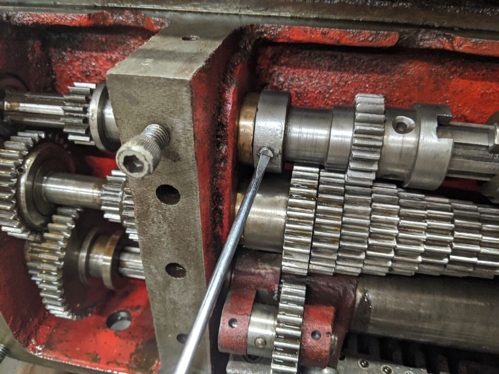

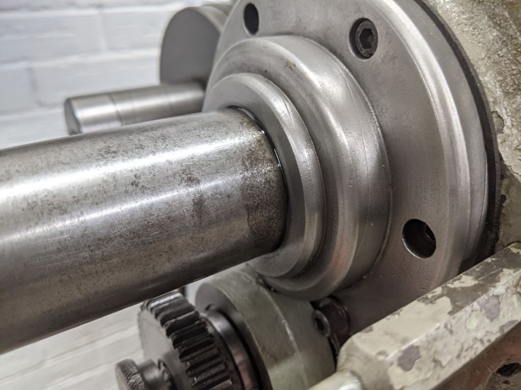

So, very productive. After I sorted out my balls it was smooth sailing(almost)
Lots of pictures, in case anyone else needs more detail in the future

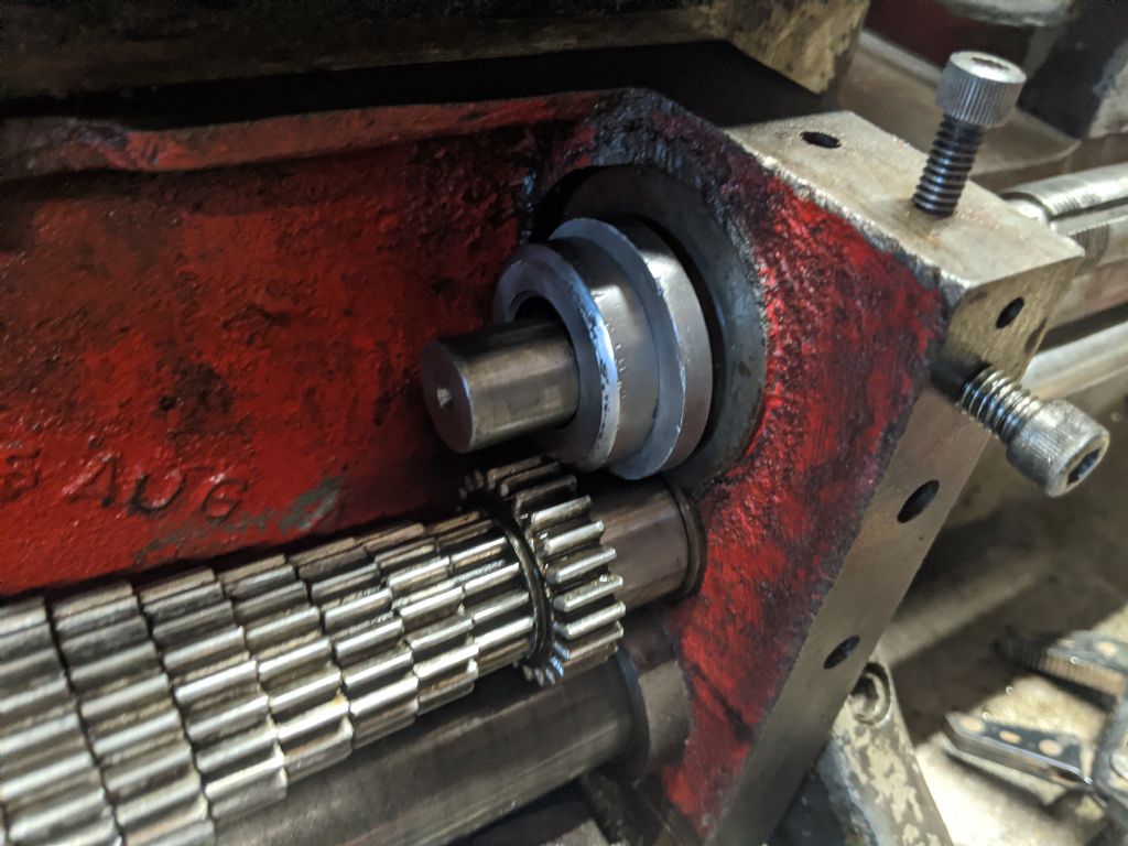

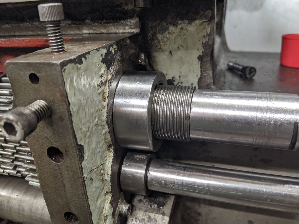

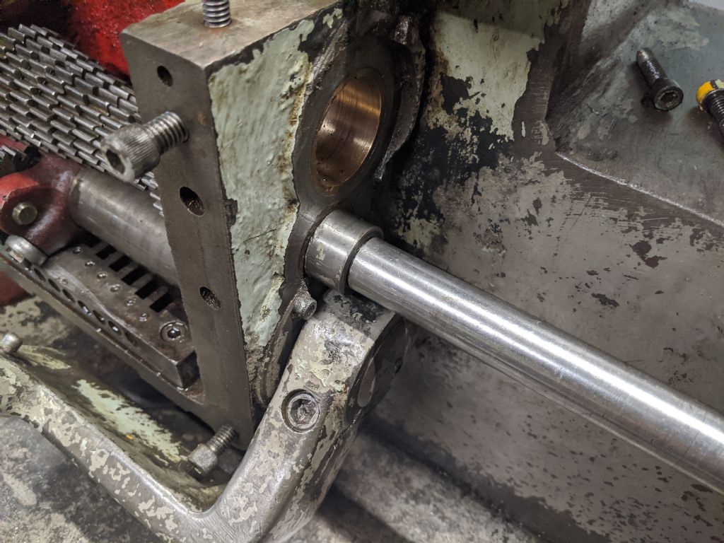

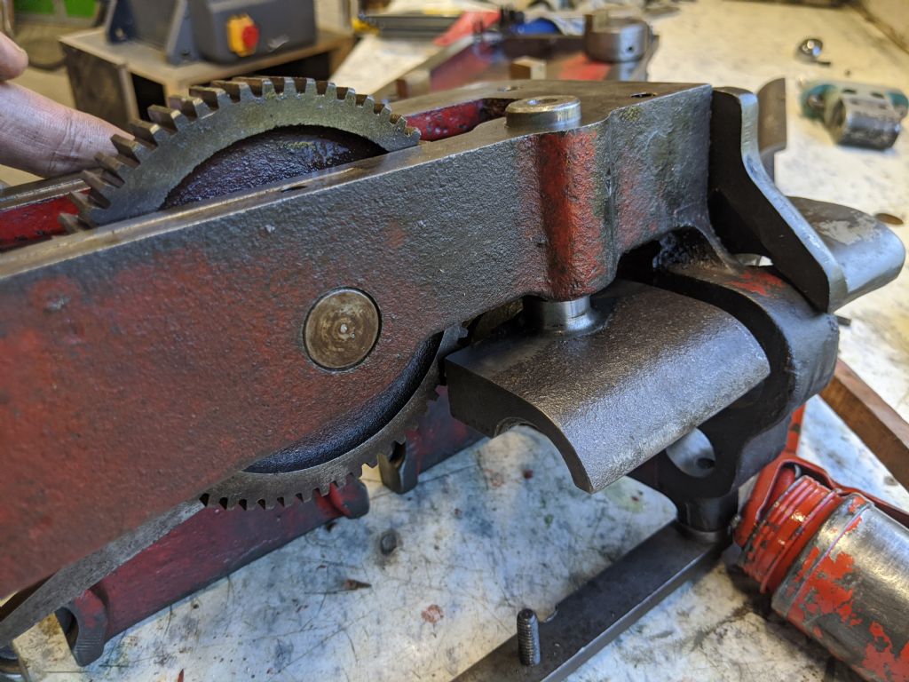

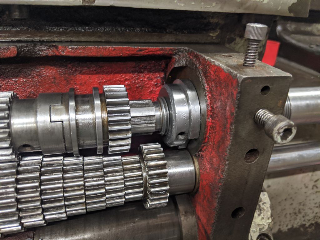

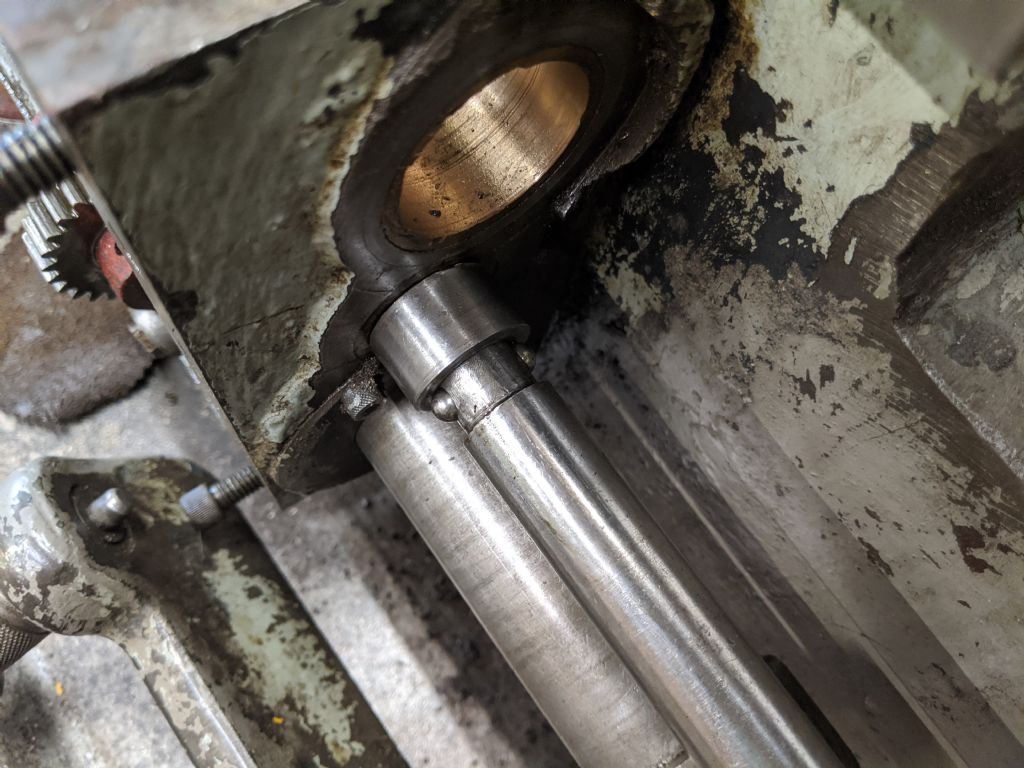

Popped this bit in first, then slid the shaft through. Making sure to have the three rings on the shaft once it was through the apron

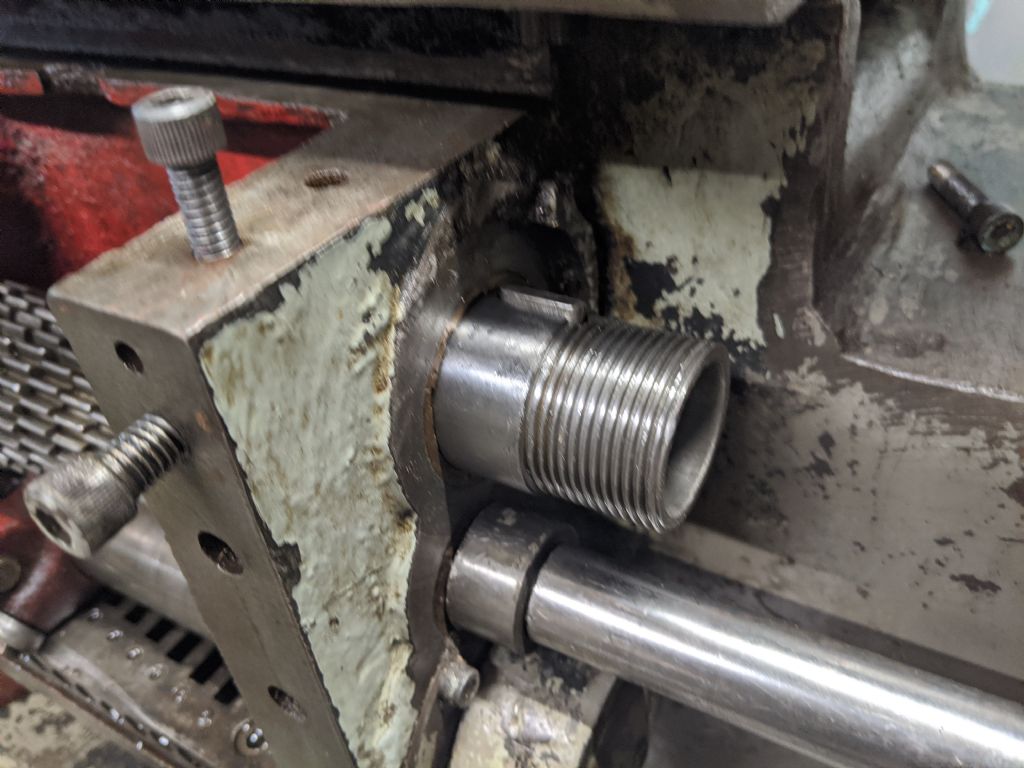

As the leadscrew was pushed through I put the gears on the end as it goes through

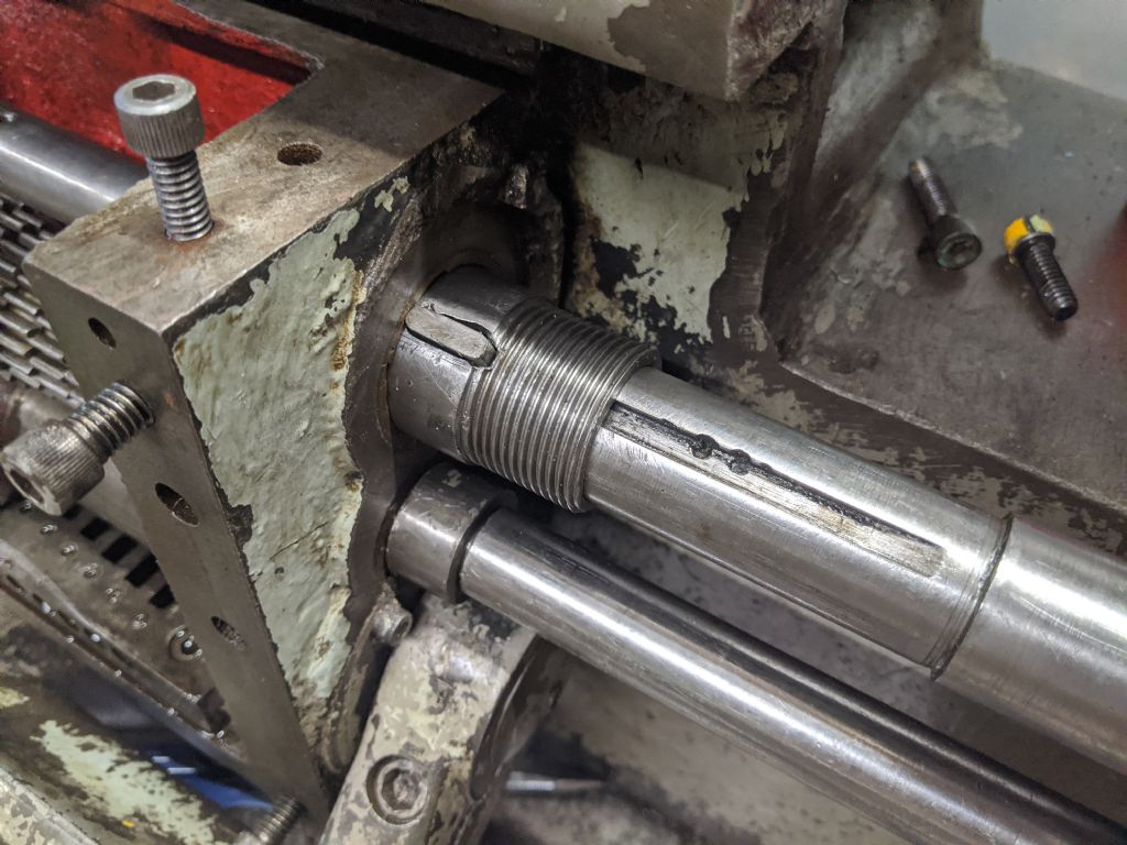

Then as it goes the last few cm, I threaded the collar on while pushing it in every few turns

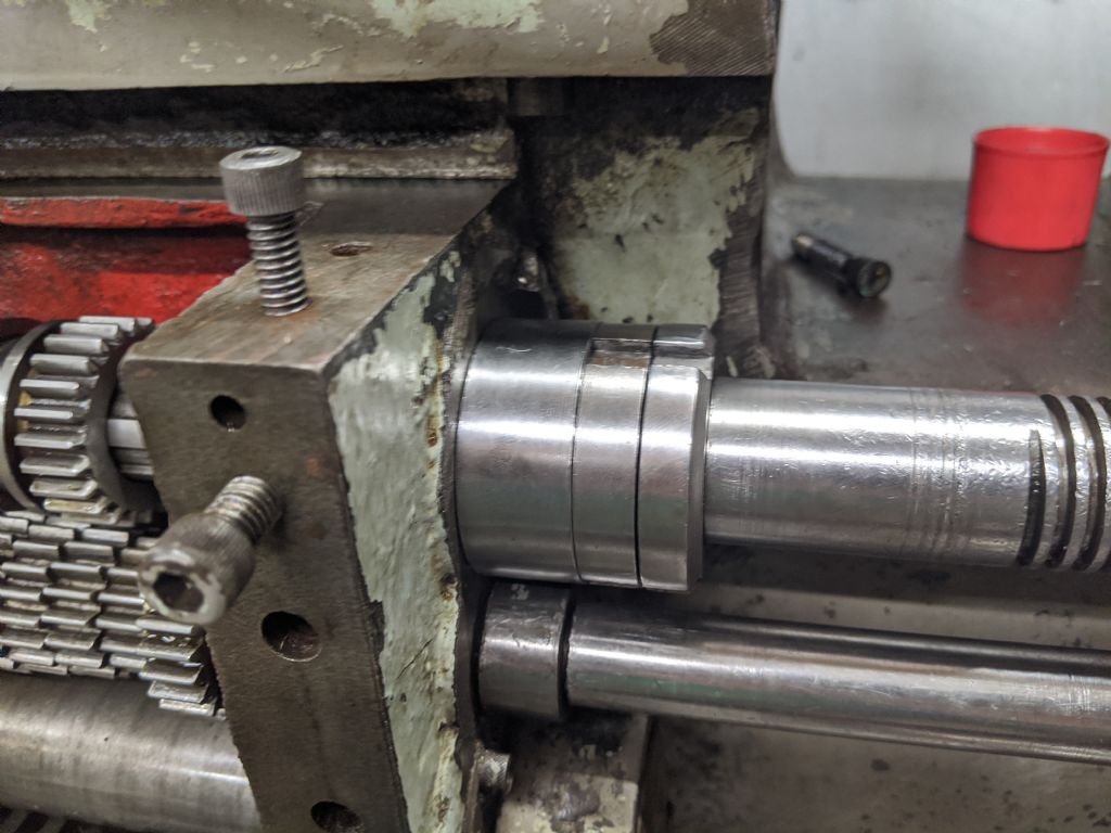

Then I slid the collar on the other side
And I screwed on the two locking rings. I struggled a bit getting these tight but not too tight as it caused too much friction, significantly. So it took a little bit to figure it out. All sorted now

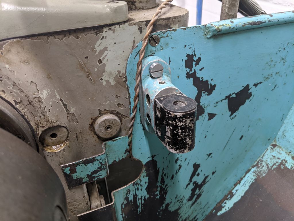

Then I found the spot that this screw had been tightened onto and fitted it back where it was

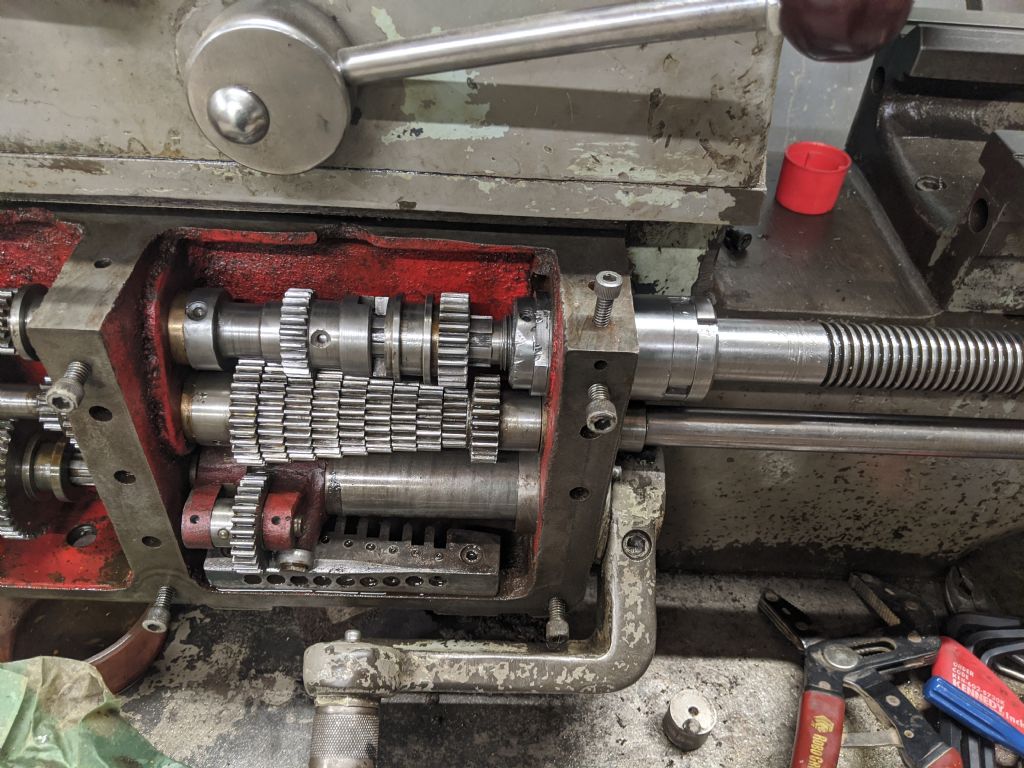

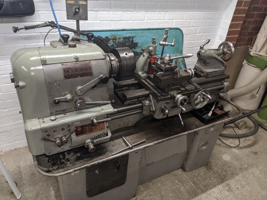

All done. They're not as scary as I thought they initially were, but still interesting mechanisms

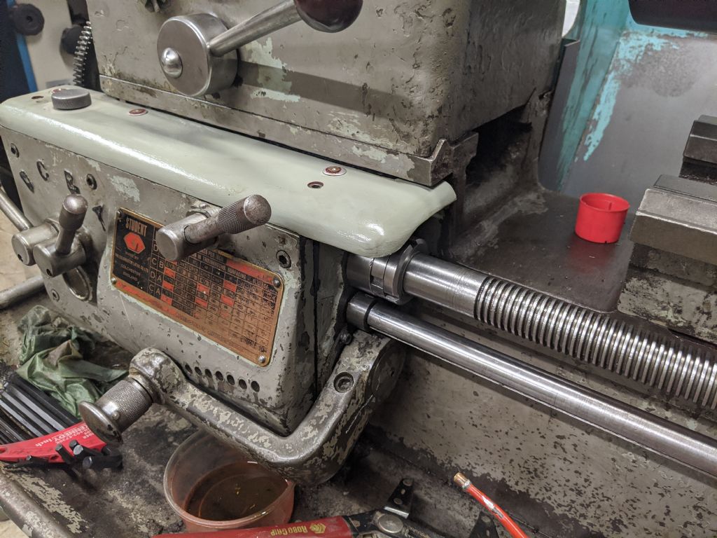

All looking good!
The cover looks a lot better since I filled the corners down. Thanks for the suggestion Phil
Fully reassembled. Different grey on the repainted parts, but I like it. The patchwork is only temporary
As for powering up, the light came on immediately. A good sign. I hadn't tested the new switch yet so I was happy to see that it worked
And that's it for pictures, but plenty of videos available below!
New half nut in motion
Worm box- improvement due to new spring
Still Spins
The new half nut works flawlessly, no issues engaging and disengaging now

It fits. It took me a while to figure out how it went in, since the other one was broken and very easy to remove.
Then I put the apron back on, then started to feed in the feed shaft, not forgetting the worm box
And now we have trouble. I've spent about an hour trying to get these balls squeezed and pushed in. I don't have time to get stuck now, so here I am. I fear I'm at a standstill. Does anybody have any ideas how to get these squeezed and pushed. I've tried all sorts. How did Colchester manage? I can't even squeeze them in with my fingers. The spring is strong.
I'm aware of the screw in the end to change the tension, but the tension hasn't been changed and it cannot be changed once it's fitted so I'd like to leave that alone.
Suggestions would be incredibly useful, but obviously I'm on a bit of a countdown. It may have to wait till I get back another time.
The real issue is the shoulder, since I don't have any pliers thin enough to allow the balls to slide in and then have space for the pliers. They just hit the shoulder. Absolute nightmare. Not how I wanted this to go.
My long thin pliers won't budge the balls as I can't put enough pressure on.

I've been selling the spare parts that I don't need on ebay, I've managed to get even with how much I paid for the parts so that's nice. But, I sent a few small parts to a man named Clive and somehow we ended up talking about students and his one needing a new wormbox since it's oval, so I sent him a link to Hermans forum as it may be of interest to him. I said to him that I needed a half nut and he responded saying he had one spare that I could have for the postage!
Good news for me since I haven't heard from James about that other half nut for a while, so I'm doubtful it's ever going to materialize from him. Still, the only downside is that Clive lives in France. So this morning Clive has posted the half nut to me.

Meanwhile I've been working on woodworking gifts for people at uni and things. I spent 4 days making 24 ducks! And a funny little cow. Nothing technical, but just fun decorations
I also have a piece of sheet metal cut out to become a motor cover. Not as fancy as the original, but it will do the job. No one will see the back anyway!

So is my light the original one? I'm not bothered if it isn't. But it's interesting to know.
My light actually has a section broken, so it could do with fixing. But I don't have time for that right now!
24/08/2020 20:25:26
There are some pictures, I'll get the others tomorrow
My hole is not oval, but this means the oiler that pokes through it is not centralised. So perhaps it's just an aesthetic modification to make it look a bit nicer
I'm not sure the lamp is original, but it works for me
