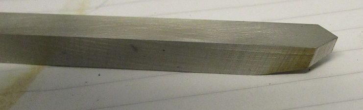

25/08/2020 11:59:57
Upate: Making a 90 degree cutter from HSS was much easier than I thought . Will see how it cuts but it opens the door to making numerous other cutters. Picture attached
whilst on the subject I came across a video of a man cutting a lantern pinion. he was cutting between 2 shoulders with what looked like a wider parting tool. I should add the distance between the shoulders was approx 15mm so not possible I think  with right or left handed as you can imagine. Can anyone help out with the shape of a cutter to make as in diagram.

25/08/2020 10:58:37
Posted by JasonB on 25/08/2020 10:33:58:
Posted by Chris TickTock on 25/08/2020 10:16:18:
Do not use abrasives on machine (My comment: but if you do use a cloth to protect ingress)
Add to that Do Not use cloth to protect the machine as if it gets caught up bad things can happen. If you need to then news paper or a paper towel will be safer. I also have a piece of board I can lay over the lathe bed if using any abrasive, likewise some boards to lay on your mill table are a good idea for anywork as they prevent damages and help keep the tee slots clear.
good point..thanks

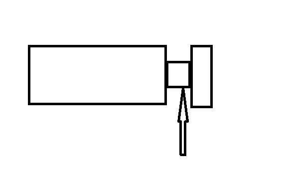

24/08/2020 18:15:05
Posted by Baz on 24/08/2020 17:26:12:
Try making two angled passes per tooth, this will leave you next to nothing to remove with your flycutter. If it is so difficult for you to make a pinion why don’t you make a lantern pinion instead? Lantern pinion only involves turning a cotton reel shape and drilling a few holes and poking a bit of pinion wire into them.
Thanks Baz, I am making a pinion purely to know how to and in doing so trying to look at best options. The lantern pinion is for another day. I am told making a pinion from high carbon steel is difficult especially with a fly cutter. Part of the fun is finding the best way to tackle a job, given I am a man in his shed economics comes into play.
Chris
24/08/2020 18:07:08
Posted by JasonB on 24/08/2020 17:22:11:
Simple single point tool in a homemade holder. Tool can be ground from broken ctr drill or milling cutter shank if you don't want to buy a HSS blank. Holder is just a bit of round steel bar, cross drilled for the toolbit and tapped at the end for a lockscrew
Edited By JasonB on 24/08/2020 17:22:34
Jason,
No need for me to make the holder as I can use the HSS blanks I have in the fly cutter holder. I think this may be the easiest solution ...thanks for post.
Chris

24/08/2020 17:11:32
Hi Guys,
           Using a fly cutter to cut a clock pinion is not an easy task on higher carbon steels. I am told it is a good idea to remove as much metal as you can before using the cutter.
Using a slitting saw achieves some removal.
However what I am looking for is an economic way to remove metal after the slitting saw to leave a chamfer which the pinion cutter can hopefully finish.
There are several possibilities and I have a rotary table so can rurn the stock as needed.
My ideas off the top of my head
Dremel diamond disk used on Sherline mill. A purpose made fly cutter just for hogging out. A chamfer bit (but is expensive) A double angle bit (is expensive), a rotary burr.
What do you more experienced guys suggest (apart from buy a Thornton's cutter).
Chris
