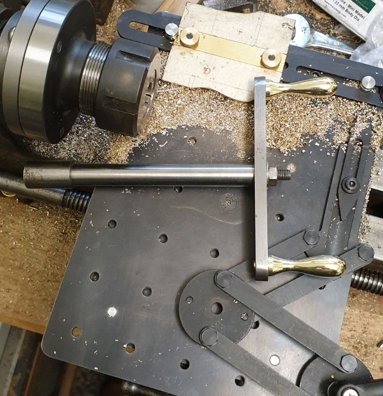

Good morning, Just an update after all the helpful tips earlier about lathe speed/finish on my brass turnings with the Turnado. Speed has remained the same (waiting on a new belt) but larger radius tools sorted my issue out.
I finished the batch of cone finial turnings and just made the pair of handles shown below for my tapping tool.
I was very surprised though that the finish on leaded steel was much better off the tool than on brass.
I think an Acorn nut is next, baby steps!
Thanks once again and stay safe.
Chris.

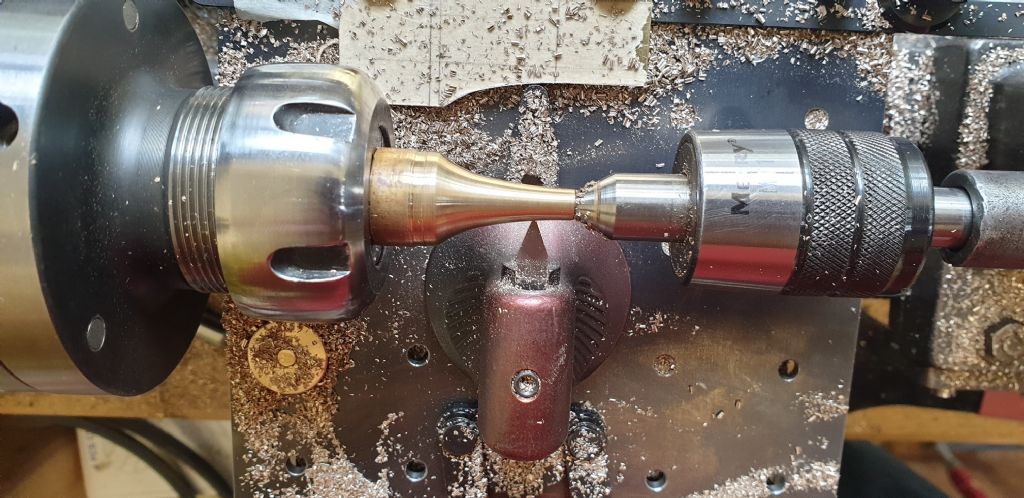

Good afternoon,
Could I ask please what others would recommend as the most suitable speed for turning the brass as in the photo below. Its 1" long x 3/4" dia stock turned down to 1/4" as the small end. (The sample in the photo had to be finished with file & abrasive to get it to look that nice)
Tool bit is 1/4" HSS.
