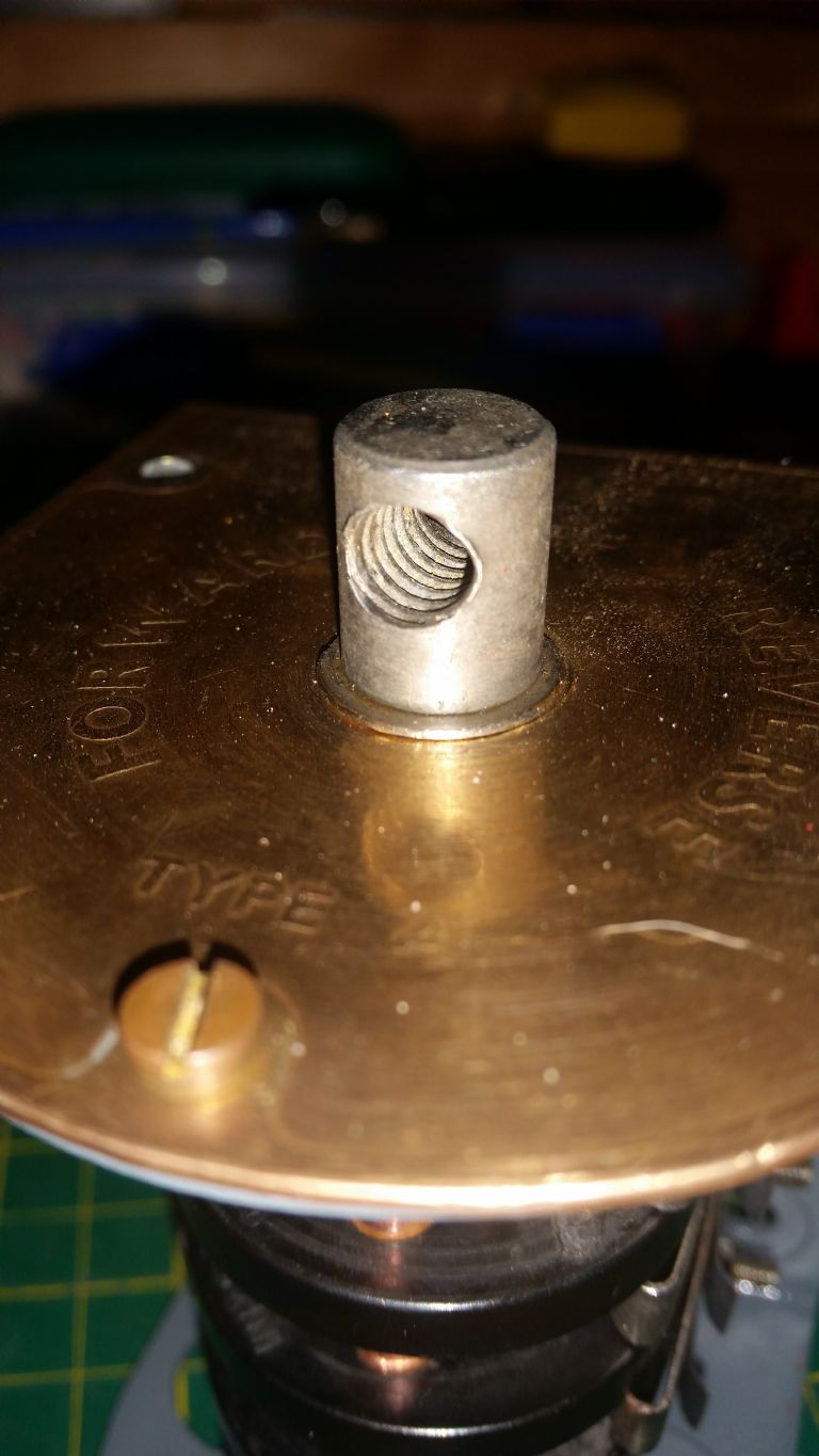

Here is the drum switch, i have stripped cleaned and painted it, its a type A Dewhurst switch and it appears to be threaded where the handle fits. Does anyone know how to measure this thread?
