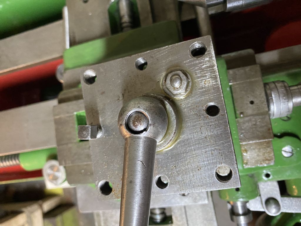

19/01/2023 11:22:13
Of course, damaged screws. Simple( when it's pointed out )
Thank you, David
19/01/2023 10:00:25
This is the tool post on the Mellor lathe I am restoring. The four corners have been opened out to 3/8” from 5/16” I can’t see it being like that from new, so I wondered why it might have been modified.
