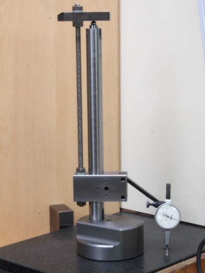

Thread: Clock Stand with a difference
05/10/2021 18:11:33
Posted by MadMike on 05/10/2021 15:31:15:
Lots of great solutions here but why not simply buy and use a height gauge to hold the clock/DTI? Or did I just scan the topic too quickly and miss something fundamental. If all you really want to do is make the stand that you described as a test of your own competence etc then I can understand the initial questions, however if you want to simply get on with with other machining then buy a ready made height gauge with a DRO fitted.
The opening line is that this is a Clock stand with a difference.
The difference being is that this Clock Stand will traverse a DTI vertically and check to see if a machine element, or a machined face on a component is dead square to a reference surface. Such machines are an "arm and a leg" to buy, and are a dedicated item, not dual purpose.
This design was initially a good Clock Stand, the facility to check a Vertical was an optional extra I thought would be good to have in the home workshop. Also I did say the DRO, to make it into a height gauge was another afterthought.
I have a Height gauge that I designed, and it has served me well for over 40 years, so really I don't really need a Digital version, but I am always open to try something new.
Lastly, while a commercial Height Gauge is going to be pretty close to a true Vertical, those I have looked at give no accuracy guarantee for perpendicularity, and in 40+ years in industry I have never seen one used for this purpose. The one designed here will.
Regards
