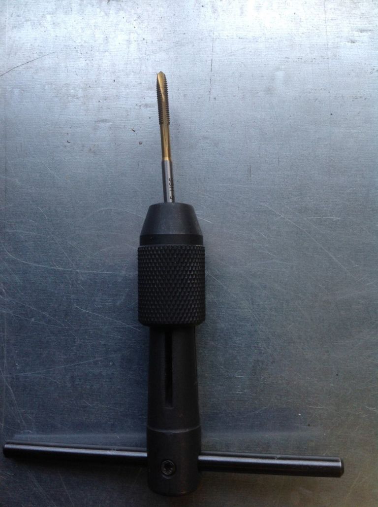

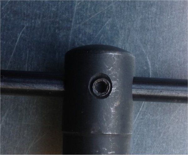

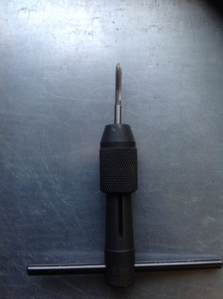

16/04/2020 18:50:03
Updating this thread, I've just bought a new Eclipse 142 tap wrench off an Ebay seller. It's going straight back, I'm afraid.
There are two problems with it. Firstly, the flats on the set screw that holds the tommy bar captive are already rounded off after one tightening and loosening. If the tommy bar hadn't been such a loose fit in the hole it might have helped; as it is, the set screw has to be tightened down particularly hard to eliminate unacceptable wobble in the tommy bar. I've plenty of better-quality set screws to replace it with, but the second fault makes that not worthwhile.
The second fault is that taps will not sit straight when the jaws are tightened up, whether you use the outer jaws or the inner ones.
My older Eclipse 143 has none of these faults. Sadly, like a good many other established brands, it looks like Eclipse is in eclipse.
