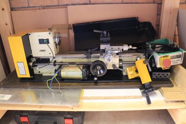

I dont know if i can get another photo, feel cheeky to ask since its all for nowt. All I've been told is that the board says 2335. When I have a Google it sends me to arc Euro for a C3 lathe. After not getting a definative answer by googling all I can surmise is that the board is the same as the C3 but just wanted to double check if someone knew for certain on here.
10/04/2018 09:15:54
Posted by Pat Bravery on 10/04/2018 08:33:57:
Beat me to it, I don't recognise that lathe.
Neither do I in its current state.
Clarke lathes seem to be yellow. So i think hes correct on it been a clark.
10/04/2018 08:33:07
The sorry looking state of the lathe.
Original photo of lathe as offered
Edited By Jon Cameron on 10/04/2018 08:34:26
10/04/2018 08:31:13
The 300 I believe is very similar to the sieg C2 lathe in features and size. I am assuming if mine is a CL350 which I'm now having doubts, wether it is a clone of the Sieg C3 and if the parts are compatible especially the mother board.
10/04/2018 08:23:24
Well that's one for the Google bots .Interesting, this is what posed my question, as I couldn't find any info on a CL350. Did Clark sell a rebadged C3 at some point around 8years ago.
10/04/2018 07:56:32
I've been told it's a CL350, an upgraded version to the 300, with larger motor and digital speed readout. This is what printed the question. The circuit board I think is the same used in the C3 with the 350W motor which I am told this lathe has.
10/04/2018 00:50:27
Hi, i have been given a non working CL350, I've been told the only thing that needs replacing is circuit board. Knowing most of these machines are all built using similar components, does the 350 share the same control board as the C3?
It may be a few weeks before it lands with me so I have time to do my research. From what I gather the lathe was bought around 2010, but has only see light use, till the board went bang.
