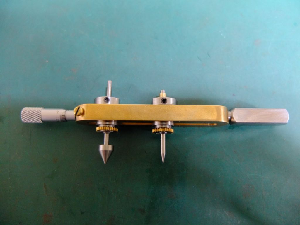

12/09/2022 11:01:59
Thank you for all the replies.
I realise that it is a transfer tool rather than a measurement tool and that is how I intend to use it.
I was just interested in what the best distance actually was. I'm glad I did as the accumulation of extra 0.2mm's on the wheel train meant I had to change my design a bit.
I'm happy with the meshing but would like to understand why there is such a big discrepancy. the blanks were all turned to within 0.01mm of textbook and DoC the same.
Steve
11/09/2022 17:44:27
Hello, I have been trying out my newly made depthing tool with a variety of Mod 0.3 wheels and pinions.
On measuring across the runners, the distance is consistently 0.2mm more the theoretical (sum of pitch circle radii). Any less and they bind. Plus 0.25mm gives a good mesh.
I expected it to be more than theoretical but not that much. Am I missing something here or does this seem normal.
By the way, the tooth form is involute.
Cheers
Steve

06/09/2022 16:50:30
I picked up a few of these tiny M&W micrometer heads some years back and I've used them for a few projects.
Here are the component parts.
The locking nut knurls are scrap gears. The runner locking screws are M1.6 Allen screws with the head diameter reduced. I drilled them out with a 1mm bit for a couple of mil then loctited brass rod into it and filed flat to length. This prevents any damage to the runners when locking in place.
And here's the tool in action.
Cheers
Steve
Edited By Steve Crow on 06/09/2022 16:51:10
