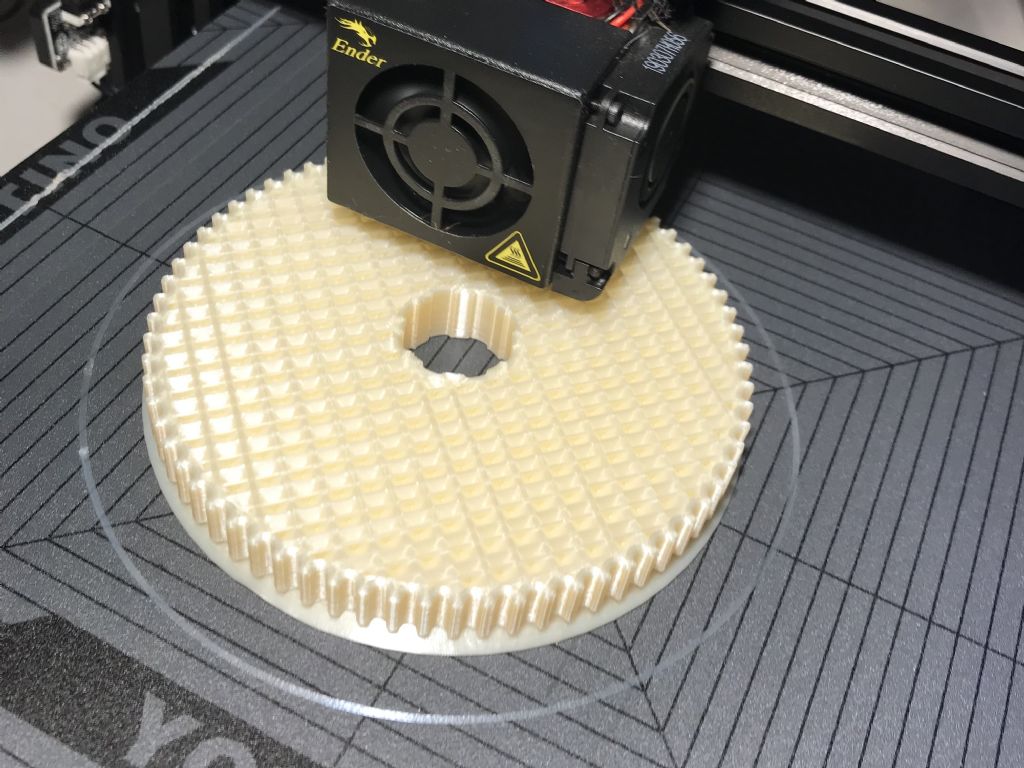

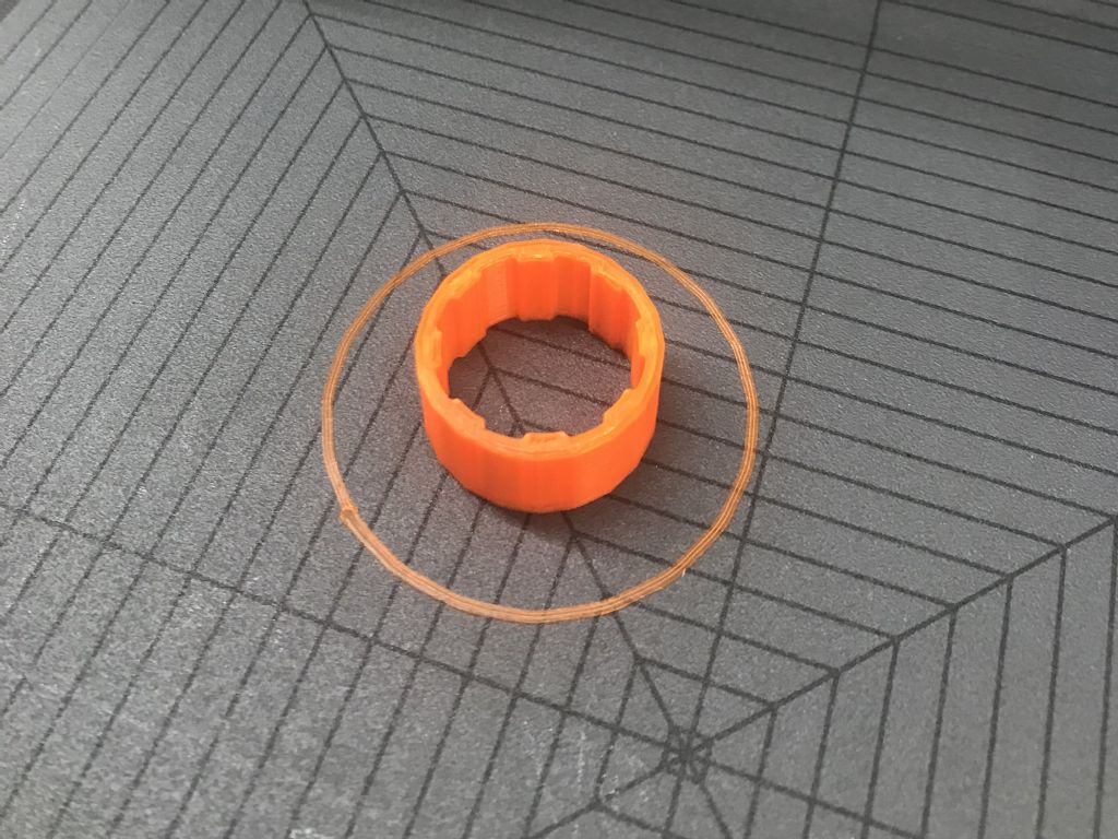

The pulleys took a bit of trial and error to get right but I think they'll be strong enough. I used a pulley generator on Thingiverse and inserted the Colchester spline centre using Tinkercad. All pulleys printed at 40% infill.
Colchester spline test
72T lead screw pulley
I chose to drive the encoder 1:1 with 60T GT2 10mm wide pulleys. I am driving the leadscrew with a 3:1 24T - 72T HTD 5mm pitch 15mm wide pulley.

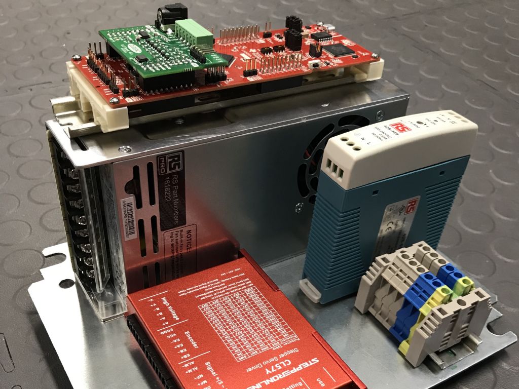

After much deliberation I went with a 36v switching PSU for the servo motor and got a din mount 5v PSU for the LaunchXL and enclosure fan. Component layout below:
Power enclosure layout

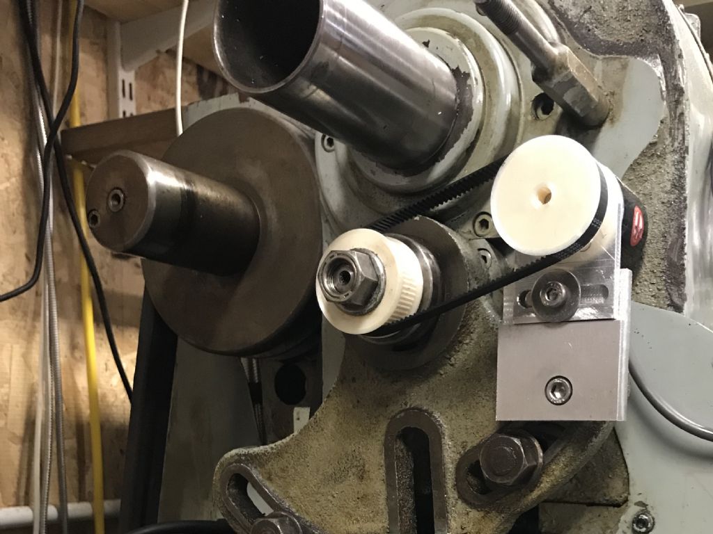

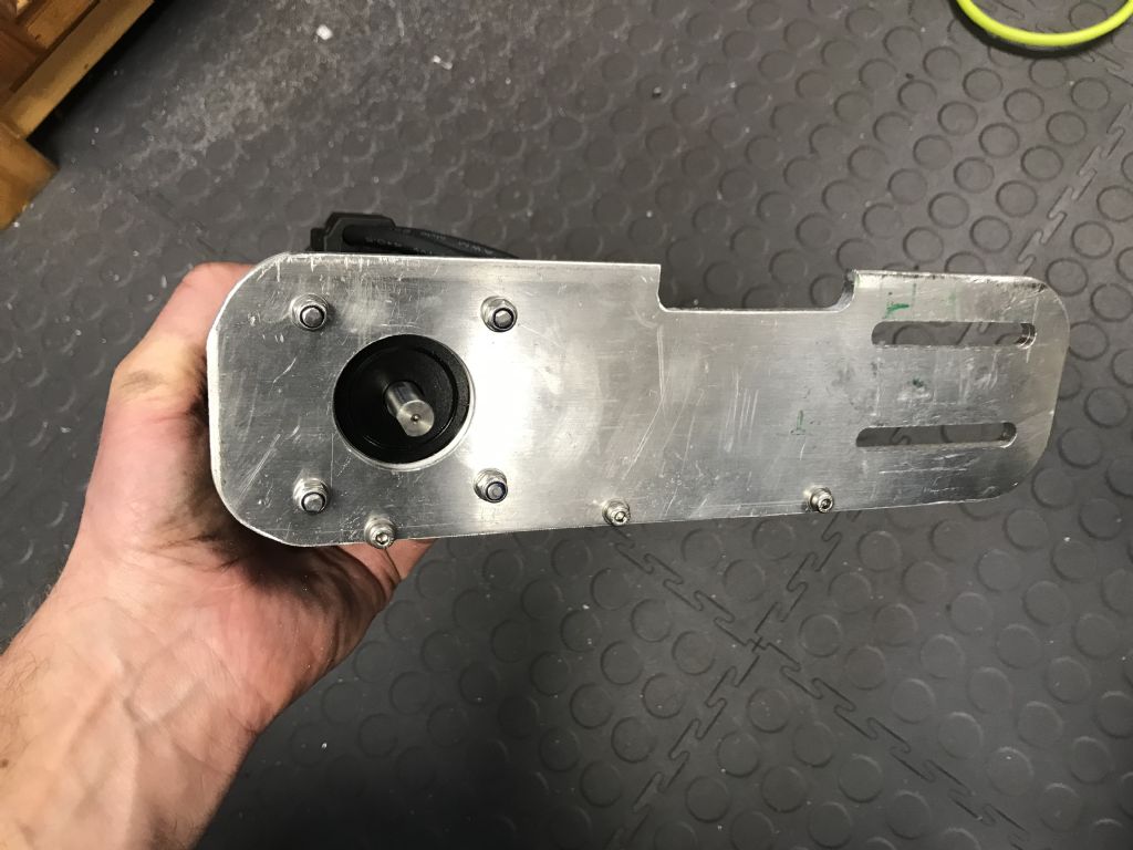

It took ages to decide on where to place the motor but in the end I placed it between the main drive belts. This meant there was absolutely no modification of the lathe needed. It fits nicely with loads of adjustment available.
Servo mounting plate
Leadscrew drive
The encoder was slightly easier but care had to be taken to keep it inside the cover
Encoder drive

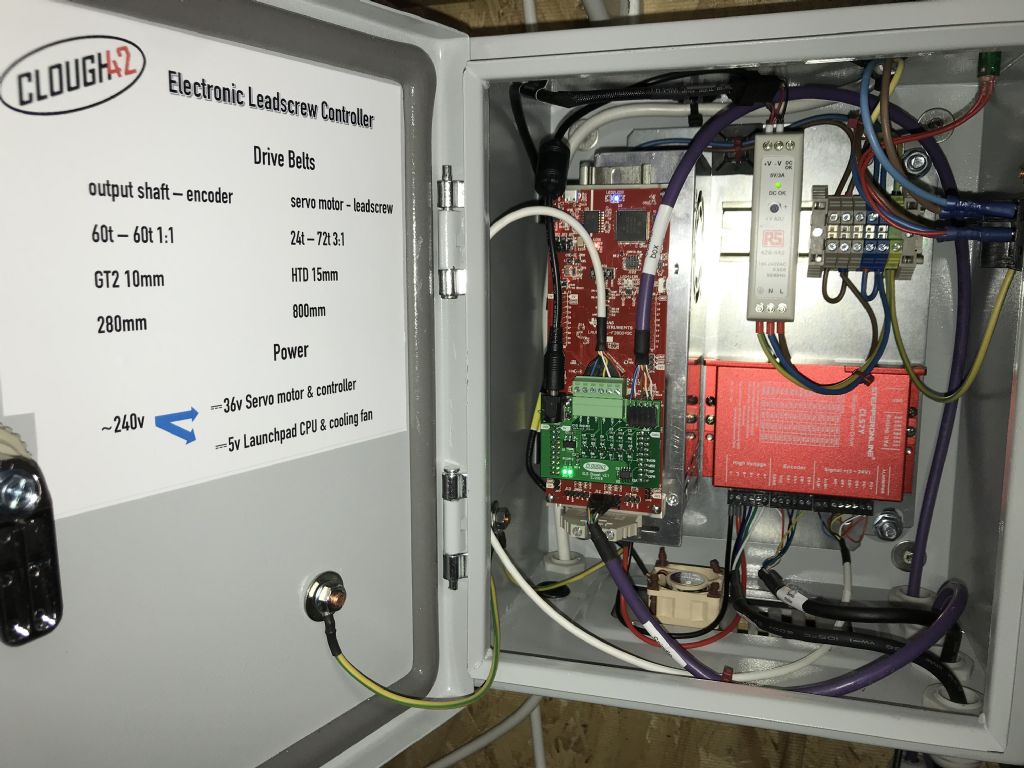

Finished power box below. I thought the box was going to be overkill size wise but I'm glad I left some breathing space!
Power box
