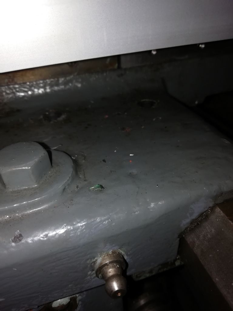

15/01/2023 12:54:25

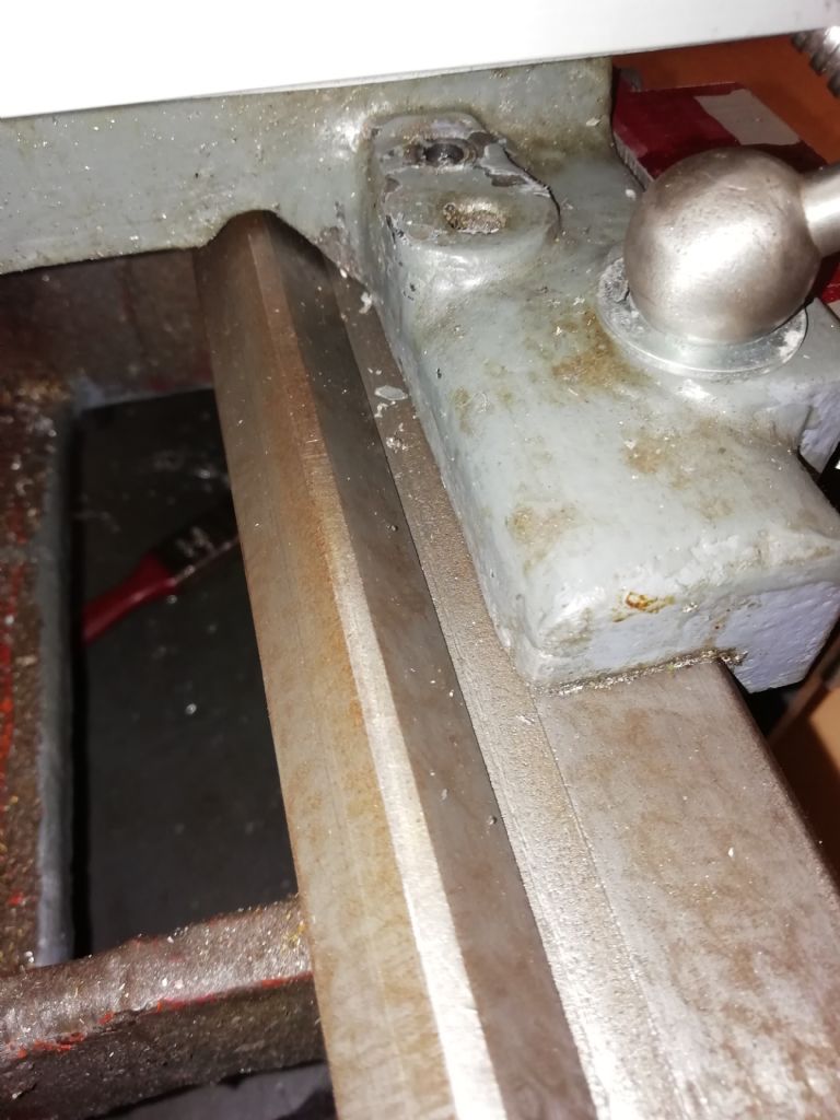

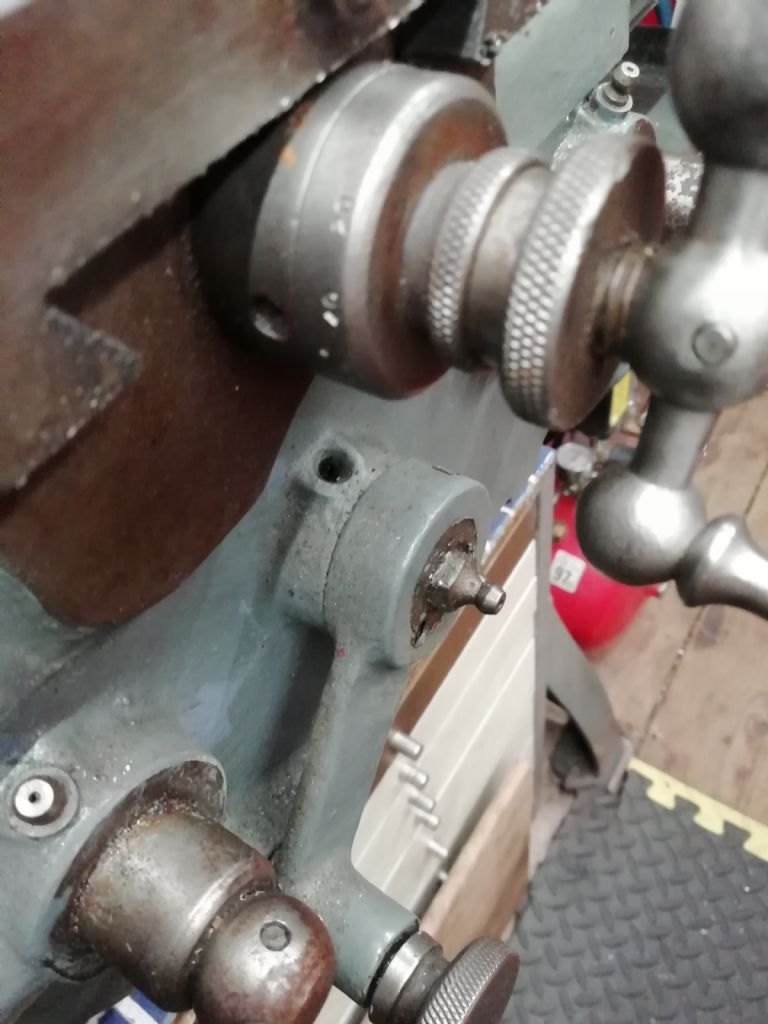

Here are some photos of the grease (oil) nipples showing the reason why I need 1/4" angle drive in ones.
This photo below is of the front of the saddle just below the crossslide handle:
This one is of the top front of the saddle nearest the tailstock, difficult to photo but there are 2 here:
And the last is of the top back of the saddle and is the hole furthest in:
I don't want to drill out and thread for the next size up as I don't want to risk getting cast iron swarf into the oil ways.
Roger

There is a good reason why I need angled ones and that is I don't have a straight in access to these positions so no chance of redrilling and threading for them, turning 5/16" ones down is an option but I just thought I'd see if I could get the correct ones first.

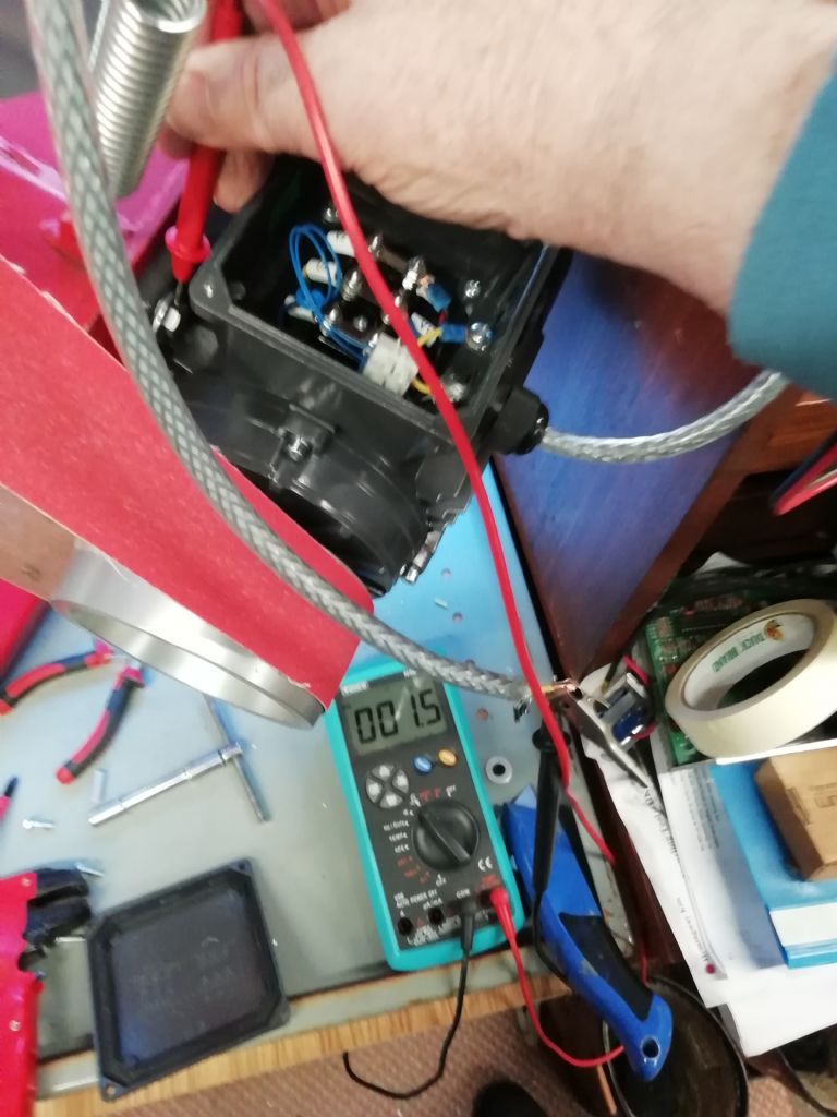

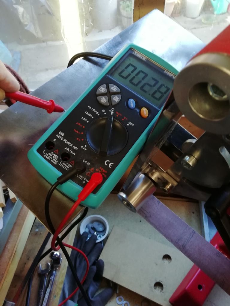

This is in my hobby workshop Robert, here's a couple of photos of a resistance test between the vfd earth and a fixing bolt and the sander table.
vfd earth to motor fixing bolt.
vfd earth to sander table.
The whole belt sander will be bolted through a steel base which is earth bonded to an earth running round the workshop and back to the mains.
Roger

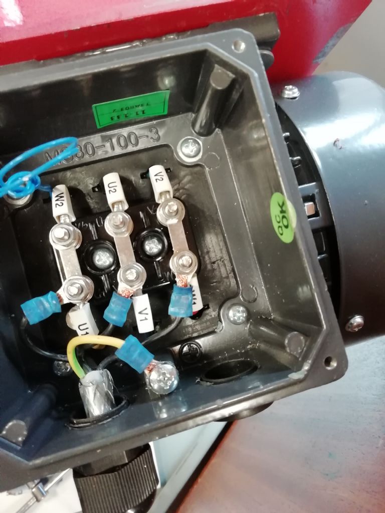

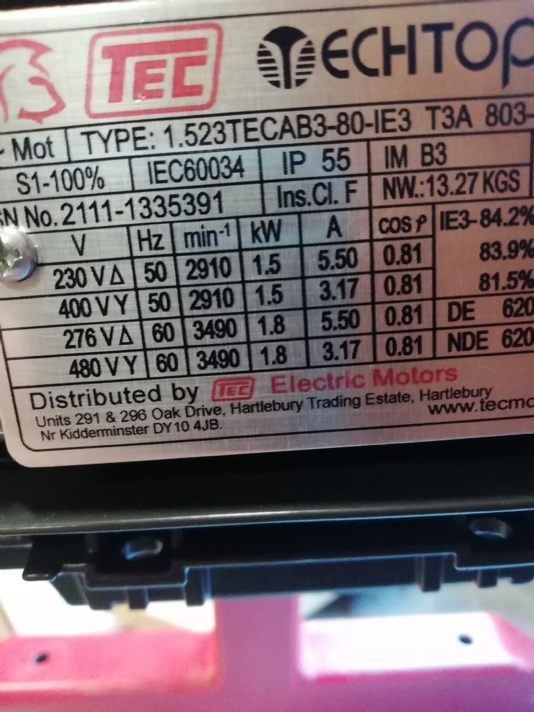

03/11/2022 15:49:44
I'm currently wiring this motor to a vfd and my query is there are 2 thin blue wires ending in a small connector as below, in the top left hand corner, are these for temperature sensing? otherwise what are they?
Thanks
Roger
