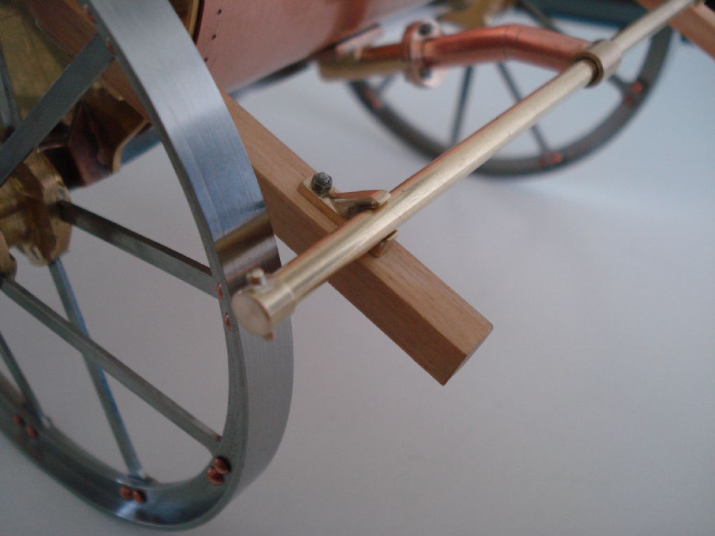

Progress (a little) on the 1" scale Water Cart
Trial fit of the spray bar and fittings today. I knew I would find a use for a section of a 1960s car aerial. De chromed hard brass tube, it was just the right size (5/32".
Have also managed to keep near to the original design of the valve (metal to metal). -
