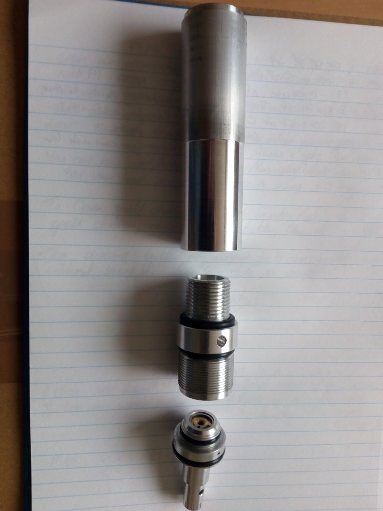

02/05/2019 18:28:45
img_20190502_180345.jpgI apologise for taking so long to show the components I needed to cut 14 tpi for. Below is the collection of parts the small item was bought in, the other two made by myself. The solid bar still needs to be parted and faced then drilled and tapped to take the guage assembly but it is very nearly done now as you can see in the photo above.
My sincere gratitude to everyone that helped me to get this done.
Ian
Edited By Ian Skeldon 2 on 02/05/2019 18:39:17
Edited By Ian Skeldon 2 on 02/05/2019 18:39:46
