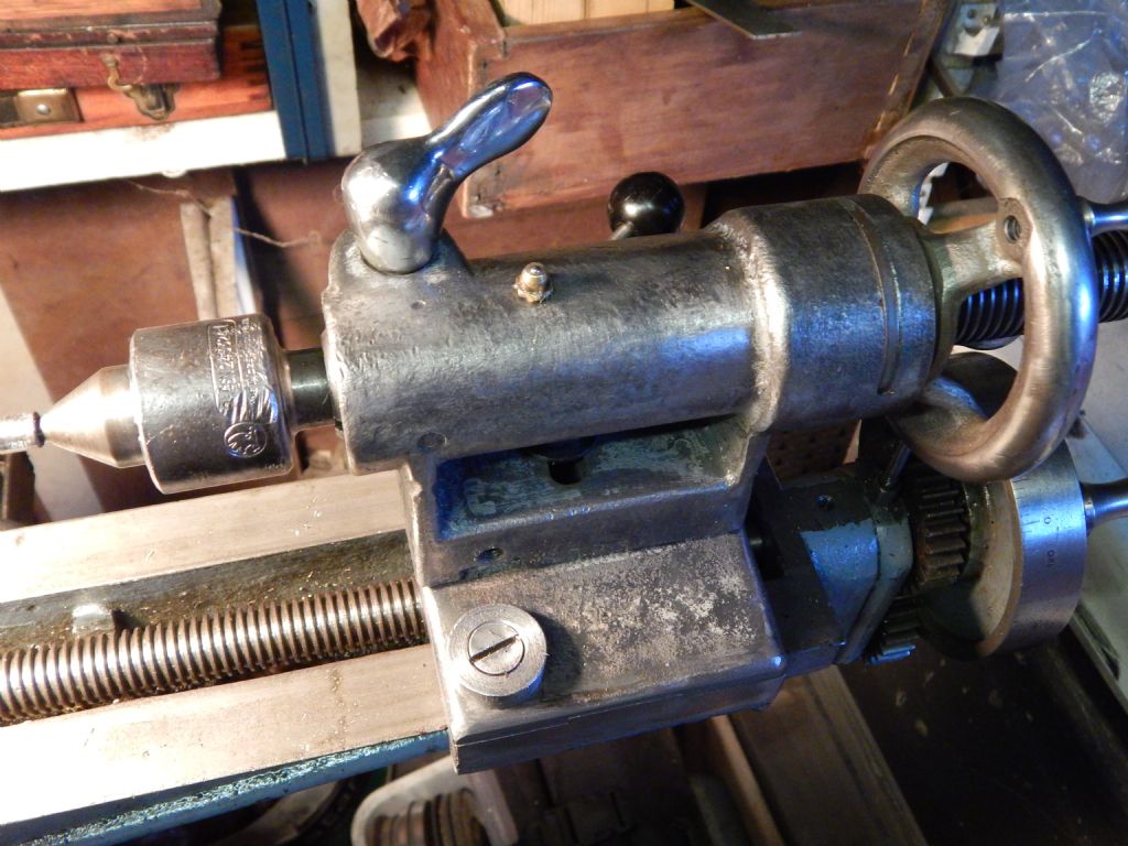

Conversion of another tailstock is possible. The hardest thing is to find something that will fit your bed as the width are all different. The second challenge is the vertical height to center of lathe. I Converted my lathe recently it will give you a clue whats involved here **LINK**
finished
