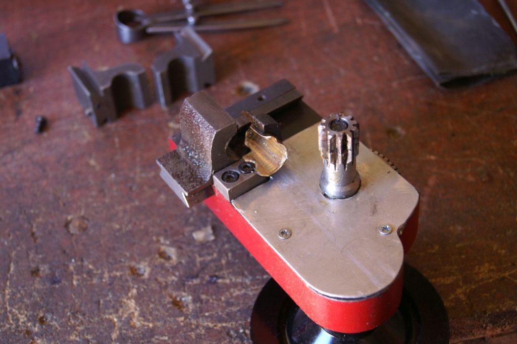

before 1 nut.jpgthread dial.jpg24 hours later and the sc3 lathe is running again>
The parts arrived this morning and were a simple fit. I did put a brass strip on to hold the half nut gib instead of those p*** poor washers.

Made a start on a replacement gearbox axle for the wheelchair. The original is nylon and it keeps shearing off so I started one in brass. Cutting an 0.8mm thread when my shiny new sc3 lathe half nut started 'skipping' so it was cutting grooves not a thread, most annoying.
I got on the Arceurotrade who promptly called me back could not have been more helpful.
We thought of a few work arounds, but in the end agreed a pair of half nuts instead of the single nut was the way to go.
The necessary parts are in the post, gratis, so the chair may get a permanent fix. yes

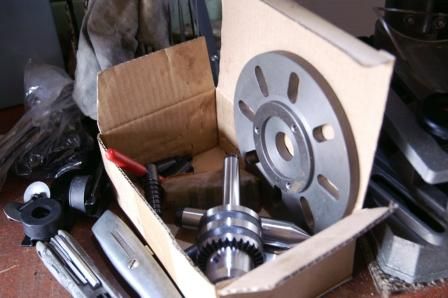

At last, the lathe fairy came in the night.
An SC3 from Arceuro.
Spent the morning degreasing and fettling.
