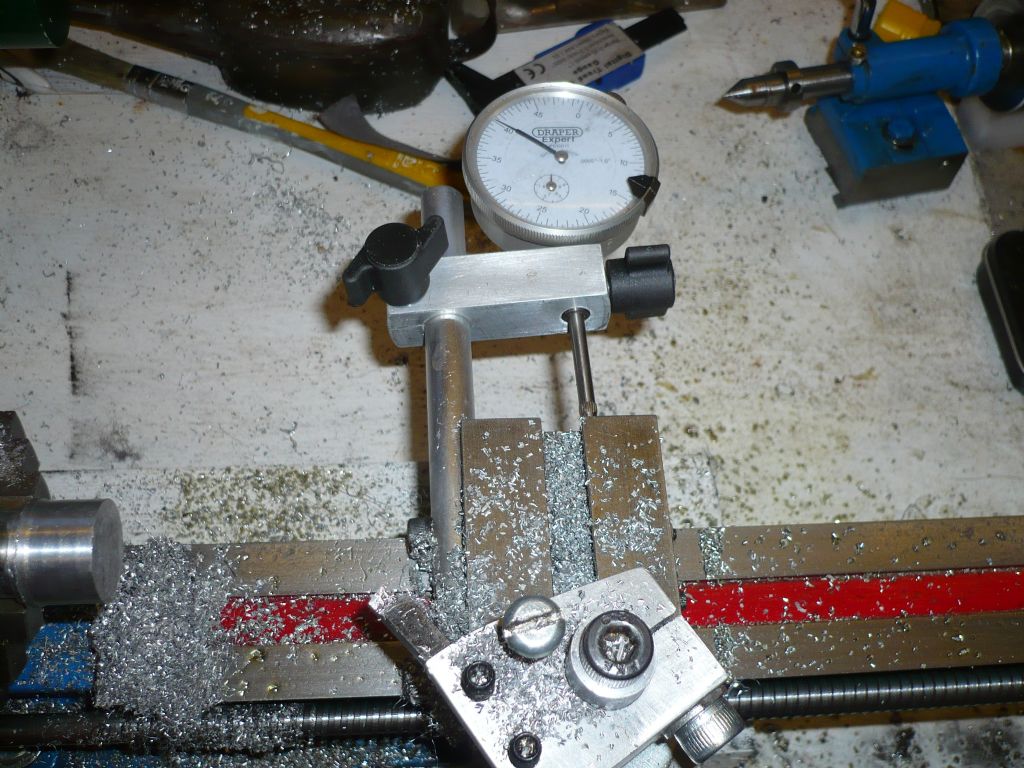

I have been finding the dial on my Flexispeed's cross slide difficult to use: the markings are not very clear, it has no numbers and there is no reference point on the fixed part of the slide.
To make life easier, I have attached a DTI with an adjustable bracket. I can also swap between a metric and Imperial gauge as the need dictates. Next step - rig up something similar for the saddle. For this, I shall probably use a digital tyre depth gauge as they are smaller and less obtrusive.
