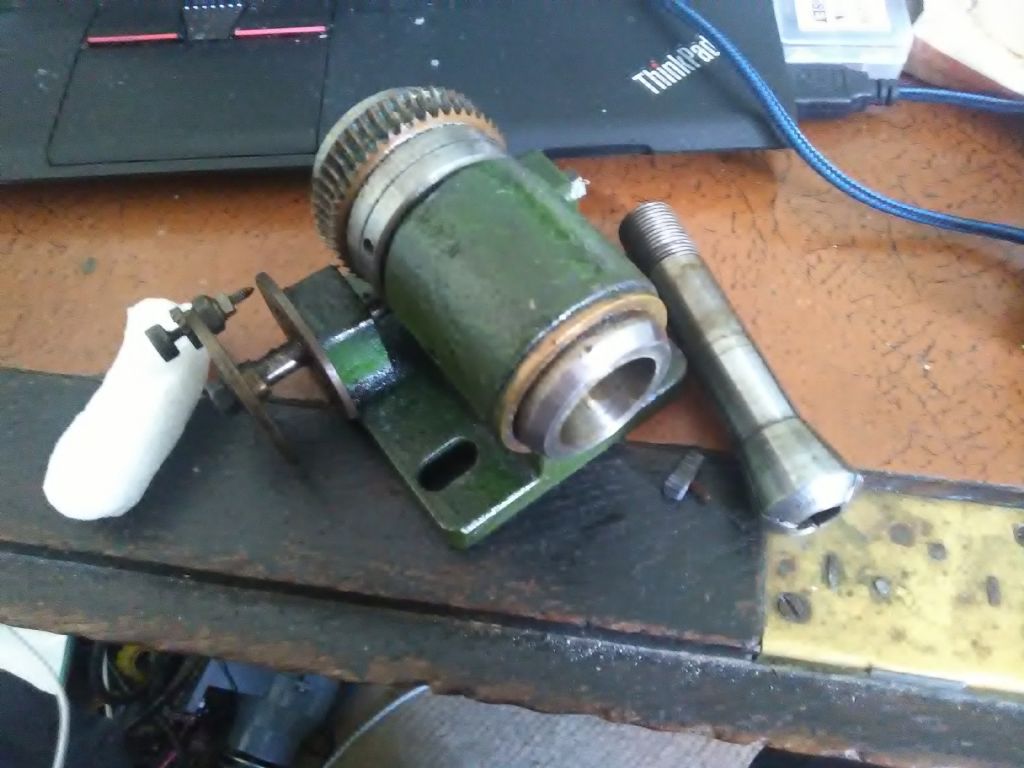

12/07/2017 18:37:08
Was about to take this spare backplate and machine it to match a new taylor chuck, then I notice it isn't actually a backplate
There are 4 countersunk holes and a very fine/now worn knurl on the OD of the nut. There is a radial hole in both parts for tightening with a tommy bar.
Can't think it was a particularly fast or simple thing to make so it seems a shame to turn it into a simple backplate without trying to know its purpose.
The collet is 5/8" on the body with a 5/8x20TPI thread on the end. No internal thread. Increases to 0.915" over ~0.650". Working height is 2". Could be homemade, not sure. Would be nice to know what the collet standard is, what machine it has come off if any.
