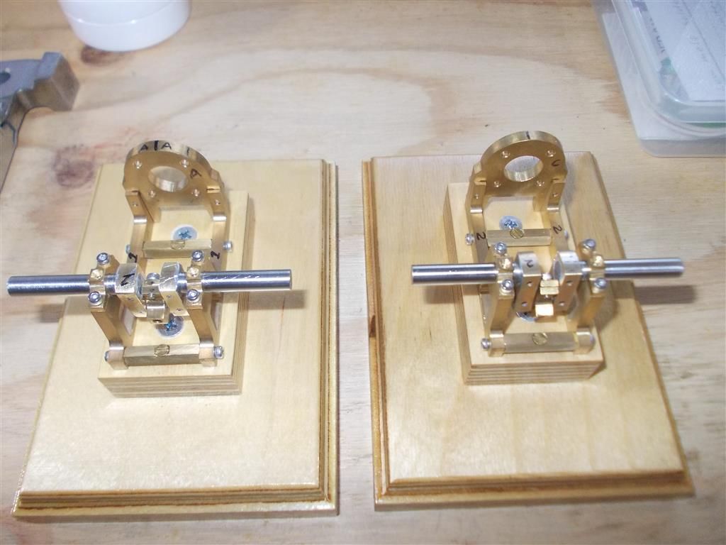

I have finished the second crankshaft using 243 degree soft solder. It does not stay nicely in place like the solder paste so there was a bit more to clean up afterwards but it is certainly a lot cheaper. I will stop at two crankshafts as I am only building two engines.
Once I solder the cylinders to the steam chests then I only have the piston assembly to complete. The instructions say to fit the piston slightly oversized to the piston rod and then with the piston rod supported between centres in the lathe, to turn the piston to fit the cylinder. That seems overly complicated and I doubt that the two M3 X 5mm grub crews will hold things firmly in place while the piston is machined. My preferred method would be to cut the piston diameter to fit while the bronze work piece is mounted in the chuck. The cylinder can easily be placed over the piston to check for fit. Once a good fit is obtained, then part off and drill/ream the centre hole.
Why machine the piston while it is fitted to the piston rod ? I do not see any advantage to that.
NOTE : I went to Rustys today but the guy with the second hand tools says he does not have any plumbers irons. I think I will use the solder paste for the steam chest/cylinder assembly.

Thread: Has anybody built Beng's Danni Steam engine.
12/08/2017 05:50:05
I have completed one crankshaft using the solder paste. It fits well and runs smoothly in the bearings. The large plastic syringe of solder paste seems to be mostly air and that makes it an expensive option. I will use 243 degree soft solder on the next crankshaft. The M2 X 2mm grub screws are removed after the solder has set.
Removing the middle part of main shaft turned out to be more trouble than I thought. I had intended to use the slitting saw on the lathe but the main shaft would have interfered with the lathe chuck. I then opted to use a cutting wheel on the Dremel tool but that only cuts half way before the tool comes up against the main shaft. I had to finish off with a hacksaw and hand files.

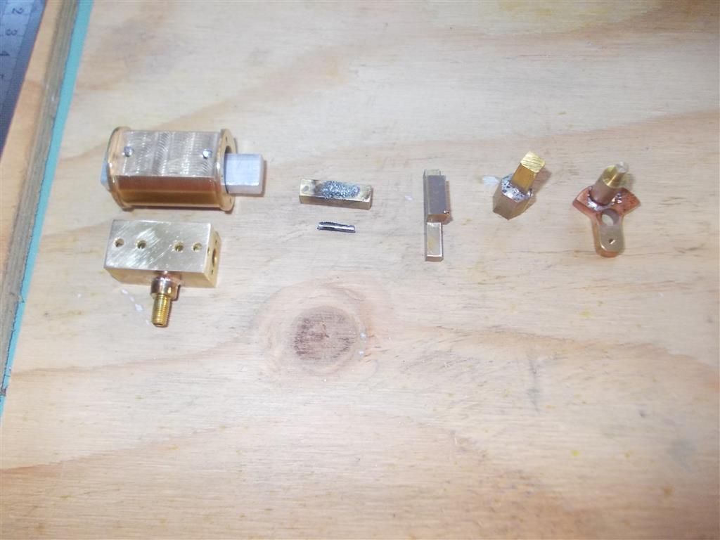

08/08/2017 08:32:18
I found somewhere in Cairns that sells the silver solder paste : Whitworths Marine. You can see the syringe in the photo below. Also in photo 1 is the 243 degree soft solder, the plumbers flux paste and the soldering iron I had intended to use to tin the cylinder and the steam chest. I spent the afternoon making sure everything fits together correctly first. I also cut two stainless steel rods 2.3mm X 10mm long which will sit in the steam holes which must not be blocked. You can see them sitting in the holes in the cylinder supported from below with a piece of aluminium. This is probably not necessary but I am getting a bit paranoid about stuffing this up : a lot of work has gone into these two parts !
I tried tinning some scrap brass after first applying flux to both sides. I cannot get a nice film of solder like they do in the videos ; I just end up with a mess although the parts did stick together after heating them up with a small blow torch (items 1 and 2 from the right).
I then tried the solder paste and the blow torch which worked better (item 3 from the right). I also tested the solder paste on the stainless steel rod to make sure it would not stick to the brass and it does not. It looks like I may have to use the solder paste.
You almost need three hands for this !

06/08/2017 13:53:23
My mistake : the instructions say to soft solder the crank but all the warnings against silver soldering were in the flame eater instructions.....I am not sure why. The two crankshaft assemblies are the same although the Danni crankshaft is a bit smaller.
Hopper : my initial attempts were done with a reamer. I had two goes at it with the two crankshafts and both were crook. I will be reaming them again after I Loctite the crank arms together.

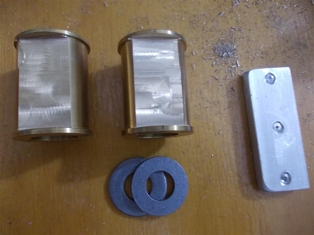

04/08/2017 10:12:42
A matchstick or some stainless steel ?: I have some 2.3mm stainless steel rod which fits nicely in the 2.5mm hole. I worry about timber igniting.
I finished the second cylinder today. Should the milled surface be touched up with a file or just leave it as is ?
I found that by drilling three 5mm X 2mm deep holes in the aluminium top plate that the screws on the mill slide could be more firmly located. This stops the cylinder pulling away from the vice. The two washers when held side by side measure 3.8mm so that gives me an idea when I am close to the required 4.0mm. There is no need to remove the work piece to measure it.
