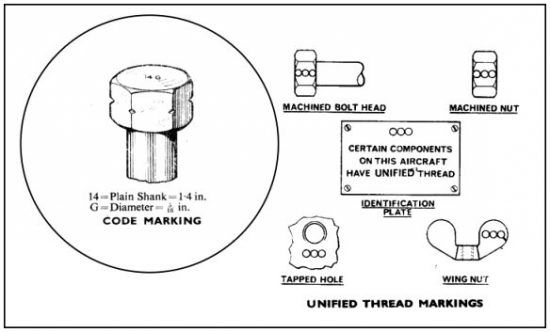

In the UK aircraft industry, unified threads were seen as the spawn of the devil. Purely due to the potential for mismatching resulting in dangerously reduced strength. All aircraft grade fasteners with unified threads had to be specifically marked with a symbol with three circles.
