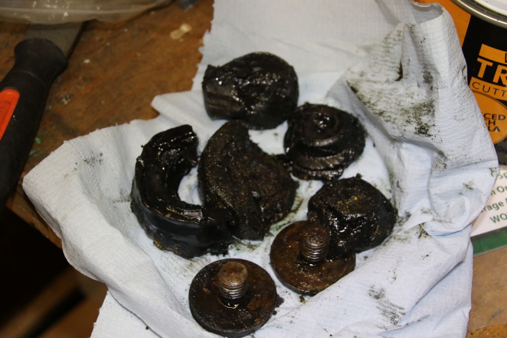

06/11/2019 21:31:34
Started the mount replacement tonight, you can see what state the old ones were in.
Once I had scraped the rmains of the rubber off, they unscrewed easily with water pump pliers
What was left
Replacement was well overdue!
New mounts will wait for another session.
