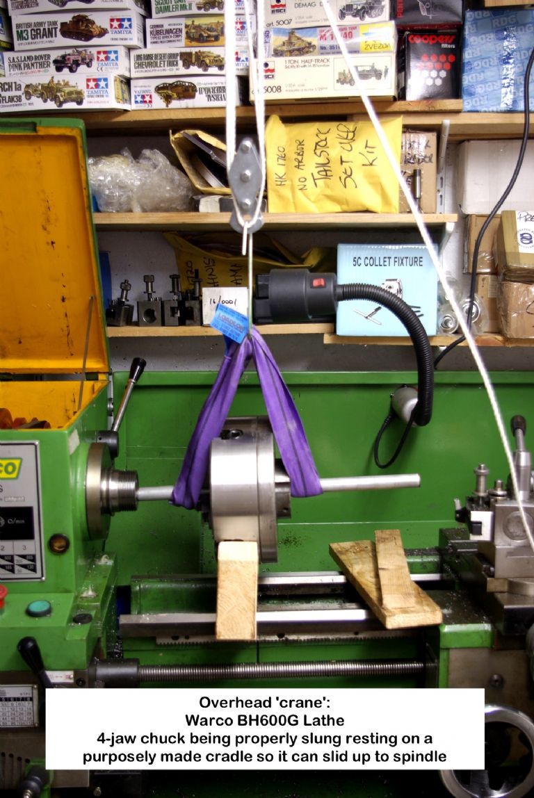

10/07/2013 10:51:14
Update.
Overhead crane
I bought a couple of the slings that Nick mentioned, before JohnS' post, and they arrived yesterday.
Thanks to Nick's description of the way he lifted his chucks, I did the same using a piece of steel tube but with one sling only.
The chuck lifted easily, and much more safely as well this time.
I, however, made some wood cradles for the chucks to be lowered onto and nearly melting in the 30 deg temp in the carport, the cut-out in the wood positioning the chucks at spindle height, so all that's needed is to push it up to the spindel and screw the chuck on. So so much easier now!
For the 3-jaw I had to cut a groove in the centre of the cut-out for the jaw adjusting screws as they are proud of the chuck circumference. Did think of turning them flush, but sense prevailed.
If I was lifting the chucks by means of the cradles, I would have made them wider of course.
Just need to figure out how/where to store the chucks now.
More photos added.
Geoff - Changing chucks now a pleasure

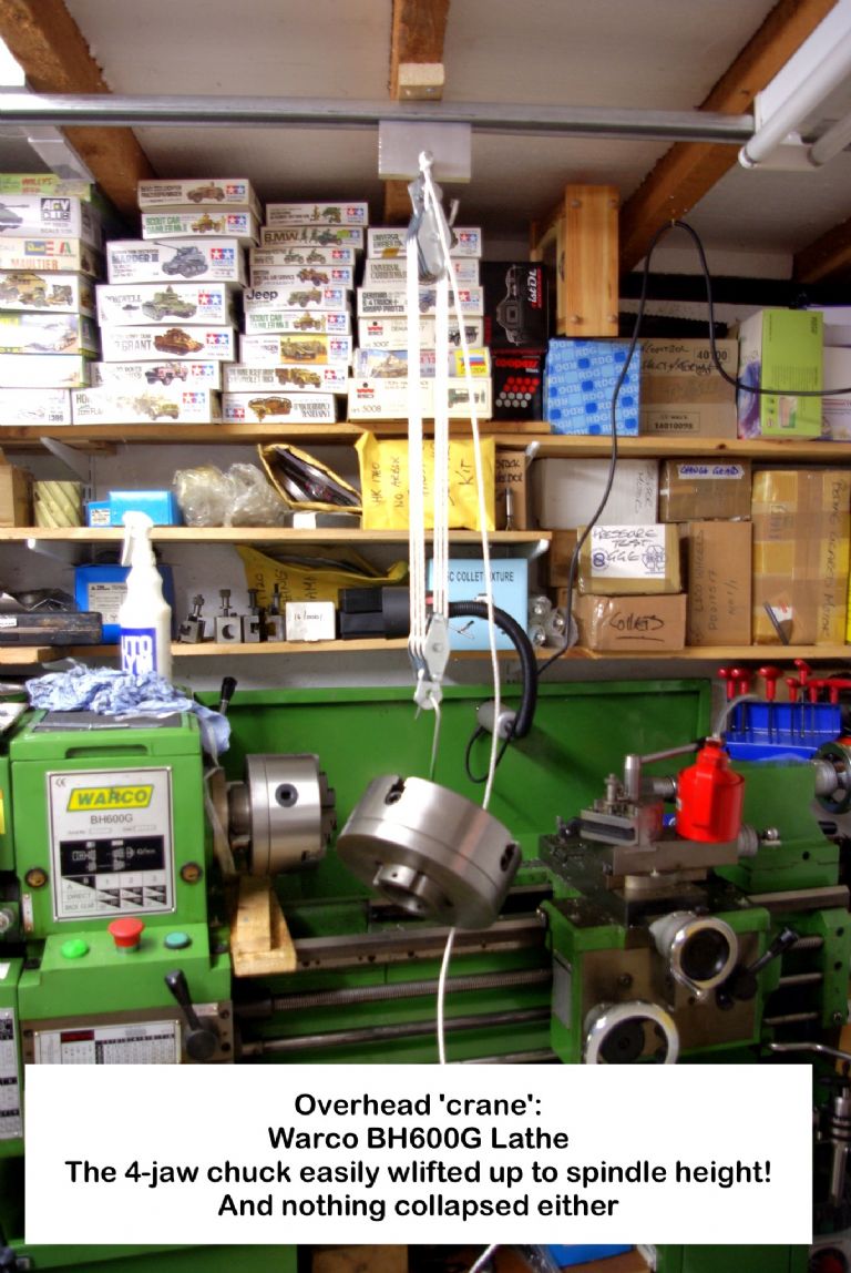

06/07/2013 08:53:43
Thanks all for the comments.
A the time I bought the 41x21 Unistrut, I didn't realise that 41x41mm was available which would be better in providing more 'meat' above the bearing axles. Cannot see mine breaking through though.
Ian S C,
Your idea never entered my head. Nice one.
MichaelG,
Yes you are right, it is much lighter to lift than I intimated at. Was in a hurry to pick relative up, so didn't do a proper proof read before posting.
Nick,
I forgot to state that the 'S' hook used was only temporary, and just to test the system, and that a more secure way was being investigated, but thanks to your brilliant idea I now have a solution at hand.
As a final thought, I have absolutely no idea what weight my system will lift, but no doubt more than I would ever wish to work with.

05/07/2013 13:08:41
Overhead crane
After hefting that 30lb lump of 4-jaw chuck a couple of times from floor to spindle, it was only a matter of time before I dropped it.
Dropping it would result in either a broken foot, even though I wear steel toe capped boots, or a mangles chuck, none of which appealed to me in the least.
Time to install a crane system of some sorts that could be used for lathe and milling machine use.
Hours of searching on the internet revealed systems ranging from Heath Robinson affairs to those that would no disgrace the ISS.
None, however, suited my particular needs of spanning all three machines, a distance of just over 3m.
Much head scratching about using channel section steel, when I came across Unistrut and that fired the brain up in devising a way to mount it with the open side facing downwards, and a trolley of some sorts to run on the upturned ends, with a pulley system attached to it.
As is my wont, I started to think up all sorts of weird, wonderful and complicated ways of suspending the Unistrut from the garage roof beams, to clear the power points.
I found a suitable piece of aluminium and decided that two axles with roller bearings should word, as they where low profile compared to roller ones.
These where ordered together with a double pulley system, and when received, I measured and drilled the trolley blank for the axles and pulley retaining strips then turned the ends of the axles for the bearings, still not having resolved how to fix the 'strut to the beams.
Sitting on the throne one morning, I said to myself "stupid old fart, just screw spacers onto the beams, and the Unistrut onto them" so problem solved.
The Unistrut was temporarily suspended from the beams to check if my solution would work, and so it proved.
Measuring up later, all that was needed where bits of 1" wood, so 5 pieces where cut and screwed into place, with the Unistrut onto them.
The securing screws needed csk holes, as there was only a milimeter or so clearance between the trolley and 'strut.
With the Unistrut in position the assembled trolley was slid into place and it whizzed along the rail without any problem, but the real test was yet to come.
First thing up was the standard faceplate that felt feather light, proving my system worked, so the real test was next.
The 30lb (15kg) 4-jaw chuck that 20 years ago would have meant anything to lift, but age and BigC treatment meant I wasn't happly lifting that to spindle height.
Now I needed to find a way to hook the lower pulley to the chuck, but a large S hook came to the rescue, it being hooked round one jaw with the others tightened up againt it. Nice and firm.
The test.
A gentle pull on the nylon rope/string had that chunk of metal rising into the air as if it was half the weight, and no creaking of wood or sound of screws parting company with wood, prooved my desing.
WhooHoo it worked like a dream, and the 3m length of Unistrut covered all three machines.
All I need to do now is make something to store the chuck and large faceplate I have.
I am chuffed to say the least at the outcome.
