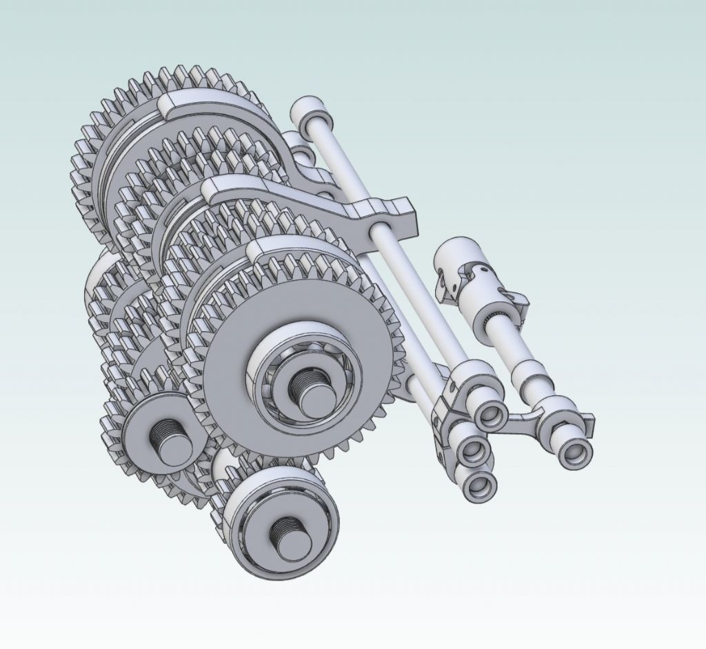

Gearbox internals
Having found a fundamental error in the gearchange mechanism, I had to re-arrange the selector rods and redesign the 2nd-3rd and 4th-5th selector forks to obtain a "normal" H-shift pattern.
