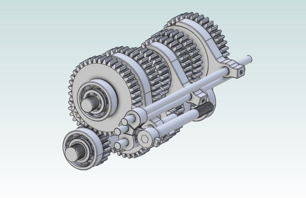

More bits added
The gear selector rod and finger added. The rod will be attached to a universal joint at the splined end, thence to the gear lever. Fore and aft movement is a total of 6mm and radial motion is 15° either side of the neutral position.
