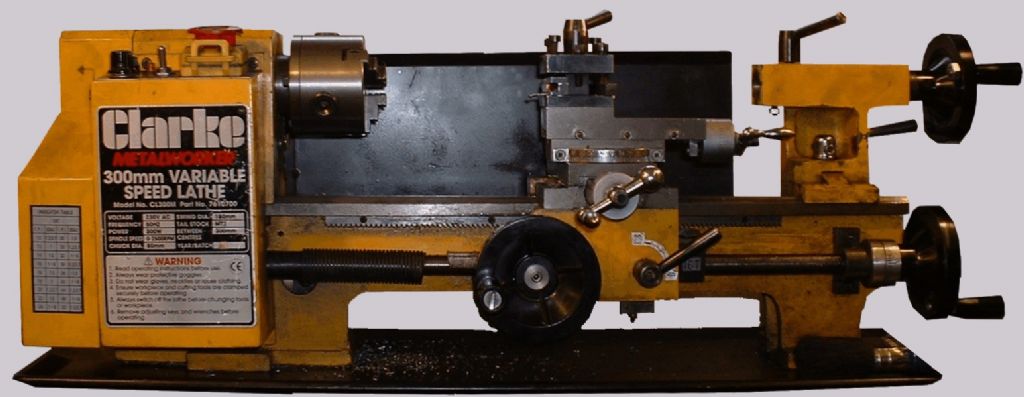

Photo 1: Clarke CL300M
The Original DC Motors
My Clarke CL300M mini-lathe was my first lathe (photo 1). Unfettered by experience or education, I assumed that anything I could fit in it, I could turn in it. One of the side effects of this approach was a burnt out motor. I now know a lot more about turning, and machine tools in general, and appreciate that just because you CAN take a deep cut at large diameter (photo 2), doesn’t mean you SHOULD! In particular, the slow speeds needed for such work reduce the ability of the motor’s built in fan to keep it cool.

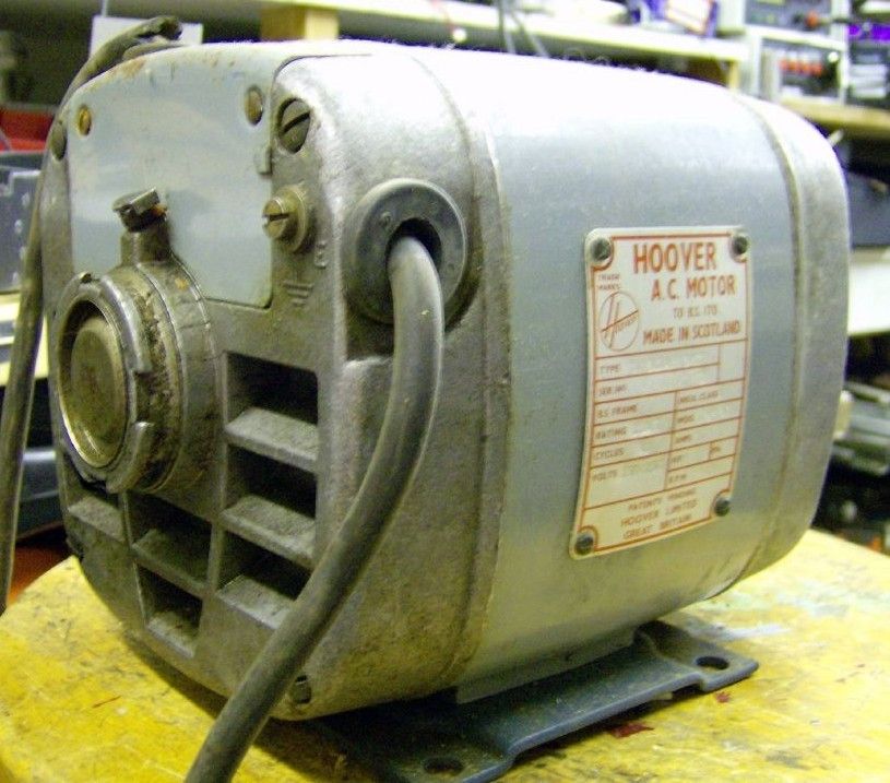

Photo 3: Single-phase Hoover motor
Converting to Single Phase AC
A quick check, and the old single-phase motor was found to run as smooth as silk. To get up and running as quickly as possible, I enlisted my milling machine as a sort of vertical lathe. With this I made a pair of basic pulleys. I also milled some plates to hold ball races, allowing me to fit a countershaft to fit in place of the lathe’s original motor.

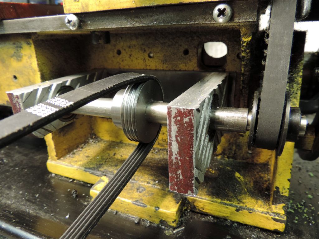

The design of a mini lathe makes it almost impossible to devise a direct drive to the lathe spindle, however, this problem was easily overcome by replacing the motor with a countershaft. This approach has the advantage of retaining the 2:1 reduction provided by the existing toothed belt drive from the motor to the spindle and the high/low gearbox in the headstock. This arrangement can be used to allow any alternative motor to be used, you just need a matching pulley (or pulleys) on the motor and countershaft.

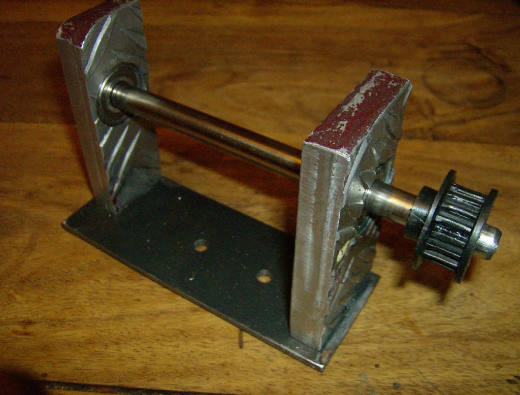

The countershaft itself, (photo 4) is really simple, although it needs to be rigid and accurately aligned to ensure reliability and long life. A steel base has two thick aluminium alloy end plates secured to it with countersunk screws; the end plates are bored for ball races in which runs a good sturdy shaft.
Photo 4: The simple countershaft
This assembly completely replaces the motor, having the toothed drive pulley fitted to the outboard end and a suitable pulley (or pulleys) for the drive from the motor in the middle. It is fixed in the same way as the motor (photo 5), allowing easy adjustment of tension in the toothed belt. Just remember to fit the belt before assembling the end plates to the base and fitting the countershaft to the lathe (don’t ask!)
Photo 5: Countershaft fitted in place of the motor
With one pulley fitted to the motor and the other to the countershaft, I was able to use the lathe. The first task was to make some multi-step pulleys. This gave me a six-speed drive, or twelve speeds with the 2:1 built in ‘back gear’. The motor was mounted on a hinged wooden plate to allow belt changing; a hefty weight on top of the motor maintained belt tension! I built a no-voltage switch arrangement, and fitted it inside the existing lathe control box.

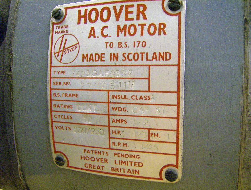

This arrangement was only meant as a stop-gap, but to my surprise I found it easy to use and did not miss variable speed – just the lack of a really low speed. Interestingly, I found that despite the nominal power of the old motor (photo 6) being nominally the same as the original DC motor, I found that in practice it was more powerful. I could not use all the power available, however, as the 1/4” plastic belting I had used slipped under power, unless the tension was increased to the point where the joint would fail after a few hours.
Photo 6: The Hoover motor's information plate
Despite these minor annoyances, by carefully remembering to drip a little oil in the cups each time I used the motor, it gave me good service without a single hiccough. There was one worrying moment – on the ME forum someone reported that an almost identical motor caught fire as the rubber insulation on the wires had perished. I checked my motor, and was relieved to discover that the wiring was PVC insulated and in sound condition. The mains lead had rubber insulation, still in good condition but I replaced it as a precaution.

As mentioned earlier, I found the round belting unsatisfactory when I needed to get a decent amount of power into the lathe. A normal v-belt would have worked better, but when I converted my milling machine to belt drive, I used a poly-v belt for simplicity, compactness and quiet running, and found it highly satisfactory on all three counts. As poly-v belts also have a reduced tendency to slip, compared to other types, one was the obvious choice for the new lathe drive. I used the same relatively light j-section belt for the lathe as the mill. I found it difficult to get detailed information on the power transmission capacity of poly-v belts, but through the ME forum I was able to obtain a data sheet and determine that a four-rib belt would be more than sufficient.
As the mini lathe has a built in ‘back gear’ – giving two speeds in about a 2:1 ratio, I decided that I would only need a single speed drive from the motor to the countershaft. This seemed to be the ample, although it would be a simple exercise to add a larger pulley to the countershaft to provide even more low-speed torque. I have never used the really high speeds available on the mini-lathe, so I decided on using equally sized pulleys. This gave me a speed range from a crawl up to just over 1800 rpm, with the inverter’s top frequency set to 65 Hz. Using the ‘low’ gear setting the range was up to 1000rpm, with the expected increase in torque.

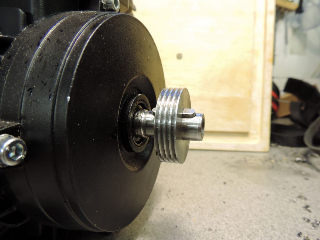

I made a pair of pulleys from a piece of 1 1/2” EN1A Pb, the commonly available free cutting mild steel, (photo 7). This was straightforward enough. As I explained in my milling machine conversion, all that is needed is a tool, like a screwcutting tool, but with a 40-degree point. Grooving the pulley is then just four plunging cuts, each 2.0mm deep and at 2.34mm centres.
Photo 7: The poly-v pulley fitted to the motor
The pulley for the countershaft needed to be 1/2” bore, which gave me an opportunity to try out a 1/2” machine reamer I picked up at a boot sale for about 50p – it seems to have finished the hole nicely. The Motor pulley needed a 14mm bore, too large for me to ream and my nearest smaller drill is 13mm, so I bored out the centre. Both pulleys needed keyways cutting in them so I used my ‘Stan Bray’ slotting tool[1]. This handy device uses a simple ram and lever arrangement to move an HSS toolbit back and forth in a bore. In the absence of a shaping machine, it is much less stressful than trying to cut a keyway by winding the saddle back and forth.

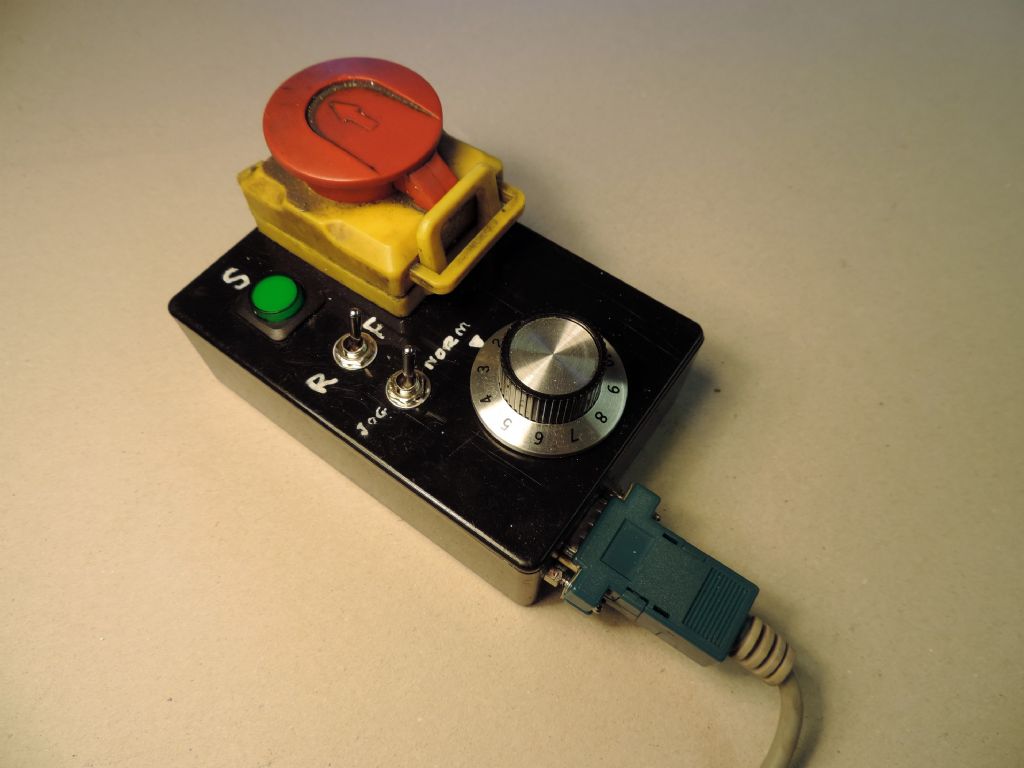

I used this arrangement, together with a homemade pendant (photo 8) for about six months, and found it quite satisfactory, but despite the success of this arrangement, I still felt it was a bit of a jury rig.
Photo 8: The simple pendant

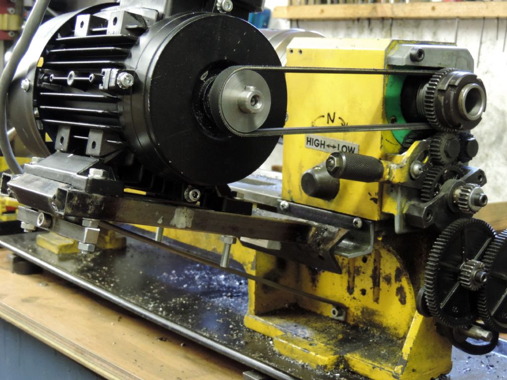

I wanted something that was a bit more professional. After considerable thought, I decided to change to direct drive to the spindle, and mounting the motor on the back of the lathe bed. In this new arrangement the motor is secured to a welded up frame from 19mm square steel tube pivoting on a bracket held in place using the screw holes for the old motor cover (photo 9). A steel bar, tensioned by a screw with a tommy bar, runs to the base of the lathe allowing the belt to be kept tight or loosened for pulley changes. I made a 1 3/4 inch poly-v pulley to fit on the back of the spindle (which meant cutting away much of the tumbler gear mounting plate – a cosmetic change). A 1 1/2 inch pulley on the motor gave me a top speed of about 1750 rpm. I discovered that this arrangement was a bit short on low end torque, so I fitted a two-step poly-v pulley to the motor to add a lower speed of 1200 rpm.
Photo 9: The new motor mounted on the back of the lathe

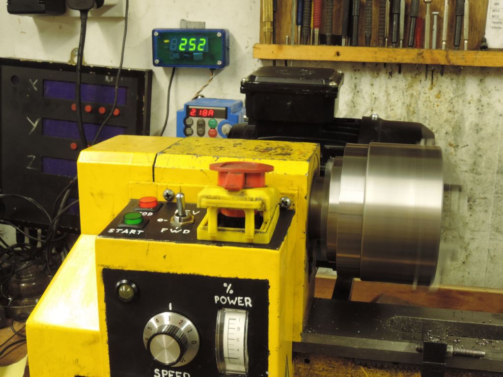

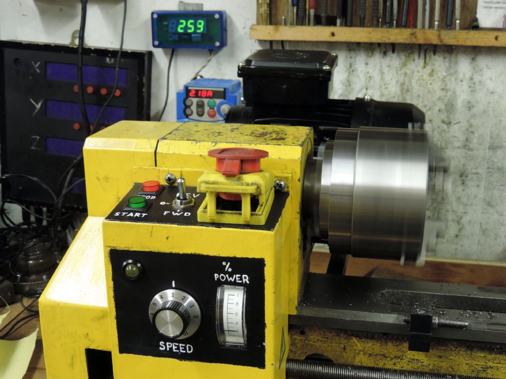

To complete the conversion, I dismantled my pendant and fitted a more sophisticated set of controls in the lathe’s original control box (photo 10).
Photo 10: The new control box
The programming for the inverter described below reflects this new arrangement. In brief, the controls are:
  • Emergency Stop - cuts all power to the motor immediately.
  • Stop – motor decelerates to a gentle stop.
  • Start – motor accelerates to speed.
  • FWD – OFF – REV – hopefully self explanatory!
  • Speed 0-10 – sets the frequency of the inverter and hence motor speed.
  • When speed is set at 0 the motor enters jog mode and can be advanced using the start button for tapping etc.
  • There are two indicators, a yellow LED showing the inverter is live and a power meter indicating 0-10, 5 is 100% of nominal power.
  • The inverter display is set to show current consumption, and a separate tachometer shows spindle speed.

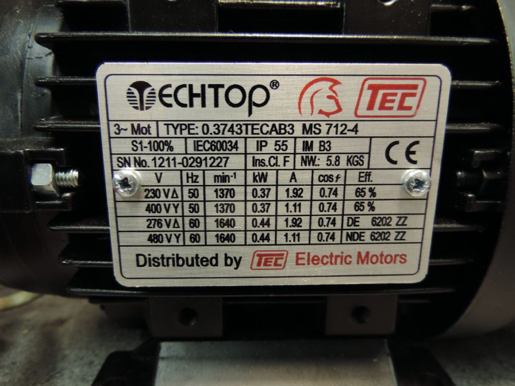

For those who would like to follow my example, I will give some detail of the motor and how I programmed the inverter. Please bear in mind that all this is unique to my setup, and you may need to make significant changes to suit other equipment.
The Motor
As mentioned earlier, the countershaft can be used with any type of motor and mine did sterling service with a 1/3HP Hoover single-phase motor and stepped pulleys. But I wanted the versatility of 3-phase variable frequency drive (VFD) and that meant a suitable 3-phase motor. Transwave recommended a TEC unit rated at 0.37Kw at 230V, 50Hz, delta configuration (photo 11).
Photo 11: Specification plate for the 3-phase motor
As is usual with modern motors this is somewhat smaller than the old Hoover motor. The terminal connections are rather more accessible on modern motors, being in a box on top of the unit (as supplied – the base can be rotated). The motor was supplied wired in Y configuration (for a standard 415V 3-phase supply), and needed to be rewired to delta to run off the 240V drive. This involves moving three short bus bars within the terminal box, following instructions on the motor. With the motor I received a metre of heavy four-core cable colour coded for the three phases and earth. I used crimped on connectors for reliability. I was very careful that there were no shorts between any of the phases or to earth, and that the earth connection was securely fixed to the frame of the motor.

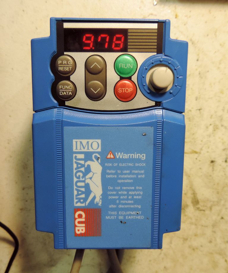

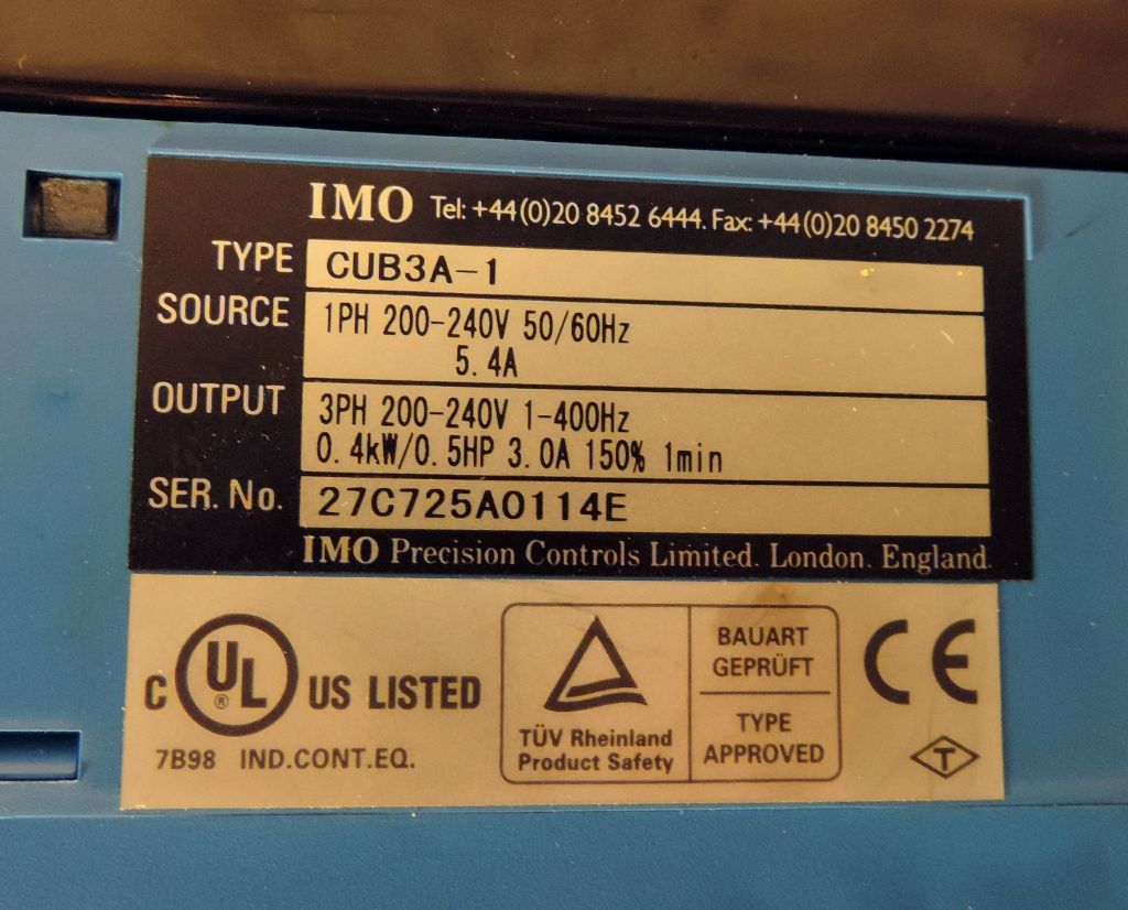

The inverter I was recommended is an IMO Jaguar CUB3A-1 (photo 12). This happily runs from a domestic single-phase supply and outputs 3-phase 200-240V with a rating of 0.4kW or 0.5HP (photo 13). The overload specification is 150% for 1 minute, this is handy as it means it’s not the end of the world if you start a cut too deeply, for example. One advantage of an inverter is that it will reduce its output and try to keep things going, rather than just cutting out if you overload it.
Photo 13: The inverter specification plate
These are not a step by step instructions to using an inverter, it is a resume of what I did to set up and use my inverter and is intended only as guide to what to expect and consider if you choose to do the same. Hopefully, it will make it a little easier to understand what the manual is telling you. The connections I have given below may not apply to your inverter, even if it is a similar model, so check everything with the manual before proceeding.

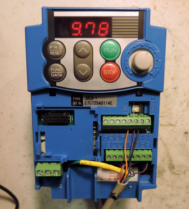

By gently prising off the main cover on the front of the inverter, I was able to slide up and off the ‘main circuit terminal block cover’. This revealed all the larger connections for the power supply and motor, as well as some advanced functions I did not use.
For the mains supply, I used an ordinary 13-amp plug on a heavyweight lead. It is important that this lead provides a secure earth connection, to which the inverter and the machinery are connected. There are two grounding terminals, marked ‘G’. These are used to connect the inverter to the mains earth, as well as to the frame of the motor, the enclosure and any other exposed metalwork. The line (live) and neutral from the mains supply I connected to the L1/L and L2/N terminals, respectively.
My inverter produces a 240V 3-phase output. This means the dual voltage 240V/450V motor had to be connected in delta mode as described earlier.
The output terminals are U, V and W and I connected these, together with earth, using the four-core cable I had attached to the motor. If the motor runs the wrong way, then two of the three motor supply connections should be swapped over. It is very important that the motor is earthed and that there is no way the supply or winding leads can short-circuit each other.
The terminals P1, P(+) and DB are used for a DC reactor and dynamic braking. These are used to provide braking, particularly of large motors, by attenuating the AC signal, or just shorting the motor coils. Believe me the inverter can stop small motors without such aid very effectively! The jumper bar between P1 and P1(+) must NOT be removed as we are not using such devices.
The terminals P(+) and N(-) are used for linking the high voltage DC supplies of several inverters, we will not be using these either. Don’t confuse the N(-) terminal with L2/N.
The power terminals should be connected using crimped on slotted-spade connectors, with insulated boots. This allows more than one wire to be safely and securely attached to some terminals, and helps prevent stray ‘whiskers’ of wire that could cause a short circuit. Like most people, I only have a very basic crimp tool but even this can be used to make secure crimps. The technique is to strip a short section of wire, as long as the tubular section of the crimp (5mm or 8mm). This is then threaded into the tube and the crimp closed using the notch in the crimp tool marked with the same colour as the connector. In principle, a sound crimp will actually create minute cold welds between the connector and the wire, and should be as secure as a soldered joint, but less liable to fatigue failure. Most crimping failures are due to insufficient force being used, so the welds do not form and the cable is not securely clamped.
Having made a nice neat job of these connections, I double checked them all, and replaced the main circuit terminal block cover. The mains supply could have been hard wired to a switched outlet, but I used an ordinary 13-amp plug. I would suggest the latter, for simplicity and flexibility, noting that the inverters rated demand is less than six amps from the supply.
I could now test the motor and inverter, using the controls on the front of the inverter. I had not changed any function codes, so RUN started the motor and STOP (believe it or not) stopped it. The speed ramped up and down gently over the default six seconds. You will notice that the readout does not show the motor speed, but the inverter frequency. The potentiometer should allow you to vary the output frequency, and hence the speed of the motor. Initially it was limited to 50.00 Hz maximum, but I soon changed this to gain a wider speed range, up to 65 Hz. Pressing the FUNC/DATA key while running switches the display between frequency, amps, volts and power.

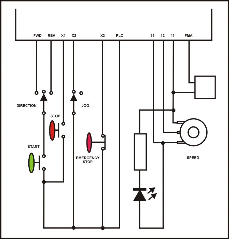

Wiring up the control circuitry
Photo 14: The inverter control connections
I wired up my own control circuitry, this allowed me to use additional features of the inverter (photo 14), note that I have now replaced the rather thin control wires with thicker ones. My wiring diagram is shown in figure 1, together with a basic parts list in Table 2. Be aware that it is, in some cases, possible to interchange normally closed and normally open switches, but you will have to change the parameters when programming the inverter.
Figure 1: Control box circuitry

The control circuitry runs off two separate power supplies. There is a 10 volt system used for the speed control and some output signals, and a 24 volt system used for the other control inputs.
The low voltage terminals used for the control circuitry use high-quality clamp terminals that can be used with bare ended wires, although if you can get very fine crimp ferrules you can use them.
Motor speed can be controlled with either a current or a voltage between 0 and 10V. A suitable control voltage is easy to arrange, using a linear potentiometer of between 1 and 5 kohms between 0v and 10V. Why the option to use a current? If you have along run of wire, as may be the case with remotely controlled machinery, a control voltage may drop considerably due to resistance of the wires. On the other hand, if a control current is put into a long wire loop, the same current will flow along the entire length of the loop regardless of its resistance. As I doubt I will be more than a couple of feet from the inverter, a voltage is much more convenient to use.
I wired analogue common (terminal 11) to the anti-clockwise end of the potentiometer track (so 0v is the ‘off’ setting). I connected the 10V potentiometer supply (terminal 13) to the clockwise end (so that 10V is full speed). Finally I took the voltage input (terminal 12) from the wiper of the pot. I will show how I programmed the inverter to enable this external potentiometer shortly.
The other control signals use the separate 24V system. The way I have arranged my system is as follows. 24V (PLC) runs to the normally closed (N/C) stop switch. From the other side of the switch one wire goes to X1, this is the stop signal.
Another wire runs from this side of the stop switch, through a N/O start switch, to the centre terminal of the FWD/REV changeover switch. This is wired to switch the 24V PLC signal between FWD and REV on the inverter. This arrangement is needed to stop the motor switching on again as soon as I release the stop switch.
The jog mode selector switch is simply an on/off toggle switch connected between X2 and PLC.
Emergency stop or limit switches can be connected between PLC and X3. If normally open switches are used, they should be wired in parallel. Normally closed switches should be wired in series. The inverter will need to be programmed appropriately (see later).

Photo 15: The lathe running under inverter power

The IMO Jaguar Cub inverter is a spectacularly complex device, with a more functions than you can shake a stick at! Most of these are so that it can control and monitor motors in a wide range of applications, from food mixers to fans, let alone machine tools. Others are tied up with industries need for quality control and process monitoring – for example reporting on the lifetimes of various components, or how long a cooling fan has been running. The mind boggles to think what ‘advanced’ inverters are capable of.
The basic needs of a model engineer are to be able to stop and start a motor, and control its direction and speed. This can be done very simply using the built in inverter controls. A little more effort allows the controls to be located on a remote pendant, or a machine mounted control panel, and for built in stop switches and brake switches to be wired in as well. More ambitious users will look at programming the display, or controlling indicators. The truly obsessed will go beyond this brief introduction and start playing with things like torque boost and thermal constants.
It is important to know, therefore, that the inverter comes with many of its functions programmed by default. One sold in the EU will typically assume that it will control a 50Hz motor, with the same rating as the inverter. This means that you can leave most of its settings well alone, and it will still do sensible things, like working out if your motor is likely to overheat.
