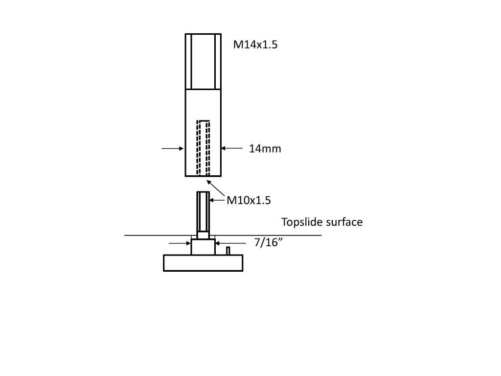

Has anyone fitted one of these to their Myfords who might have some advice before I splash-out please?
It looks as if "all" I need to do is to replace the Myford's 7/16 BSF toolpost bolt with an M14x1.25 one, but I am a bit reluctant to enlarge the hole in the top-slide to 14mm. Am I being too precious?
Is there a satisfactory way to keep the hole at 7/16 so that it can be returned to original and yet have a sturdy enough M14 thread above?
I thought about a shouldered stud coming through the topslide 7/16 hole with say a M8 threaded section which would screw into the M14 rod but obviously it'd need to be locked in some way to prevent it coming undone and would that ever be satisfactory really?

Clive Foster30/05/2014 10:24:14
3630 forum posts
128 photos
The whole point of the Myford design is to avoid a relatively weak and shallow thread in cast iron. It also spreads the loading somewhat reducing distortion tendencies.
Assuming you have a suitable tap and the lengths work correctly so the internal and external threads don't overlap the minimum change option would be a tube nut having an internal 7/16 thread to suit the Myford stud and external 14 mm thread for the QCTP. Ideal would be to have the tube going right down to the top-slide so that it locks up directly but that would probably need an unfeasibly long tap so an intervening spacer would be required. I'd silver solder a separate spacer to the nut to improve rigidity. Tube and spacer being a decently snug fit in the tool post.
If modifications to the slide are acceptable a good approach would be to copy Smart & Brown and use a steel top hat bush screwed to the base of the top-slide and finishing flush with the upper surface with a suitable internal thread for the pin of whatever size seems sensible. Standard 7/16 is probably as good as any. Proper shoulder on the stud so it screws down solidly onto the bush. Reverting to standard simply means changing the 14 mm - 7/16 stud for a 7/16 - 7/16 one.

Jon Gibbs30/05/2014 11:18:54
750 forum posts
Thanks for the suggestions.
Based on Clive's description I sketched this out - obviously not to scale. Would this work do you think?
I know that the Myford/Dickson QCTP and clones of it are always an option but does seem that it is compromised by the height of the standard 7/16" stud, isn't it?

Ketan Swali30/05/2014 13:41:37
1481 forum posts
149 photos
Hi Jon,
Unable to go into specifics...purely because I dont know...but speaking with several Myford owners over the years, it would seem that the Model 100 QCTP is simply too big for the Myford ML7, S7, even if you solve the stud problem.
In short, I would suggest that you consider the other options being presented here, based on the responses I have had over the years.
Unfortunately, we have not really gone down the road of suitability for use with Myford lathes.
Ketan at ARC.
Jon Gibbs30/05/2014 17:18:59
