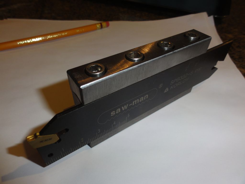

I've ordered a 32mm height, 2.4mm thick insert-carrying ``Sawman`` blade and matching 3mm inserts from Korloy. Given that this alone costs about as much as a Glanze blade complete with toolpost holder, I've gone about designing and making a blade holder for my Dickson QCTP while the blade is winging its way towards me.
The Korly toolholder is described as compatible with other 32mm blades, so presumably the design concept is very common. The blade has 15 degree chamfered faces at top and bottom, so the section is a highly elongated six-sided shape. The toolholder body and the clamp bar have matching 15 degree faces. When clamped, the blade is supported top and bottom along the whole length of the toolholder body.
The blade is available in a range of thicknesses (1.6 - 5.2mm) to suit inserts from 2mm to 6mm in width. It`s worth noting that due to the ``one size fits all`` toolholder concept, a 2.4mm blade is nearer 31.4mm height, not 32mm.
Korloy Sawman blade
I modelled the concept in 3D CAD using dimensions taken from my Bantam's Dickson QCTP and the published (minimal) information on the Korloy tool. I dimensioned my holder to take only the 2.4mm blade, thus avoiding unnecessary projection of the toolholder beyond the blade.

Woohoo! The postman finally arrived, bearing goodies.
Here's what I found when I assembled the blessed blade into the tool holder assembly:
Assembled
End view
Side view
End-on view
I think I can probably declare myself fairly happy with the result. Seems to have come out pretty close to what I modelled, despite having minimal info to go on. It could almost have been planned!

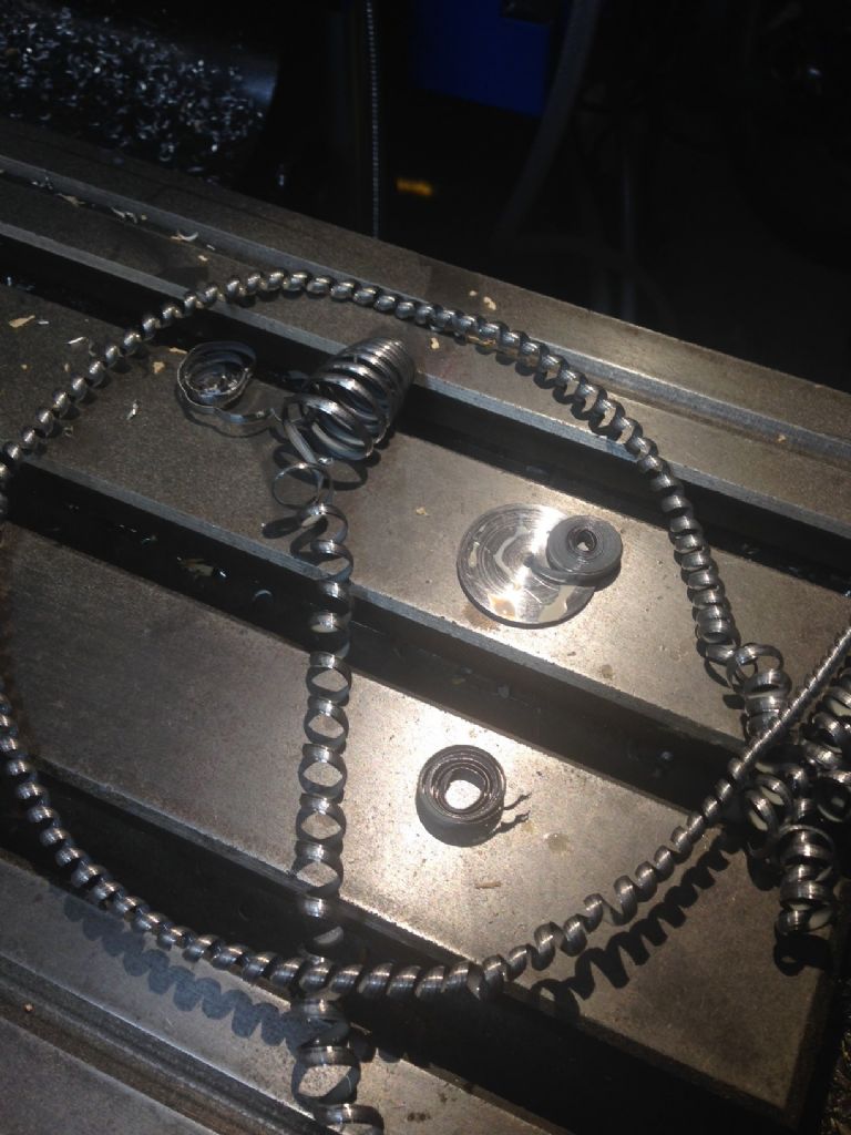

The moment of truth finally arrived, so I ventured out to the garage wearing my best rubber underpants. Who knew what could happen?
The first attempt wasn't entirely fulfilling. I pussyfooted about with what I calculated to be 2.3 thou per rev and about 400rpm with no coolant. I also discovered later that I was the best part of 10 thou below centre height. This resulted in several noisy but successful partings - but the surface finish was pretty nasty (little bits seemed to be welded to the bar surface) and there were some nasty grumbling noises going on. Not good. This didn't feel like the experience I'd been hoping for.
So after some researching and thinking and advice, I changed tactics. I checked everything was nicely nipped up, the tool was centred over the cross slide and a couple of thou above centre height and went for 5 thou per rev and 500rpm with flooded coolant, stopping half way in and upping the speed to 1000rpm (this was a 1" dia mild steel bar). Excellent result - no chatter or judder, nice clean surface finish, "approved" swarf and no nasty grumbling or snatching. Callooh, callay!
4 thou per rev, 500rpm
Finished at 5 thou per rev, 1000rpm
The swarf and the disk
The last photo shows a whole parting event in swarf. Started out as a long, tight spiral, then progressed to longer curls as the groove deepened, then ended up with a series of watch springs that were generated within the groove. A bit unnerving watching these build up before finally coming free but the swarf is narrower than the groove due to the design of the chip breaker so isn't likely(?!) to jam. I found the swarf to be typically about 7-8 thou narrower than the 3mm nominal tool insert.
Its probably a bit early to start believing this is the end of the story but it seems to vindicate the idea that you need to steel(!) yourself and go all in with the recommended feeds and speeds. In the interests of science and a more predictable outcome in future events, I should explore the limits of chatter-free operation. It seems that there are typically regions of instability where combinations of feed rate and cutting speed result in chatter. This will depend on my machine as well as the dimensions and material of the workpiece.

Here's a quick example of parting off with power feed just now:
**LINK**
After some experimentation which was thankfully free of rubber pants moments, I found that 300rpm and 5 thou per rev was a very safe condition. I could get up to 4-500rpm but that seemed to be the limit of unconditional stability tonight. Turning up the speed as the tool progressed sped up the overall process a bit but really made no big difference, so hardly worth the extra focus required.
Generally, speeds around and above 1000 rpm didn't seem to work consistently - once you go over the stability boundary you have to stop and bring the speed right down again.
Lovely clean finish and the swarf generation is so quiet and consistent it appears stationary (careful!). I expect I'd need to get the speed up over 1000rpm to get the swarf to break up, so that probably isn't about to happen.
I certainly couldn't produce this kind of consistency by hand.

Interesting results; seems to agree with my experience, a few hundred rpm and a decent feedrate (at least 4 thou/rev) works best. However, I've never got the swarf to come off in a long spiral, I normally get a series of small spirals or comma shapes for steel. Possibly my insert has a different design of chip curler.
I part off under power feed; if things are set up correctly there's no need to withdraw the tool to clear chips. A few months ago I was talking to a couple of professional machinists; one always parted off under power, and the other never did so, so it's really down to personal preference.
